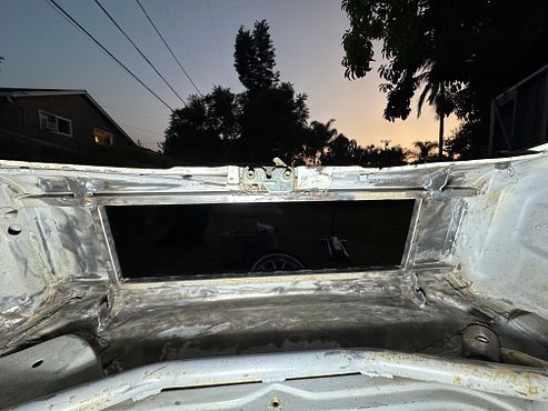

...... but back to the 911. Got the NOS Charlie bar installed. Nice to see some of the parts I have been collecting for the last 10+ years on the car!

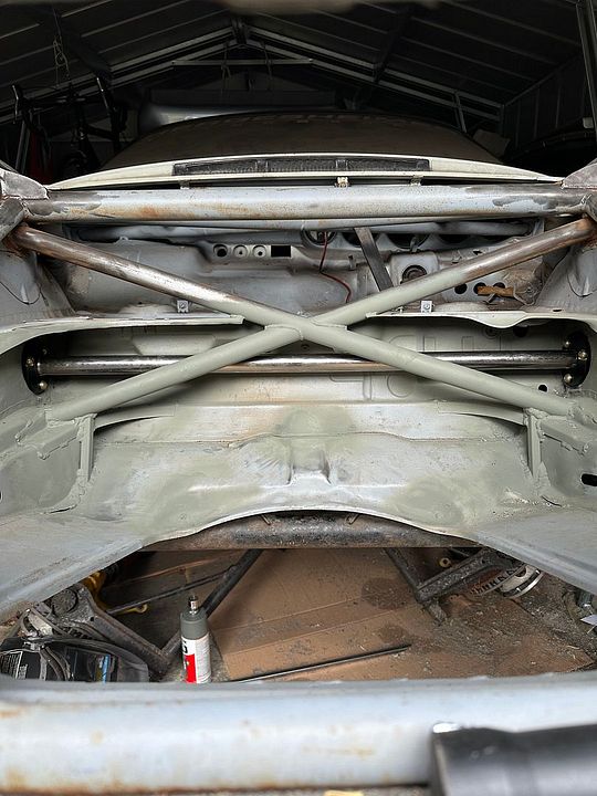

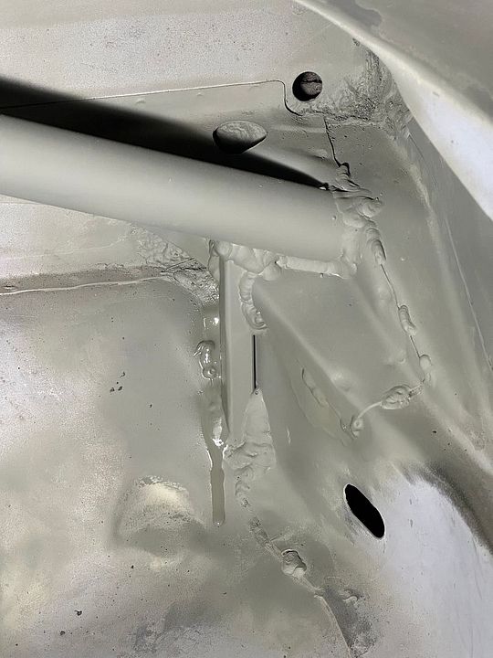

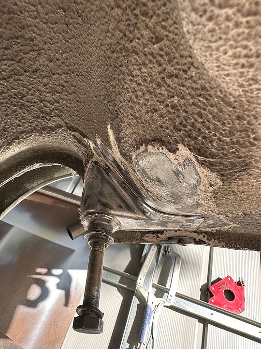

Started looking around at the front crossmember mounts...... always a dangerous thing and saw something that looked a little like a crack. So I took some more undercoating off to investigate and...... things escalated.
IMG_6039

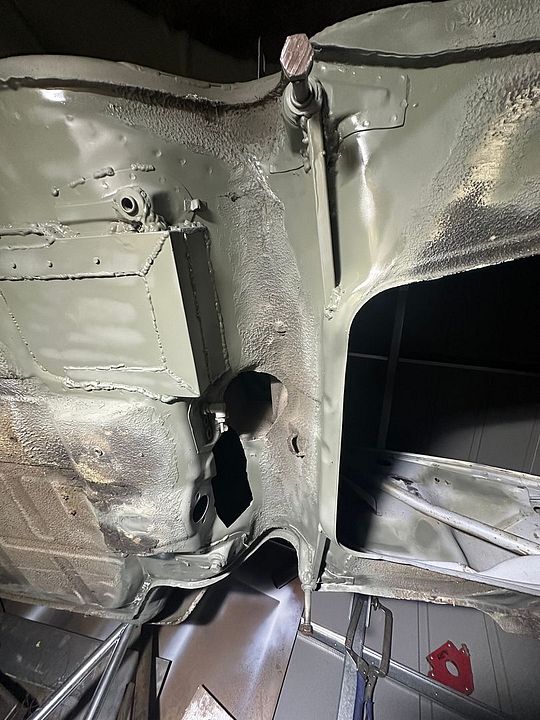

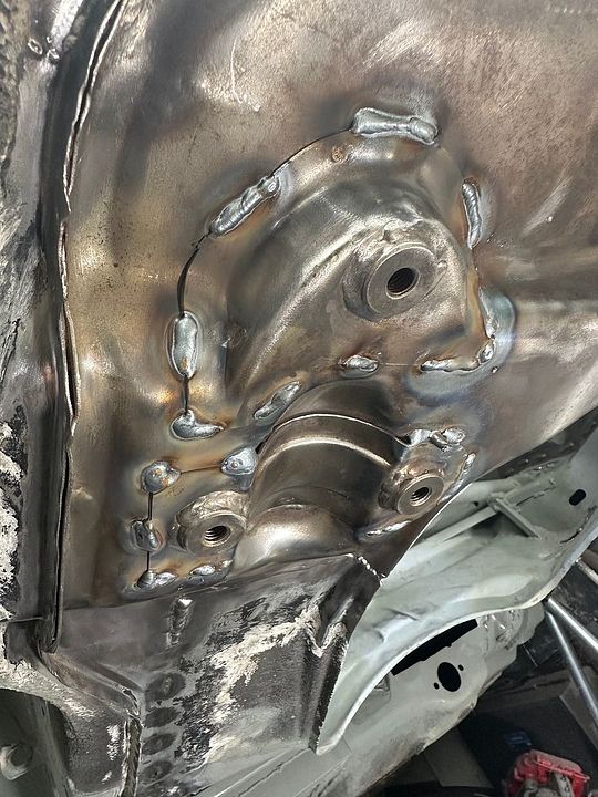

Ended up adding some reinforcement and tying things in a little better to the cage. This thing is a tank at this point but when this build started the idea was to build it strong enough to survive the Targa Newfoundland rally soooooo onwards and upwards!
IMG_6057
IMG_6058
IMG_6068
While I'm in there....... might as well seam weld a few more things.

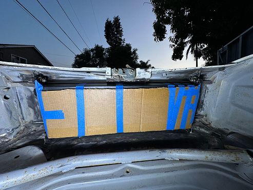

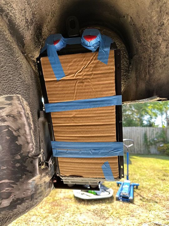

Then onto oil cooler mounting. I am deleting the on engine cooler to maximize head and cylinder cooling with a 226mm fan....... in goes a CSF fender cooler and a big Setrab in the center hole........ and of course, custom brackets for everything.
IMG_6089
IMG_6175
IMG_6174
Next up..... build all the ducting for the center cooler to vent it out the fender wells.

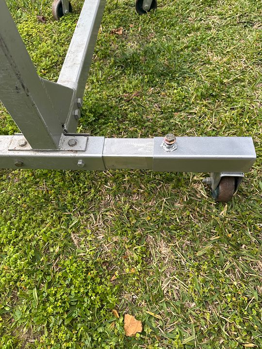

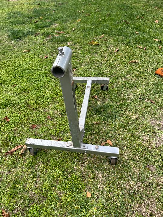

Speaking of bad ideas..... haven't gotten any work done on the car with the new house and job taking all my time but I have done a few things.
Had to modify my engine stand to make it telescopic. Used a piece of solid 2in aluminum bar stock to sleeve the leg.

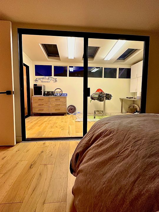

........ and all that to achieve peak bachelor status. Hopefully can get the motor torn down and the case and crank off to the machine shop before the year is over. Staring at it every night and morning should be good motivation.
IMG_6500
