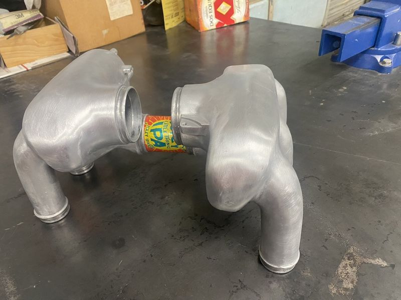

Hello Pelicans. Bumping this for any potential update from the OP or others who may have info on 3.6 intake with single throttle body / EFI conversion on 3.0L’s. ...Have an alum intake with all the trimmings heading my way for future conversion with Adapt Motorsports parts & pieces. Thx! Patrick

Keeping this thread going, here are a few pics of my Adapt Motorsport goodies. I’m obviously going with drive by wire EFI. I have their gas pedal kit and additional bits to round out the upcoming conversion. Everything has a nice finish, appear well made, and look nice in the box, lol! Hope it all goes well when I get to installation and tuning this Spring, Summer?
And here’s my 964 intake that’s been my winter project accompanied by several different hazy IPA’s!
