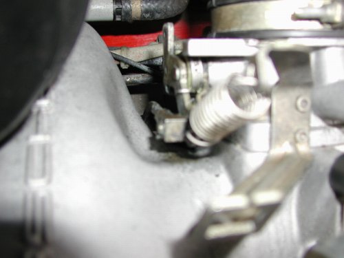

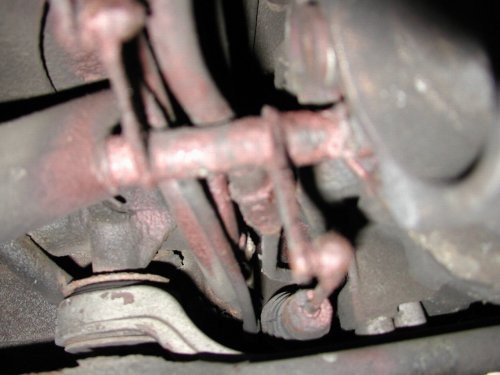

Hope these help - first one is linkage under car on side of gearbox (this is RHD car) second one is throttle as was before cleaning / lubricating
Hope this helps
Roy

Roy - Where do we make the adjustment to make sure that the throttle is openning completely in the first picture.
The second picture is where I have looked for means to adjust, but it basically raced the engine and did not seem to appear to be pulling the cable completely taught when the gas pedal was fully depressed.
Thanks for the pictures and info. I feel really dense about this one.

I made adjustments at the end where you can see the rubber bellows (goes to the pedal). Rubber bellow to bell crank is a threaded rod and ball joint - remove the clip and then the ball joint and turn whilst holding rod - you'll get some more throttle.
However, the greatest effect I got was by removing the circlip on the bell crank (after removing connections) removing it as far as I could (it caught on the suspension arm so I couldn't remove it fully), greasing and replacing - all the 'lost' motion came back and no sticking throttle!
Roy
