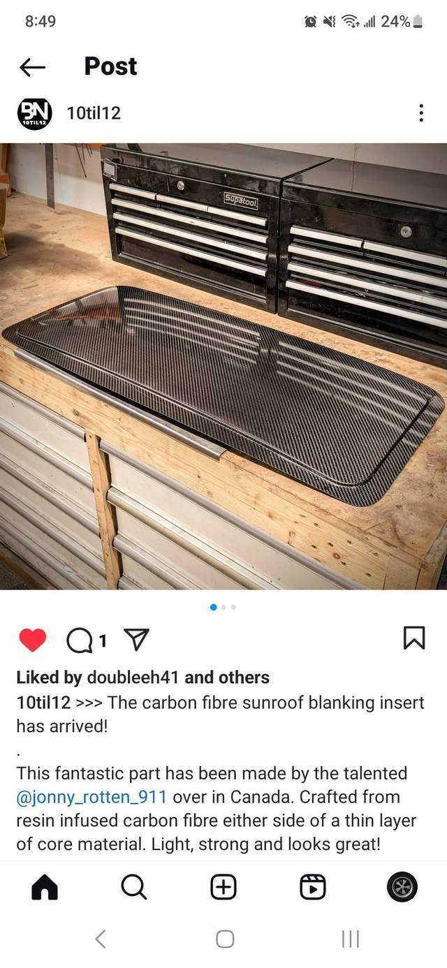

Trying not to geek out too much on the fact that my latest customer is Head of Engineering at the Alpine F1 Team...
He's in the middle of a really cool 911 project, and we've had many great conversations about various topics over the past few months:
https://www.instagram.com/10til12/
