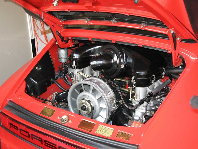

Does the charcoal canister still serve a purpose ?
I’m beginning to put things back after what has turned out to be a years long fuel tank replacement project.
Among those things to be put back together is the charcoal canister.
My car was originally MFI converted to carbs.
Does the charcoal canister still serve a purpose? Or, can I just dead head the hose connections?
What does (did) the charcoal canister do anyway?

If you haven’t blocked the vent hose at the tank (apx.12mm port, routes to exp. tank) then you won’t have the collapsing problem. But routing from expan tank thru the tunnel and to the char can, it then connects out from char can to the shroud. See if these two posts are any help….

It is an important part of venting the fuel tank, as well as reducing fumes and fuel evaporation.
The difference between factory and aftermarket comes into play here. Factory intake always has a housing that reduces intake noise and the vent hose can be routed to and contain the fumes.
Aftermarket tends to have a mostly open filtering element which would still allow fuel fumes to escape. When I had Webers on my car, I used the water shield housing and connected the vent hose to upper shield hole. It wasn't perfect at containing fumes, might have been more effective if I had brought it in the top of the cover.

Here is a decent one. Charcoal cannister is in the frunk, small expansion chamber under drivers side windshield cowel,
Evaporative tank in the drivers fender. behind headlight.
Connection from fan shroud to charcoal cannister, line back to air box.
Ed

What EFI setup is this? I like it -- clean and sort of period correct looking.
