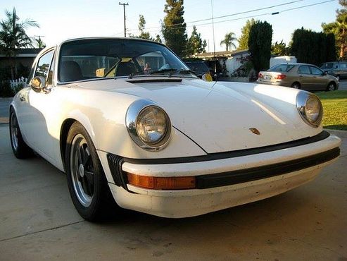

In with the '75. Knowing what I know now...... I should have just fixed the front suspension pan rust, bolted in a cage, done some exhaust upgrades and been driving it these past 10 years but there is no turning back now.
IMG_2464
I was running the 911 with POC doing Time Trials at the time..... and after the 993, stock seats, no cage and 3pt belts didn't seem like the greatest idea.
IMG_0003
The Pomona Fairplex Time Trial in 2011 was the last time I drove the car before taking it apart for what was supposed to be a quick cage instal and a few other "while your in there" improvements.
This "moment" was the final straw that I didn't want to drive it again without a cage.

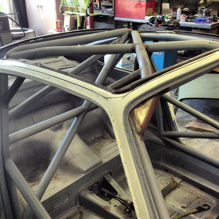

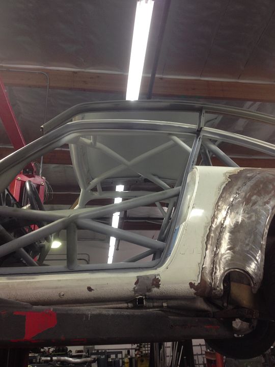

Josh at Lucas Fab in Huntington Beach did the cage fabrication.
I will be running coil-overs front and rear and coming from the 993 and being exposed to Cup cars...... chassis stiffness is one thing that is noticeably lacking in early cars. I have always liked the late 80's DTM cars and took that wholistic approach of doing almost a tube fame.
ScreenShot2014-08-05at85358PM
ScreenShot2014-08-05at85430PM
ScreenShot2014-08-05at85550PM
ScreenShot2014-08-05at85505PM
Driver side seat mounts were modified to accept 996/Boxster seat sliders which are very nice.
ScreenShot2014-08-05at85806PM
The cage ties into the front suspension mounting points with stub tubes welded to the 3 nut certs on the front mounting point while the front suspension pan was being replaced.
ScreenShot2014-08-05at85914PM
ScreenShot2014-08-05at90121PM
Hindsight being 20/20 I probably should have put in front camber boxes but now having mocked up all the new suspension, it looks like everything will work out fine.
ScreenShot2014-08-05at85857PM
ScreenShot2014-08-05at90038PM
ScreenShot2014-08-05at90231PM

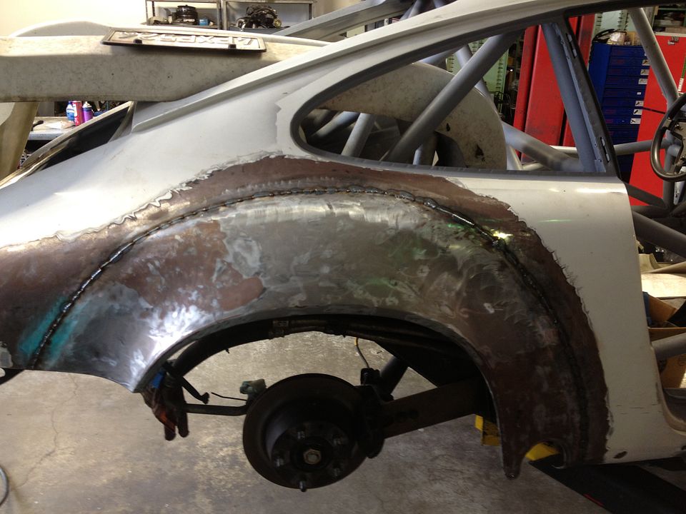

I was working with Tyson Schmidt at the time and he helped me weld on some Carrera fenders that came off of Cory M's race car when it went to 993 bodywork. I guess it was foreshadowing that they were off a G50 car.
5BB14FEE-1B45-4AFA-849B-C81CBEFAAE1F
ScreenShot2014-08-05at90142PM
ScreenShot2014-08-05at90158PM
IMG_0845
Again hindsight being 20/20, I should have made a serious attempt at fitting the Fenn Lane sunroof delete panel before the cage went in but in fitting it afterwards I couldn't get it to line up well enough that wouldn't require a lot of filling and sanding so I sourced a full non-sunroof donor section and after lots of prepping hauled the car up to John Esposito who unpeeled the rain gutter to install it with minimal welding.
IMG_1491
IMG_1497
ScreenShot2014-08-05at90322PM
ScreenShot2014-08-05at90418PM
ScreenShot2014-08-05at90344PM
ScreenShot2014-08-05at90433PM

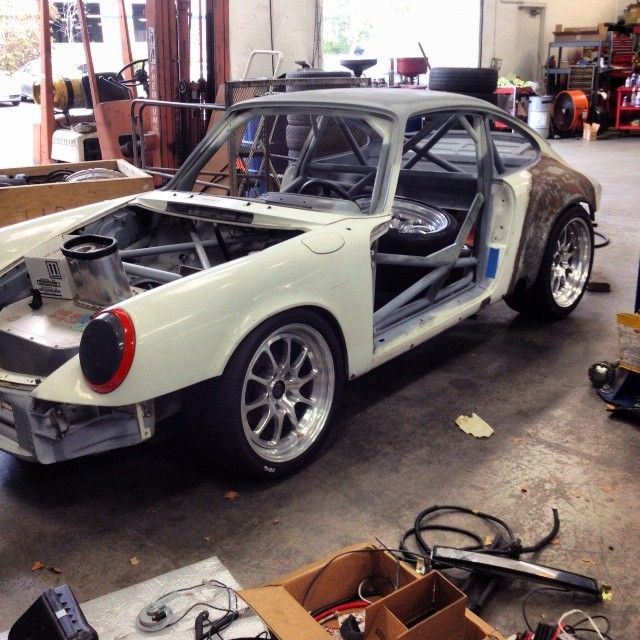

When the car came back from John's with a slick top, that's when the really time consuming and expensive ideas began to take shape.
35D76F38-DE15-443D-97EB-F07C6513E433
I got some big wheels.
wheels
and having broken the original 2.7L main shaft once with all 167 raging WHP and 205/50/15s.....
CC0C79DF-06BF-47BB-B871-3F7075169D5B
...........and enjoying being able to find 1st gear every time. Scope creep now included a G50 swap. Open diff standard G50-01 compared to a Mag Case 915 with a SC main shaft, Guard LSD, Aluminum side cover, WEVO spray bar and aluminum nose cone is a 35lb increase. Once the G50 has a LSD in it, and billet side cover, it will probably gain a few pounds so call it 40 heavier? This car isn't going to be a light weight.
01418D15-2C26-4261-A143-104BC3E6B7A6
The G50 torque to tube is an additional 7lb heavier before any sleeving of the joint so we are now up to ~50lbs gained...... the price of strength I guess...... not to mention an incredible amount of work.
F83AFE61-F22C-471B-AD07-EF1A6400CC38
and while we are at it, lets put in some camber boxes because big wheels and lower then euro ride height, the geometry starts to get less then ideal.
1B0FCA62-888D-4A58-9ABC-ADA285CD3974
but I am getting ahead of myself.

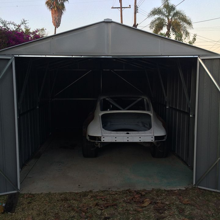

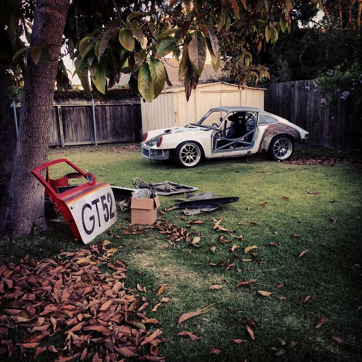

About this time I finished my Engineering degree and left the motorsports industry to move into the more conventional job market because benefits, 401Ks, and not traveling 20+ weekends a year starts sounding better as you get older. This led to having to find a new home for the 911 but fortunately I have understanding parents and the 911 went to their house and its own shed.
5618BC21-EB02-4C3B-9F9F-8DE29D78C366
IMG_3309
IMG_3311
And this is where the project sat for a few years while I helped my Dad restore an old derelict boat on the brink of sinking and sail it across the Pacific to Australia. Anyone else into Old Porsche and Sailing?
411809AF-6165-4A46-81B4-E18C0C6A2459

As with all great projects, it starts with tearing the car more apart and attacking it with an angle grinder.
These 275/35/18 do look pretty big off the car, maybe I should be a little concerned about the ripping off part.
48DB415C_6553_4E90_BB78_41926EE57125
Step 1, cut a gaping big hole in the back seats.
B69CD91E_6520_4C7B_8EF7_561B18FD9B83
and look at how much work you are willing to go though for a couple more inches.
0A8D4759-1E7F-4C7B-AD40-6A7367266F12
Step 2, CAD it up because no fabrication is professional grade without a little Cardboard Aided Design.
410C5916_9E32_4293_BD52_C99896D5DD77
Step 3, build a jig off the factory pickup points.
CF2063C9_D517_4804_8F06_943E19D834D1
Step 4, figure out the MIG welder has no gas flow and the welds look like bird dirt.
8F9BD8D9-F6F9-4DED-BFC3-D04373FA539A_1_201_a
Step 5, Rebuild MIG welder gas flow system.
Step 6, Weld some more...... still bird dirt but at least we are getting some penetration.
E15B7B66-62DE-4C0E-9C31-A6DA4C85FA84
Step 7, do a lot of measuring, say a little prayer and start cutting.
8952BAA5-5006-463E-892A-6F53145C6D86
Step 8, get some tubing to sleeve the inside of the joint with.
B7C7E0CC-E70D-4C05-93ED-596E4EA72681
Step 9, cut the new tube to fit the hole...... preferably centered.
4FBB9924-7830-4E83-85A3-58CB0B96C655
