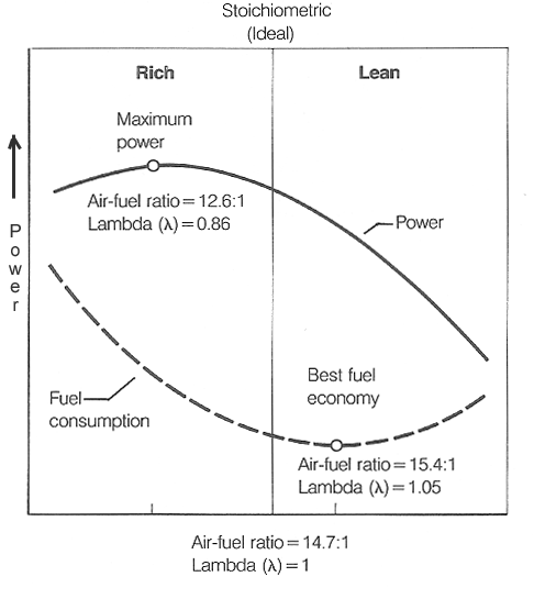

Gumba, the whole stock heat exchangers with a premuffler vs. SSIs has been debated many times. But since you are coming from a straight pipe, you should notice a difference just on the exhaust change. I never had experience with a straight pipe, but Bruce Anderson once told me straight pipes don't seem to do much for a 3.2 except create noise, but the European premuffler is an exception. Combined with a sport muffler, it has been dyno proven to produce about 11.5 hp at 6000 rpm. The premuffler is responsible for about 8 of that hp. SSIs are supposed to produce about 12 hp also. A few years ago I switched from a premuffler setup to a SSI/Monty combo and noticed no change in power. Needless to say I was disappointed in the $2000 spent. But it wasn't until I customized a chip to specifically address the fuel requirements of the SSIs did I notice the power increase. The problem stems from the fact that at full throttle, the DME injects only a fixed preprogrammed amount of fuel, determined by the full throttle fuel map in the chip, and no matter what modifications you do to your car, the DME will not adjust and add more fuel, and fuel=power. Matching your chip to your setup is always the best thing, and matching it to the SSI/sport muffler exhaust will only maximize the power potential your modifications are capable of producing.
The following image is a chart illustrating the variation of air/fuel ratios with respect to power. On this graph, it shows maximum power at an afr of 12.6:1, with max power on a 911 engine being somewhere between there and 13.0:1, which incidentally is where the engine is least likely to predetonate. You can see that slight variations in the afrs at that point have minor effects on the power delivered, however, as you get leaner, the dropoff in power starts to drop appreciably. So if for example, your stock chip was optimized for a stock car to deliver a 13.0:1 afr, but you increased your engine's breathing capacity by 10% with exhaust and/or engine modifications, your afr would now increase to (13.0 x 1.1) or 14.3:1, quite a bit off from the max power ratio, and increasing you motor's predisposition to knock. If we can minimize the motor's tendency to knock, we then have more margin to safely increase the ignition timing for even more power. If we increased the injected fuel by 10% we would then go back to the 13.0:1 afr [ 14.3 / (1 x 1.10) ]

Steve, what specifically do you mean by quality gas? I regulary purchase Chevron 91 - which is the highest I can get for California. Do you just mean to stay away from the middle and lower grades? I noticed a big difference in performance when I went from cheapo gas to techron alone.
Also, in regards to the K& N filter that I already have, but plan to put back on - would that help or deter from the performance? Can you compensate in the chip for the extra air flow? Thanks!

You can get the same results by a simple adjustment of the AFM without
wasting money on a chip and without the potential problem of pinging or
detonation. This can be done any time the exhaust system is changed
and the mixture needs to be adjusted.

Bill, the European Carreras which have a 10.3:1 compression ratio were designed to run on 98 RON/88MON octane fuel, which is equivalent to 93 octane at our pumps (our CLC average system). This contrasts to the US Carreras which has a CR of 9.5:1 and require a fuel quality of 87 CLC octane. Since we have lost our 92 octane fuel here in California, and all we can get is 91, putting in 89 or 87 will definitely decrease your performance, if not also be bad for the motor. A K&N filter replacement by itself will not do much to increase your airflow, though you could try cutting some large holes in your airbox cover, there seems to be some flow improvement on cone filters with adapters which funnel the air into the square opening of the air flow meter. The adapters generally start with a mouth of a larger surface area, and progressively taper down to the rectangular opening of the air flow meter, much like the intake stacks on the top of a set of Weber carbs, or like the intake runners on the new Carrera GT. Small mods like this are best if combined with other modifications.
