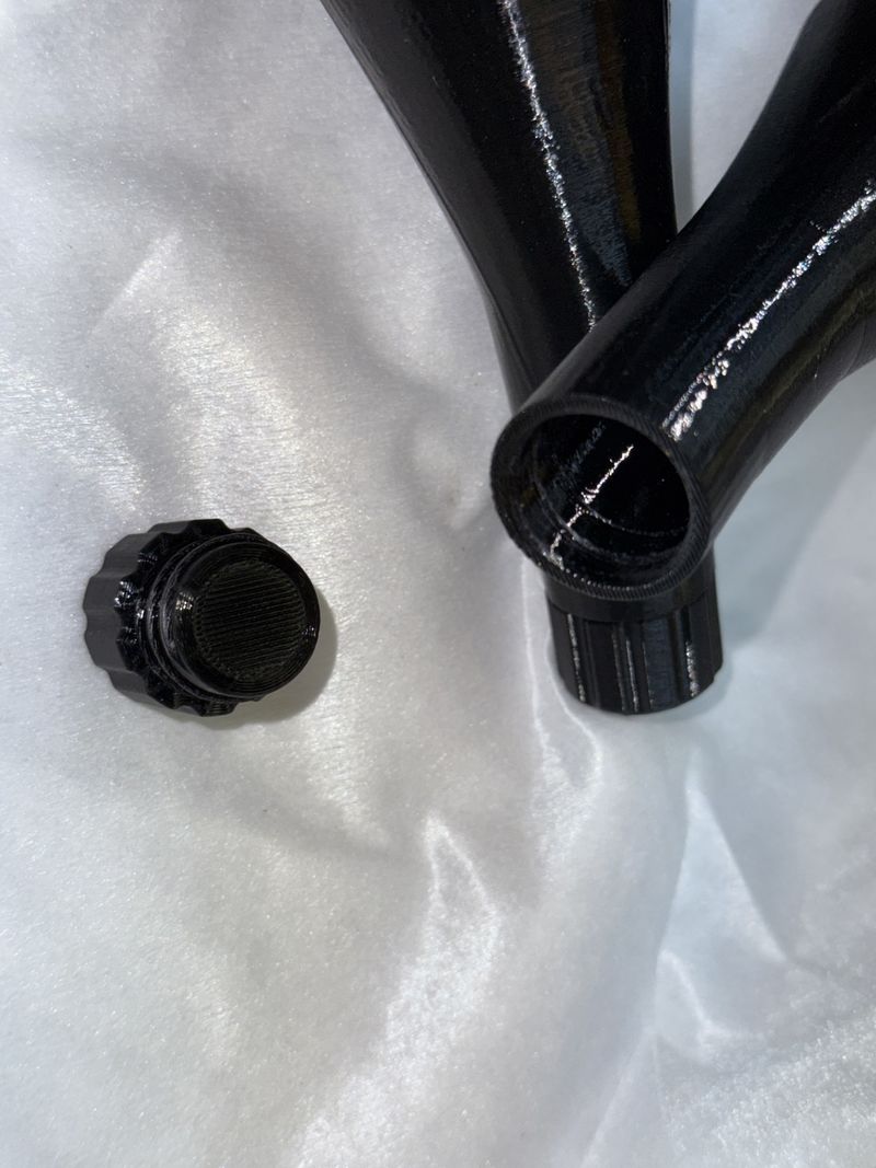

The red funnel was the prototype. We changed to black to look better. The protype did not have a screw cap on the bottom. The black one is the final design, and the cap screws into the inside of the funnel and looks and works great.
No more oil dribbling out of the funnel, or dirt getting in the funnel once you are done with it. Stuff a paper towel in the top, and you will have a nice clean funnel for next time. The funnel on the bottom, has the cap screwed in place. The top one I removed it to show the threads.

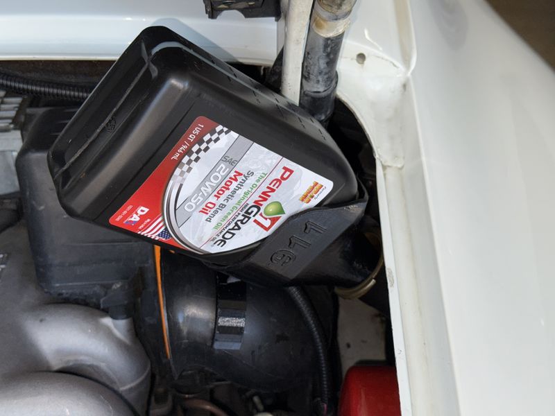

The saddle fits over the stock air intake, and it stays in place, even with a full bottle of oil. The tip of the funnel is about as big as will fit in the oil tank, with the dip stick removed.

If you have some other year 911, no it will not fit you car as the air filer is different. This is for a Carrera with the factory air filter housing and with a standard one quart oil bottle.
As it is a 3D printed plastic, I would be leery of using it on a HOT engine. I mostly wanted it for oil changes. Put in a quart, and let go of the bottle, and wait for all the oil to drain out. With the large tip, oil should flow out quickly.

That is a consideration. The problem is the 5 quart containers will never fit in the engine compartment. It would require some elaborate twisting to go from the oil tank, around the hinge and fender and then upright. I doubt it would steong enough to hold the container.
And even with the one quart funnel, I expect at first with 20-50 I will need to pour carefully, and then once the main amount of volume is in, then push the oil container into the funnel.
It does have a larger neck than the other funnels I have, but until my 911 burns another 1/2 quart, I can't test it in real word conditions.
The neck is just under an inch wide on my funnel.

Got my funnel yesterday and used it during my oil change today. It's a clever design that works really well and takes some of the tedium out of pouring in 10 separate oil containers. I'd recommend it to every Carrera owner.

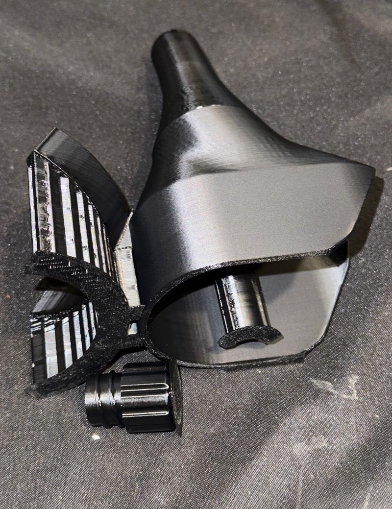

Just as an interesting fact of 3D printing, to make the funnels the printer requires some supports on the neck, and the part that hooks onto the air intake. The are somehow made with a lot of air in the support. The supports snap right off, and the inside of the neck where the cap screws on usually has some small debris specks. Those have to be removed with my finger. The cap itself has some supports around the 911 text. And if you look at the top of the second photo, the support for the 911 text on the side of the funnel. I have one with my initials on it, just because.
It take about 6 hours to print one funnel.
It is fascinating to see the printer working. From a digital file designed in Solidworks to a physical funnel. The design part is the hardest part. I figured the folks on the board that have never printed anything in 3D might want to know.
