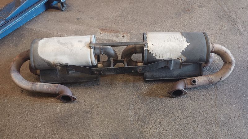

some other designs
Found Fabspeed internals, bothe sides dump into a central cavity w/ angled ends
Some Burns implementations
964 RS/LW
Bill Verburg

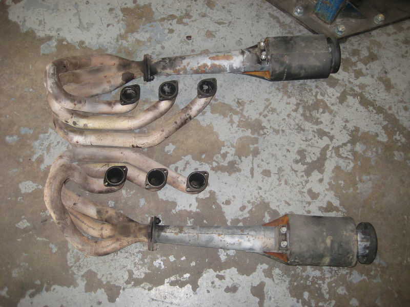

A few more
SC/RS rally
Singer
Again I always liked these

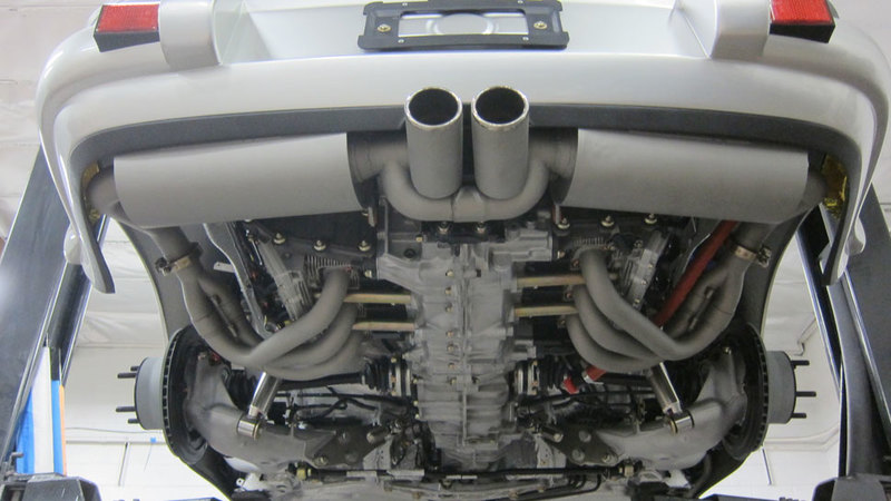

I made something simple when I installed my 3.6 engine.
A few 90 degree bends and 4 cheap small simple straight thru mufflers.
Its not loud and according to the dyno its not a disaster.
Please don't look at the welds! But they have held up.
Magnus

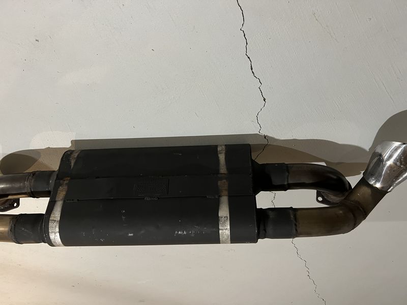

Does the bottom one have some kind of mechanical valve?
yes, you can see the tool insertion points to manually turn the valves
Do you have any sound clips? Video?
Nah, nothing good. It sounds deep, not sharp at all. I manage 95db flyby on trackdays.
Only some crappy in car audio from track days.
https://www.youtube.com/watch?v=sMmwq6w8mwU

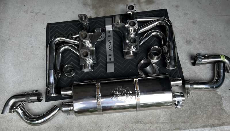

Originally Posted by David View Post
Lots of good ideas here but the problem statement is to have IROC RSR spacing on the rear outlets which severely limits the options.
I could not find the Fabspeed muffler on their website that Bill likes but I have emailed them to check if it's still available. I would like to find out the overall length of the muffler to see how it fits.
Here's my final design if Jay's onboard. It would allow coming back and installing a larger 22" long muffler if it's too loud and if a larger muffler is found or fabricated:
This type has the RSR outlet spacing, all you need to do is modify the inlets and if too loud open it up to add f/g packing

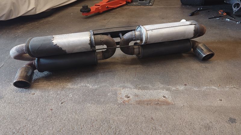

That last drawing is very similar externally to what many of us had from Fabspeed, Borla etc.
This is my old Fabspeed
Bill Verburg

I spoke with someone named Andrew at Fabspeed. He told me they discontinued the exhaust Bill likes in favor of their x-pipe design. He said it was both quieter and better on the dyno.
He did tell me he would check if they had any stock left of Bill's type muffler and was supposed to send me dimensions and/or drawings. So far I have only received photos of what it looks like installed from him. I'll update the thread if I hear back.
