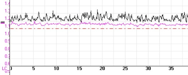

10 mpg smoking gun
Below are comparison logs for my engine running in its 10 mpg mode, then with an adjustment made to the operating system. Bear in mind this is a 3.2 / Motronic.
Warm idle:
10 mpg engine.
Adjusted engine.
City:
10 mpg engine.
Adjusted engine.
Steady throttle in 4th gear holding 3,000 rpm:
10 mpg engine.
Adjusted engine.
Adjustment to the engine was a loaner ECU swapped in for my ECU. To confirm what is revealed by these logs, mpg city was test run with the loaner ECU. Result: 18 mpg.

This is the connection between the controller and the O2 extension cable working when it wants to. I looked at these connector ends—when Innovate’s product first arrived and immediately after the shipping box was opened. And did so under magnification. Male pins and female receivers, all are poorly made to my eye. There’s also poor alignment of the pins to the extent that these connectors would not mate. This was corrected by adjusting the pins and slightly nudging them into proper alignment, under magnification. We’re talking fractions of a mm. Only after this adjustment would the connectors seat to each other. There’s a fellow on YTube who forced these connectors together and regretted it. I learned from him what not to do. And so the inspection when NEW product first arrived.
Last straw
At this point, with Systems Consulting’s ECU installed and city mpg what it should be + engine performance stellar across the board… I want to end-stamp the 10 mpg fuel consumption saga with a few final logs. This, for my car’s reference file, also to share with those who, on PPF, provided input and the motivation to keep the project moving forward. And…
glitch.
In these last two logs below, engine’s 1-2-3 side is magenta. 4-5-6 is black.
Problem here is traced to the controller’s daisy chain. This was found by swapping controllers in their chained sequence. For the log above, engine’s 1-2-3 bank controller is nearest the laptop in the chain. 4-5-6 is farthest in the chain. For the log below, 1-2-3 controller has been moved and is now farthest from the laptop, 4-5-6 controller is nearest the laptop. Tracelines following the position of their respective controller in the daisy chain... where this issue is known. Exactly what the problem is is unknown.
Return the controllers to their original positions in the chain and the tracelines also return to their original positions. Confirmation. Buy another patch cable from Innovate? Not happening. Dump the patch cable and connect the controllers directly? Done. Didn’t work. This issue seems internal to one or possibly both of the controllers. Buy another controller or two to see what happens? Also not happening.

If you or anyone knows of wideband hardware that there's streaming data software for, be good to know what that option is.
Wow. Karl, as usual you have a through report. The good news is you have a car with normal mileage after some very extensive and expensive fact finding.
Glen... Appreciate that. Is very nice to pull up to a fuel pump and NOT be running a 10 mpg ECU!

Hello Karl,
greets to the sunny state!
I’ve done many tests with the LC-2 device from Innovate.
There are two points where I’d like to hear your opinion and/or results:
Problem #1 – Wideband Output vs. Lambda 1.0
With the factory default wideband output settings from Innovate, Lambda 0.5 is specified at 0 V and Lambda 1.523 at 5 V. Accordingly, 2.45 V should equal Lambda 1.0. If an original Innovate gauge is connected, it indeed shows “AFR 14.7:1” at 2.45 V – which seems correct at first glance.
However, in practice 2.45 V does not correspond to Lambda 1.0. Using an officially calibrated test device, I consistently read lower values around Lambda 0.95 at 2.45 V. All wiring and grounding were verified per Innovate’s recommendations.
Even Innovate’s own LogWorks software shows this offset: about Lambda 0.95 at 2.45 V.
With the LC-2’s simulated narrowband output, however, everything looks correct (0.5 V = Lambda 1.0). So: wiring is fine, sensor is fine – but either the controller outputs an incorrect wideband voltage at Lambda 1.0, or the published transfer values (0 V = 0.5 λ, 5 V = 1.523 λ) are simply wrong.
In my DigiECU (for 911 SC lambda-controlled engines – see link in my signature), I can compensate this via a software factor: dividing the wideband voltage reading by 0.95 gives me exactly Lambda 1.0 – but now at 2.58 V, not 2.45 V. This result matches both Innovate’s LogWorks and independent official emission test equipment.
Problem #2 – AFR Display vs. Ethanol Content
The Innovate gauge shows “14.7:1” at 2.45 V (assuming Lambda 1.0). But as described above, that is not truly Lambda 1.0.
In addition, even if the controller were exact, the AFR value of 14.7:1 is only valid for ethanol-free gasoline. With E5 fuel (≈5% ethanol), the stoichiometric AFR is different. The gauge cannot know the actual ethanol content, so at Lambda 1.0 it will always show 14.7:1, even though the real AFR is not 14.7:1.

Just to add a (tiny) data point from my own experience: I purchased a brand-new Innovate AFR meter kit when I went to EFI. The sensor burned out a month after it went into use, in spite of always being powered up when installed and used on a running engine. As it happens, that sensor crapped out the day I had booked dyno time.
My dyno guy had new AEM meters and new sensors in stock. I installed those, and ran for several years before needing a sensor again.
No more Innovate products for me either.

I'm with you here, since AFR simply can't be directly measured. What a lambda sensor actually detects is the remaining oxygen in the exhaust gas. From the lambda value, one can calculate or assume the air–fuel ratio before combustion.
However, regarding your answer ... even if you select "lambda" readings with the LC-2 device, using the default Innovate voltage settings mentioned above – where 2.45 V should correspond to Lambda 1 – the displayed lambda reading actually will result wrong. In reality, with the factory default settings, a voltage of 2.58 V corresponds to Lambda 1.

Andrew... thanks for the sunny mention From my Innovate experience, I'm not surprised with ANY anomaly that ANY user now makes note of, you now included. Quality is not in the hardware as I received it. Apparently not yours either.
In LogWorks, there is the option to view data as either AFR or Lambda and to select a fuel type. I made these selections choosing Lambda and gasoline. I vaguely recall voltage options but I made no selection in this regard as I concluded there being no need.
I do understand what you are saying about the voltage and what may come of this if they are not working correctly.
Given what I saw when my LC-2 system was generating good data, and based on my tested mpg results---both bad mpg and finally good mpg---my Lambda readings corresponded to the engine's fuel use as I saw it. In other words, I believed the Lambda values were correct. If my system was currently working, I'd check the voltages to compare notes with you. I think you know I'm done with Innovate.
