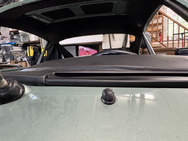

Hi all,
I have a '75 911 I've been restoring for over a decade (YIKES), I know the dash is supposed to go in before the windshield. However the installer is telling me he can't get the windshield in with the dash in place.
A bit of backstory: I recovered my original dash with vinyl purchased from our host. It came out great, but did add thickness top and bottom of the dash.,
Sooo - anyone know if it's possible to get the dash in after the windshield? I know I won't get the screws in place at the front of the dash, however the clips seem to hold it securely without those screws.

Got a pic? The only problem I could foresee is if you wrapped the vinyl over the metal lip
Old 09-05-2025, 09:32 AM
Join Date: Oct 2002
Location: Bolton, MA
Posts: 761
Here are a couple of pics. I think the issue they had was that the gasket was hitting the dash - or maybe the glass. I'll check with them on that.

It is impossible to install the dash CORRECTLY with the front glass in. There are screws that hold the front vinyl down as well as the way the dash snaps into the TOP of the metal underneath requires clearance.
Yes you can shove it in later, but that's not the right way.
In my opinion, your installer is not the right installer. The front windshield can be a 10/10 difficulty in getting it perfect and requires someone who knows how to do it.
You need to use a really nice seal, I recommend the Porsche seal.
The trim needs to be the right shape and installed on the bench and seated properly. If it was bent during disassembly, you can reform it carefully with the glass close to being in. If the corners are wrong, it will pop out of the seal and I will notice it at the next car show. :-D
Thin strong clothesline must be roped into the seal and crossed over at the bottom.
The bottom must be placed onto the metal lip with the window nearly verticle so that it seats the inner middle edge properly.
While a second person firmly presses against the area, you pull the rope starting at the bottom in the corresponding area, making sure to do it evenly on both sides.
If at any point the trim pops out or the rope does not correctly pull the seal over the metal lip, you must restart completely.
Copious amounts of liquid soap to lube everything up as you work.
Your dash looks a bit high, but I can't tell for sure. Are the front screws in? When you press on the middle is there give? It should be solid if it's butted up to the metal underneath.
Don't overtighten the bolts that hold it on, they will snap the studs off the dash.
Mike's restoration on youtube has a nice windshield tutorial .

Your glass installer is wrong. Always install dashboard first. Often when pulling the lower cord you have to use a small wood paddle to help direct the cord.
I would strongly suggest you find an experienced 911 glass installer. Rookies often fail to properly shape the metal trim, leaving gaps in the upper corners. Then they blame the seal.

I can't seem to find a good installer in my area, this guy came recommended from another Pelican member - very nice guy and really tried but it doesn't seem like he's ever done a Porsche glass install.
The dash is fully tight to the Sheetmetal, screws are in place, no play when I press down on the dash. I think it's a bit higher because of the thickness of the new vinyl. As a last resort I'll cough up the $1400 for a new dash from Porsche - really trying to avoid that!!
I'll try it this weekend myself. I've done everything else myself, I can probably do this.
The gaskets (front and rear) are the factory gaskets from our host. Hopefully there isn't anything wrong with them. The installers did do a nice job of mounting the gaskets and aluminum trim to the glass - seems to be fully seated. There is no visible distortion in the gaskets as they sit mounted on the glass.
I'll follow your instructions myself tomorrow. I'll let y'all know how I make out.
