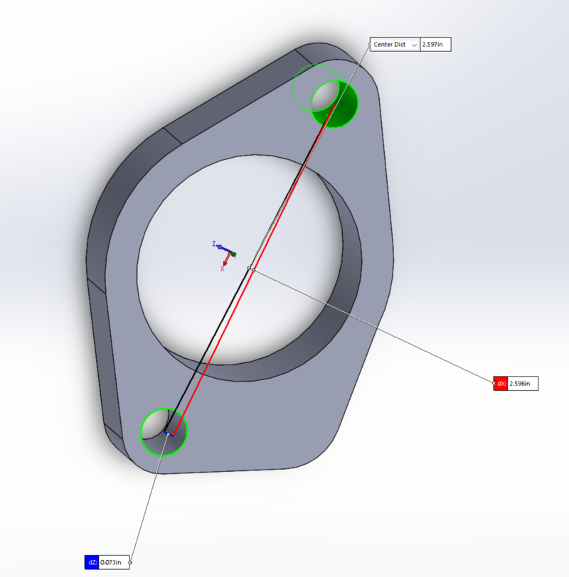

You ever find this out?
I wanted to verify my measurements with others before I pull the trigger on machining my parts.

You have vernier calipers or a ruler? To determine the center-to-center space, measure the outer dimension from stud to stud, then subtract the OD of one stud from that measurement......
...... or take an intake gasket, trace it on some paper, then measure those dimensions. The cover you fabricate along with used gaskets and gasket sealer should do the job.

I got 66 mm +/- 0.5 (center to center) from my 78 SC engines.

Yes 66 mm (79mm -13mm = 66mm), measured on a large port 1978 3.0 SC engine

I got 2.597" from my crappy Harbor Freight calipers that fluctuate 0.005".
Looks like I was only 0.001" from being accurate.
Not too bad!
