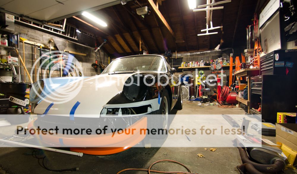

Does anyone have pictures showing their solution for mounting fiberglass front or rear bumpers? If possible, I'm curious to see how you went about fabbing brackets that bolt into the old bumper shock mounts.
Thanks!
This is what I did on my wide body backdate in the front, simple and easy on and off, just one bolt on each bumper end and the 2 on each mount. When I have the front fenders prepped I'll start the back and post pics of that.
Pardon my ignorance, how is it held on? just washer tightened against the slots? I've seen people run these on track cars to easily remove the bumpers during loading/unloading for really low cars:
The 4 bolts with washers yes on the bumper mount, but 1 more bolt at the end of the bumper, going thru the fender and bumper on the inside.
