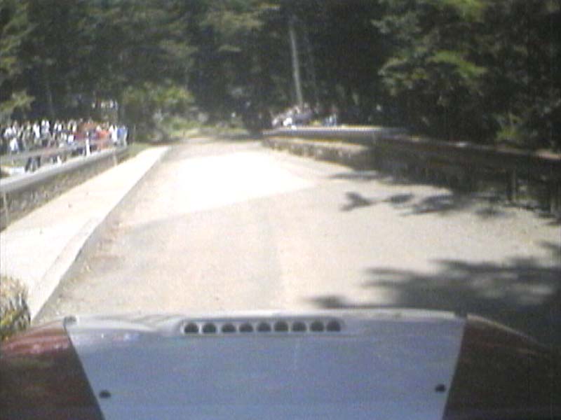

To get a good perception of speed, you need a wider angle lens--at least 100°. Get a lipstick camera. www.supercircuits.com has them for <$200. I use this one with this lens. Use the camcorder in VCR mode to record. While you're at Supercircuits, get a couple of their PA3 line-level microphones and stick 'em in the engine compartment. In VCR mode, a camcorder is looking for line level audio, so you need the special microphones.
Here's a vid cap:
993 · 911 · STI · S4 · rally car

Very funny! Don't forget to have two guys carrying a large sheet of glass right before you arrive. Rarly, The prior post was correct in that the lower the camera, the higher the sense of speed. I've seen lipstick cameras mounted to bumpers that are impressive. T

Camera shake makes everything look faster.
