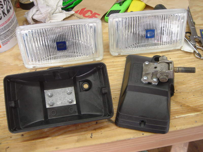

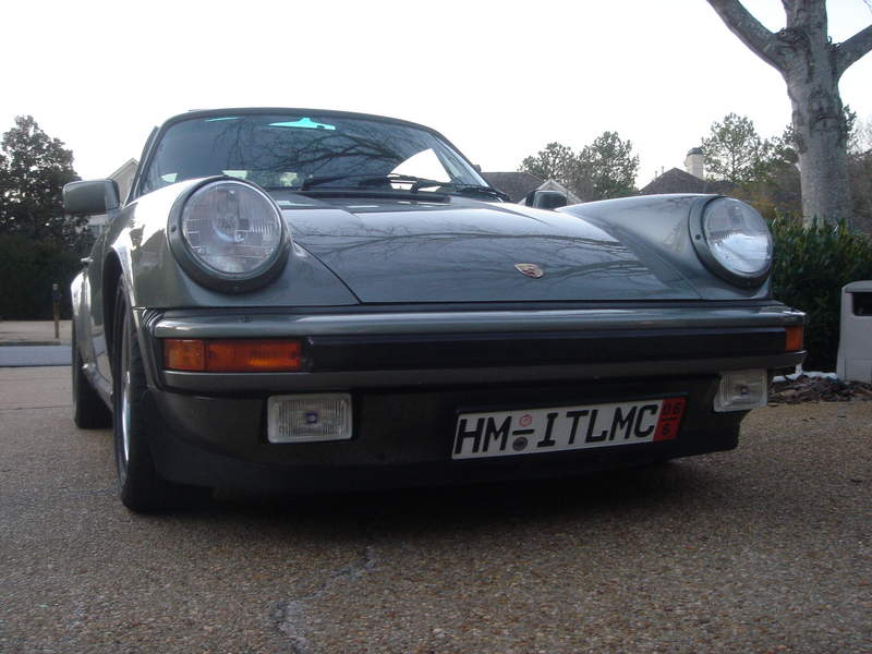

Zoanas, thanks for blazing the trail on this - the factory fogs are indeed dismal. I picked up a pair of Hella 450's on eBay for $26.00 and completed the install yesterday. Very nice complement to the so so factory headlights (H5s I think in 1987). While improved with the recent addition of the Sucro relay kit and SilverStar 9004's more is needed. (H4's not in the budget right now).
Still working on my alignment. Right now, they are aimed well below the headlights (probably too low). UPDATE: Just figured out that mine are the "fog light" version not the "driving light" version of the 450's.....so the light pattern will be low - and they are street legal (not that that matters)
I retrofitted the factory mounting brackets to the back of the Hella housings using 1/4" nuts as spacers to bring them out a little and used nylocks vs rivets so I can adjust further if necessary. Looks like you mounted yours with the cutoff up. I left the 1/4" hole open (that you get after cutting off the plastic mount) and mounted it down to function as a drain as the factory housings also have a drain hole.

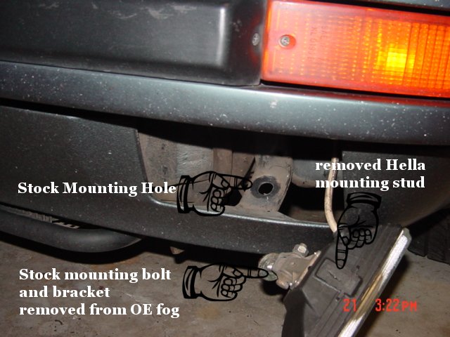

I haven't had any shakng problem at all, but that may be due to the modification I did to use the stock mounting bracket. I had to cut off the Hella molded bracket on the back of the housing and rivet the stock bracket to it. Then I just mounted them the way the stock fogs mount. There was enough slop in the mounting that alignment wasn't a problem. These lights are actually designed to be used much higher off the ground, so they will always seem too low, but they really are sufficient for my night commute. I've managed to avoid several varmints that I otherwise would have scraped off my valance.

OK, here are some follow-up pics. Took a couple in the dark with no flash showing difference with driving lights off and on....the pics are much darker than real life but do show the relative difference.
Low Beams
Low Beams + Hella Fog Lights
Drain hole exposed

ros:
Ahh.... simply back up on this thread..and look at Zoanas' pics posted on 2-21-04 at 7:52. Quite clearly it's mounted on the valance "rib" in the foglight hole.
- Wil

Here is the pic Wil is referring to:
