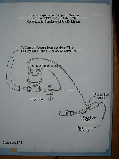

With the turbo, you want to run open loop (disconnected) under boost and closed loop when not under boost.
Here is how:

Tsuter, I have the BAE manual and have the lambda system configured exactly as pictured, but don't run with the O2 sensor disconnected. Is that what you mean by open loop? The only difference is the BAE manual calls for the hobbs switch to close at 1.5 psig, mine is set at 3 psig rising.
A couple of years ago I ran without the O2 sensor when it was bad, the only reason I replaced it and hooked it back up because it gives better fuel mileage and better metering under certain conditions and it helped me a pass smog test . Right now I am just about ready to disconnect it and tune it manually like I did back then. I hate to give up and admit I can't make it run as designed, call me a stubborn SOB.
