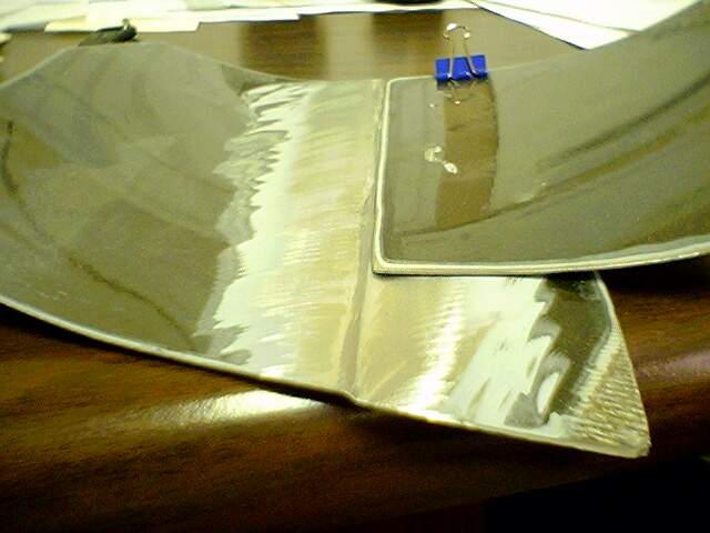

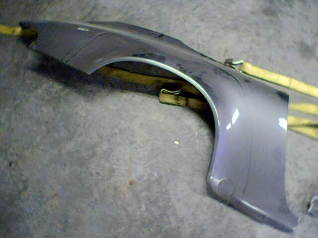

Started laying out parts yesterday for the 912-6 flair job. Gonna be a shame to cut up the great sc fenders I got just for the flares. Gonna use the 3m panel adhesive to bond them on. Was wondering, should I make some sort of flange tool so the new flare will sit more flush with the old metal? That way I won't have such a big level difference and will use less filler.
My pretty sc fenders.

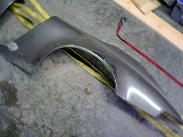

The soon to be extended 912-6. Can you say, I need 9x17 race rubber.

Prob with the flanging pliers is I need to have about a 2" flange. I do have one of those flange rollers I got from harbor freight that has about a 12" throat, thought I migh try to have a helper hold it up while we turn the handle.

Standard flanging tools are for welding flares. I'd be interested to see how the roller works for you.

This is what I want to try,

Flange the flare and mount underneath the QP. this would allow you to clamp the flanging roller in the vice and run the flare by hand. Yep, that would be a two person job to keep the flare square to the pinch rollers.
Clecos would hold it in place on the QP easily. Just make sure that underside is nice and clean for the sticky stuff...

Duuuuh, now why didn't I think of that. Great idea!

Marked the flares for trimming yesterday (between working on DTW's doors). 8" on the sides, and 9" across the top, plan on flanging 2" on the flare to go under the edge of the old fender.

The flares are cut to size now, picture to follow.
Tested out the flare tool too, worked like a champ.
