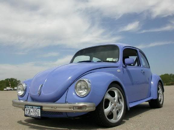

How about going the other way, Porsche whels on a Bug? Here's mine.
Mike²
1985 M491
