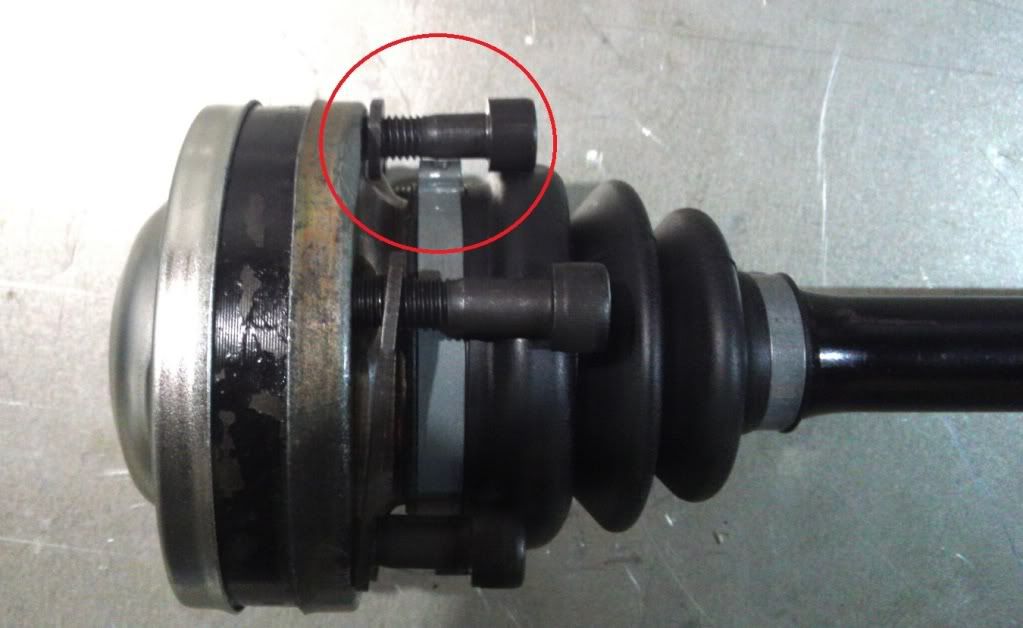

McLaren-TAG 03-05-2012 04:04 PM
That you Pelican Forums...
For the never ending amount of information available here. I just finished replacing my CV boots, followed the threads, got the torque specs from the Bentley Manual, and I'm almost done. The inspection was fine, but wanted to share one more bit of DOH wisdom.
Make sure that when you tighten the metal retaining strap that comes with the kit you don't do this... the nub should not go right in the path of where one of the M10 bolts needs to go.
http://i1193.photobucket.com/albums/...ootReplace.jpg
