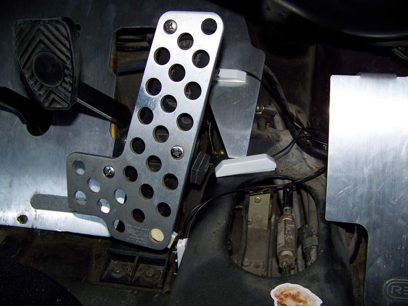

Looks like a good winter project. Do you have directions, scematics for how you wired all that up?

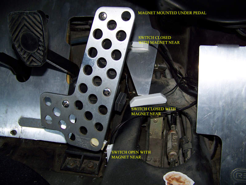

I'm not sure if you're asking about my lights VaSteve, but they are a pretty simple setup: four incandescent bulbs, 1 red, 3 green, that are activated by the brake master cylinder switch (red) and three magnetic proximity switches mounted strategically around my gas pedal. I ran a 12v bus to all the lights, and switched the grounds at the mag switches. The "On throttle" switch is a normally open (when magnet is near) magnetic switch that closes when the magnet moves away. The "Mid throttle" and WOT switches are normally open until the magnet nears.

Yeah, your lights. The brake light I could figure out, do you have photos of how you wired up the throttle switches? Do you have a parts list of any sort?

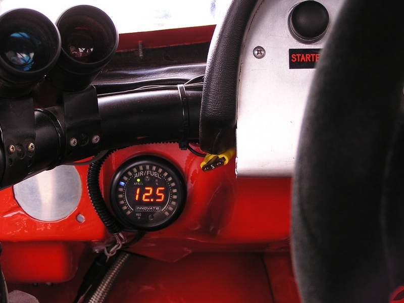

I'm actually in the camp that "less is more" and try to keep gadgets down to a minimum. I know people that don't have an oil pressure guage due to weight... although I'm not that bad yet.
Here is a recent gadget I added for the 06 season.
The XD-16 from innovate.
The warning lamps are 80Watt for the oil pressure and alternator (I want to know IMMEDIATELY if I loose a fan belt)
if these lights come on they are impossible to miss even in mid-daylight.

VaSteve: I used the little white magnetic switches you can find at Radio Shack with double sided tape to mount them near the gas pedal, and then used small magnets attached to the gas pedal.

Here's a pic with info:
