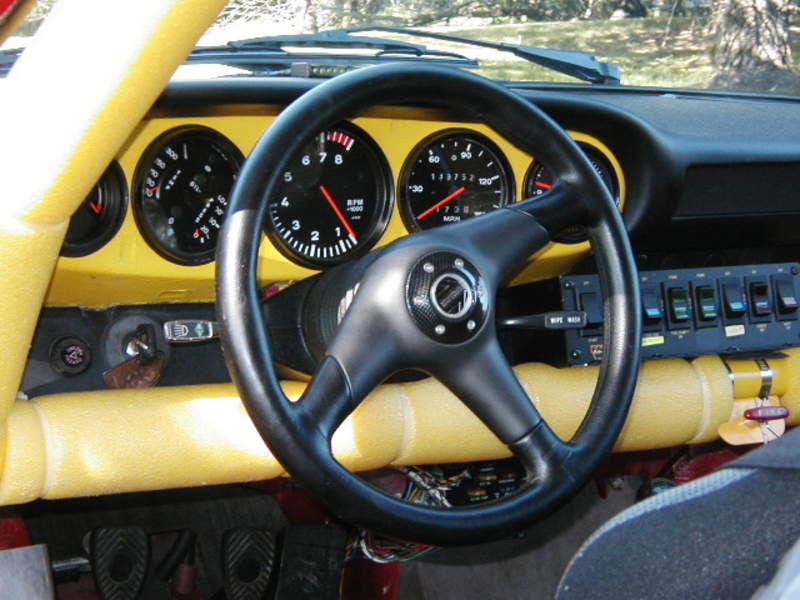

I got one of these in my car... No need to look at tach to shift. Just get a glimpse of color out of the corner of my eye. You can barely see it mounted on top of my dashboard. Fully programmable, green/amber/red, you can have indidual lights or sequential and it blinks when rev limiter is hit. Just like the F1/ALMS cars! Lou
http://www.datatool.co.uk/consumer/products/products/index.php?product=revlight
Go to support and see their video

Lou, I like the rev light (See mine in the video above), but I like your switch panel more. Details?

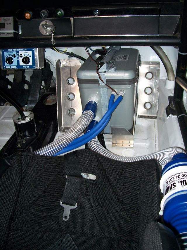

ted ted is offline
likes to left foot brake.
ted's Avatar
Gotta have a cool shirt.
The helmet blower works well, one really nice benefit is that the air intake is then outside the car.
No breathing all the brake dust, fuel, oil and rubber remnants.
Also on dash I have an air/fuel meter I'll can glance at once a lap.

Good point, Ted. Racing in NorCal will require some serious driver cooling. I'm using a 2-layer NOMEX suit that starts to get pretty warm, even on a cool day.

The panel is from Painless wiring. When I bought the car, PO had butchered harness. Since it was going to be a track car, I decided to start from scratch and use a Painless street/track kit. I bought the 8 switch box to go with it. It uses standard bayonet fuses. I figured it would be more reliable that 30 yr old wiring. Saved 7# (21 vs. 14) while at it. I spliced kit harness with OEM by starter. Wanted to reuse the 14 pin connector for easy eng drops. Pretty much became an expert at reading the wiring diagrams. You can see the fuses in the lower opening of the steering wheel. It is mounted by footwell. It has been running flawlessly since installed. Car is street legal and all electrical items work. Panel controls fpump, ignition, push button starter, lights, electric heaters and electric defroster. I left the key in the circuit to kill all electrical power. Hope this helps... Lou
