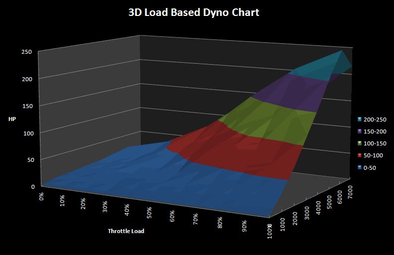

In general increased torque increases acceleration which is what you feel, while hp is used to maintain a top speed. Realize that dyno charts are only a measure of power at full throttle, and do not display part throttle torque gains, where you feel it most. If you have a track vehicle, hp gains are important to you. But not everybody drives their car at 6000 rpm on a consistent basis, and you don't always floor your pedal at 2000 rpm when driving on the street.
If your car is mostly a street vehicle, you'd spend at least 95% of the time in part throttle mode between 1000-4500 rpm (where the dyno charts don't show), and here is where part throttle torque gains make all the difference. It is a little understood area that defines the primary difference between the characteristics of different chips, between a chip that either feels flat or surges, or one that has instantaneous response and pull on the crack of your throttle . It is the most complex region to tune, but properly done this region is the most usable as it significantly increases throttle response, acceleration, fuel efficiency, and eliminates the sub 4000 rpm lag that is inherent in 911s.
Think of a typical dyno chart as a 2-d graph, with rpm as the x-axis, and power on the y-axis measuring 100% load. Now if there were such a thing as a 3-d dyno chart, what you'd also want to look at is the graph in the third dimension, the z-axis from 0 to 99% load, such as the following example:
