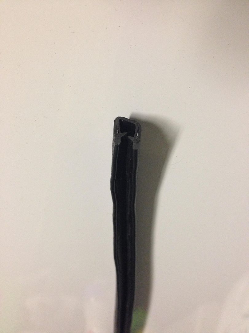

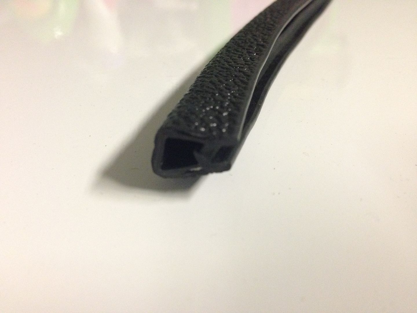

I'm thinking of using this which appears to be the same sort of thing for Beetle pop-out windows. $20 for 2 - 75" pieces. https://www2.cip1.com/ProductDetails.asp?ProductCode=C16-113-131B-BK ![]()
Join Date: Apr 2003
Location: Houston
Posts: 567

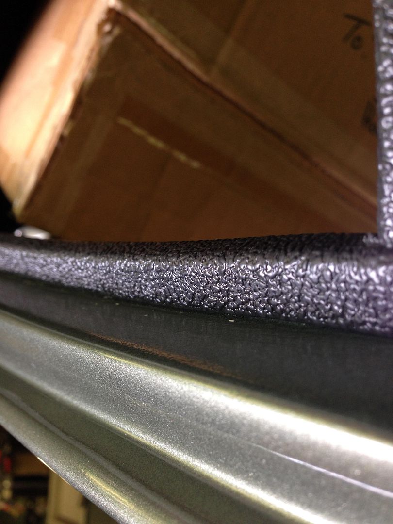

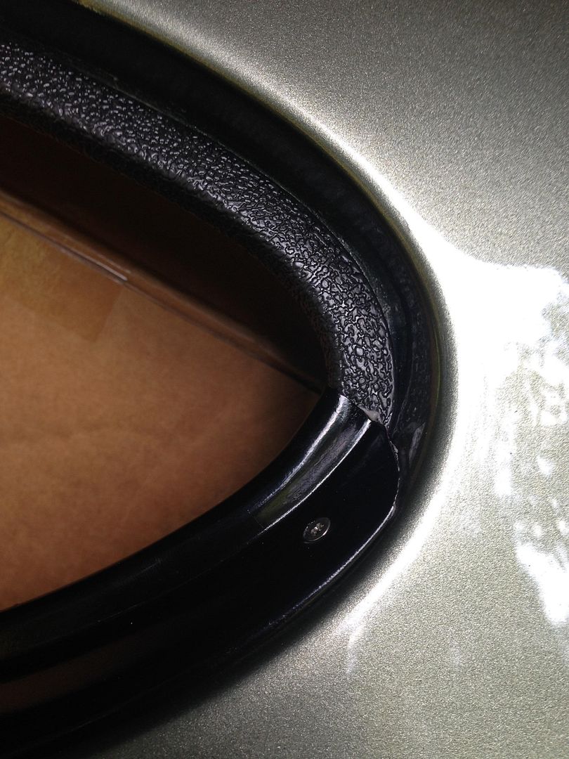

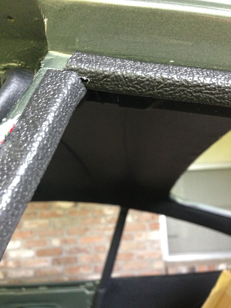

I ended up buying some pinch welt from Jbugs.com, it was about $25 shipped for a roll with enough to do both side and plenty to spare.
Black Pinch Welt, (Seal clips on body) Fits All Years. - JBugs.com This is what it looks like ![]() ![]() And installed ![]() ![]() ![]() I cut a slit in the top pinch weld so it would run past the vertical piece

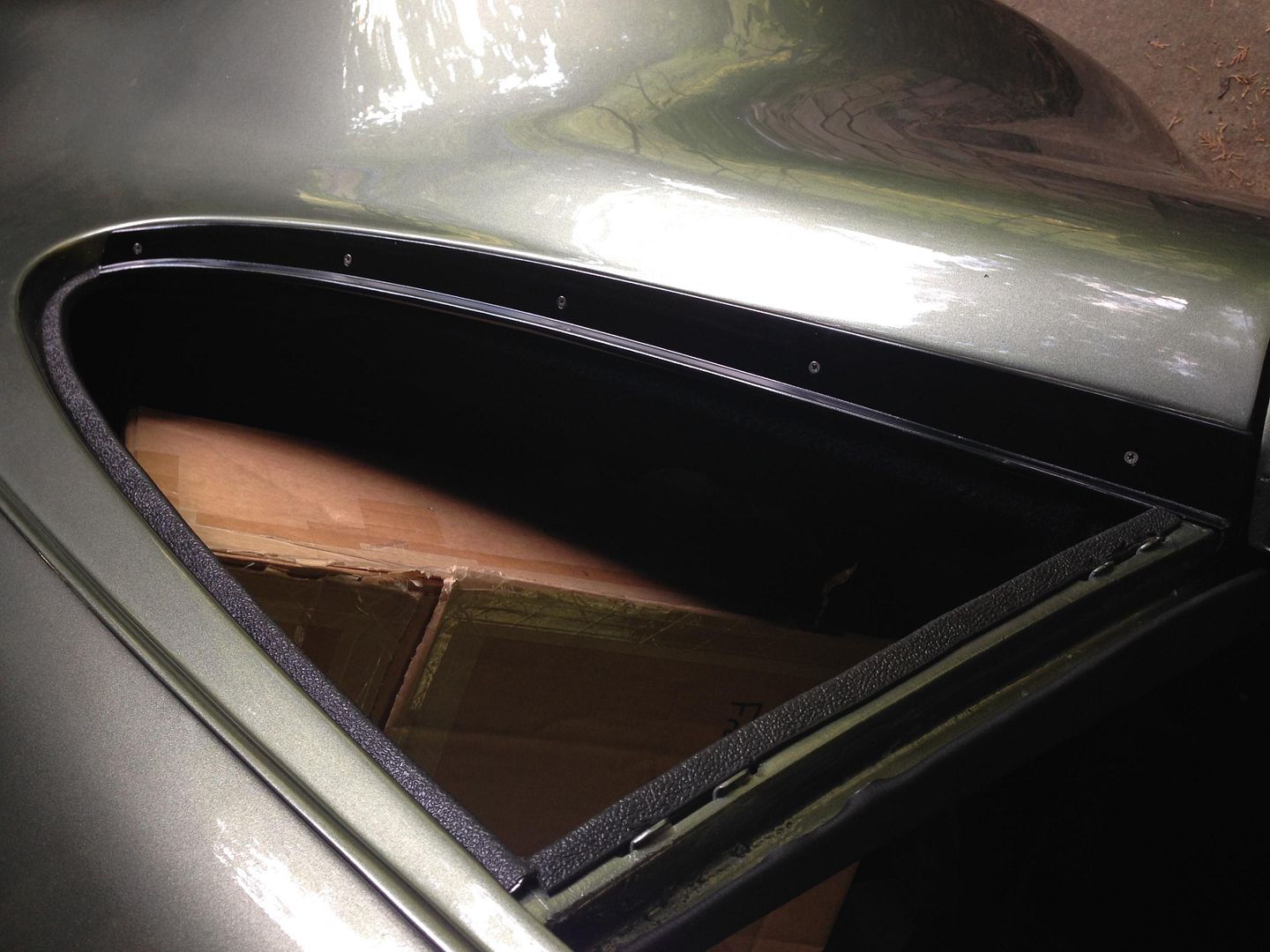

After doing an AC delete after getting the car, it became quickly evident that the flow thru ventilation is poor compared to an early car, so I bit the backdate bullet.
Today a good friend/skilled mechanic and I completed the backdate on the '82. A few thoughts. Rather than using self tapping screws which are not too robust, we ended up cutting threads in the B pillar and using screws. It was a real PITA since extra drilling was involved to provide enough space for the screws but it is now very stout. For the rear latch, we ended up drilling the existing mounting holes and using riv-nuts. See pic. Since no vendor had all the hardware I needed (seals, missing latch, mounting hardware) I used pelican and Aase. I ordered the welting named above and it was perfect. The only change I made was cutting channels on the vertical pieces which are then nicely hidden by the horizontal. So the welting on the B would lay flat, I notched it on the inside which you can't tell by looking at it from either outside or in. I still need to paint the body trim pieces, so I just installed without, filling the mounting holes with body color paint. Also need to paint the used frames, but that will be another day. Considering the precise thread tapping and drilling needed for the taps and riv-nutsLbbgngnnhnh <-cat typing, it takes some good skill to do it right, which are two notches above my level. Breaking off a tap I can do no problem. This is the result ![]() ![]() Total time was 6 hours.
