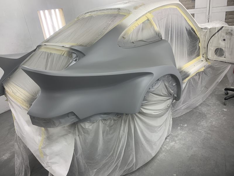

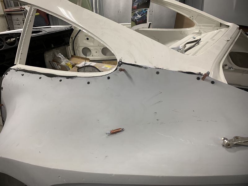

ktr6 09-24-2019 05:09 PM
Rear Fenders
More body work now that the rear fenders are finally bonded to the car:
http://forums.pelicanparts.com/uploa...1569370088.JPG

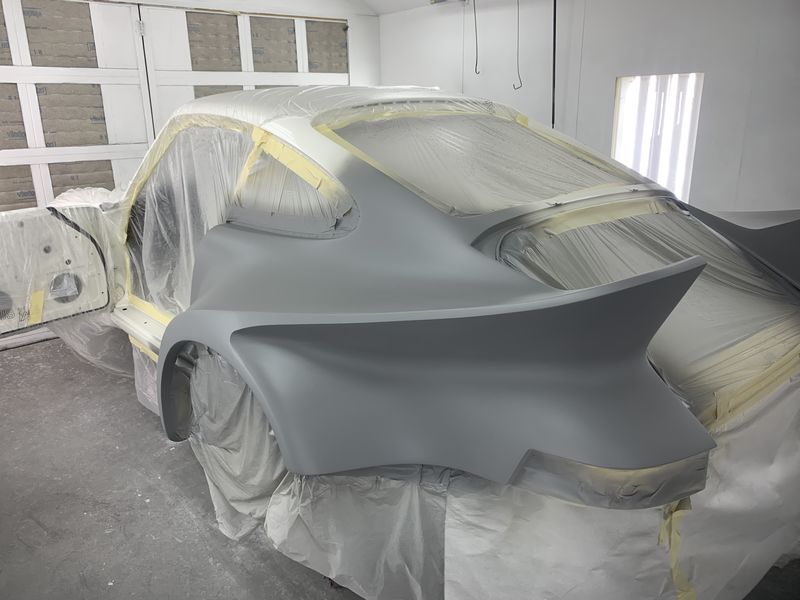

ktr6 09-25-2019 07:02 AM
More rear fenders
More shaping and body work:
http://forums.pelicanparts.com/uploa...1569419992.JPG

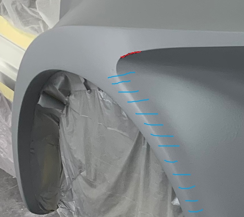

ktr6 09-25-2019 07:06 AM
More Rear Fender Work
Primer. First image shows some marks where Keith wanted the edges sanded a little smoother, his attention to detail is second to none:
http://forums.pelicanparts.com/uploa...1569420220.JPG

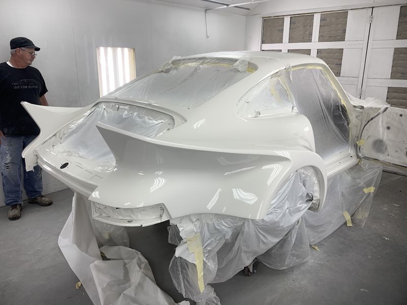

ktr6 09-25-2019 07:08 AM
And paint. Tub is going all white as Porsche delivered them, then painted appropriate exterior colors:
http://forums.pelicanparts.com/uploa...1569420443.JPG

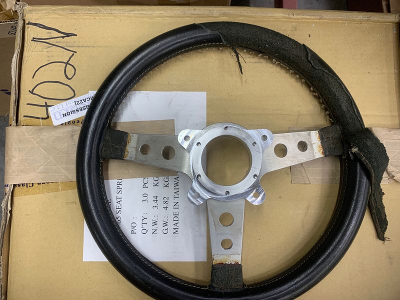

Steering Wheel
Progress on the body work continues. In the meantime the next detail to be worked on is the steering wheel. The R7 used the same wheel used in the 910/917 as seen here:
http://forums.pelicanparts.com/uploa...1569678088.JPG
ktr6 09-28-2019 06:48 AM
R7 Steering Wheel
http://forums.pelicanparts.com/uploa...1569678501.JPG
ktr6 09-28-2019 07:01 AM
Steering Wheel

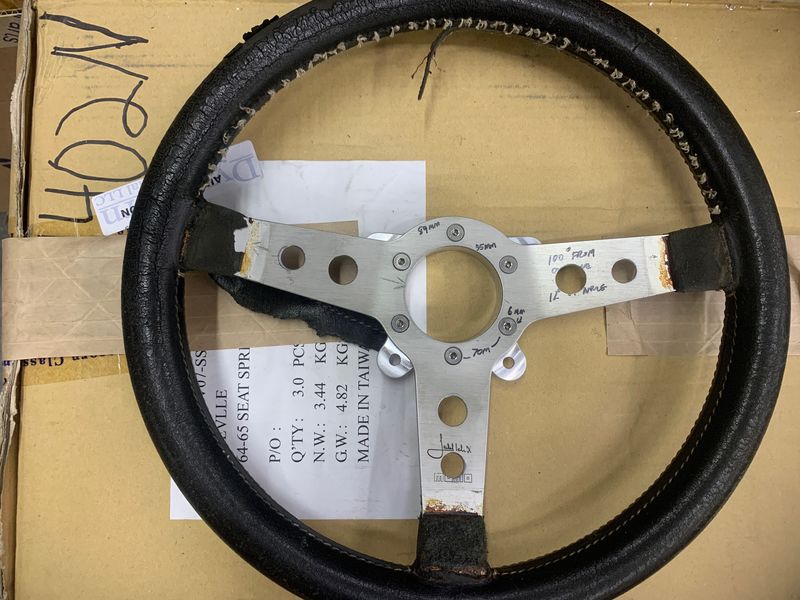

We were unable to find a readily available wheel for the project so we decided to make our own. After much research Keith found that a Momo Jacky Ickx wheel, although slightly smaller diameter, had similar proportions and look to the 910/917 wheel:
http://forums.pelicanparts.com/uploa...1569679231.jpg
ktr6 09-28-2019 07:09 AM
Steering Wheel
So research began and Keith was able to develop the proper dimensions and hole sizes that would need to be drilled for the wheel to be correct. After modeling in the virtual world he made an overlay/template to make sure that the machine work was correct.
http://forums.pelicanparts.com/uploa...1569679734.JPG
ktr6 09-28-2019 07:14 AM
Steering Wheel
Holes drilled and the hub adapter fits nicely. The wheel will be painted satin black and sent out for recovering. Currently researching the correct stitching and leather.
http://forums.pelicanparts.com/uploa...1569679878.JPG

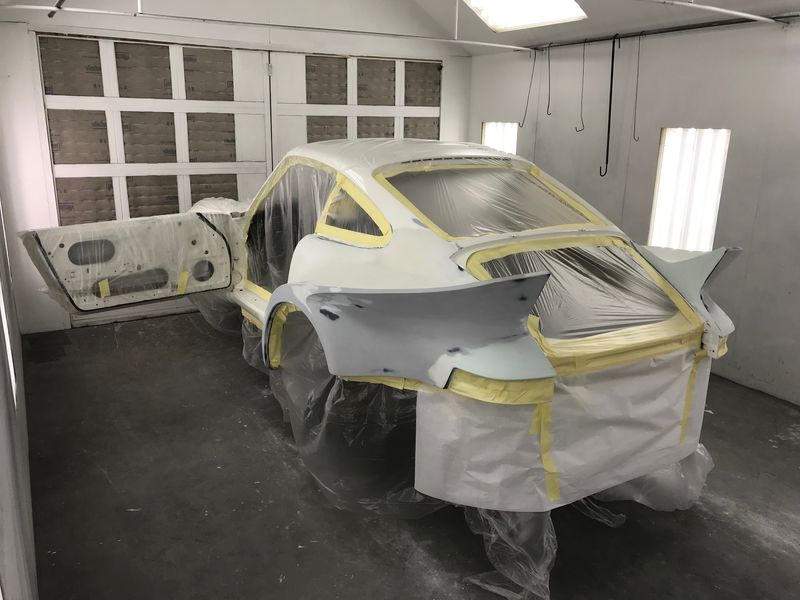

ktr6 10-12-2019 09:20 AM
Paint
And last but not least, the tub is in the paint booth for paint on Monday!
http://forums.pelicanparts.com/uploa...1570897221.JPG
Outlaw_singer 10-12-2019 02:38 PM
I've only just run into this thread. Don't have time to read through it now, just had a quick look at this last page when the steering wheel thing caught my eye.
I guess one of these is what you may have needed.
https://i.ibb.co/sjDhX9h/917-Momo-Pr...petition-0.jpg
ktr6 10-12-2019 03:28 PM
Wow, yes that would work perfectly! Nice looking wheels.
