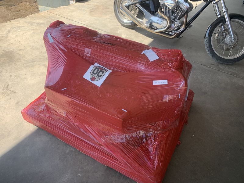

ktr6 09-19-2019 06:44 AM
Fuel Tank
Proper 110L plastic fuel tank has arrived from Switzerland. Working on a solution for the dry break fuel filler.

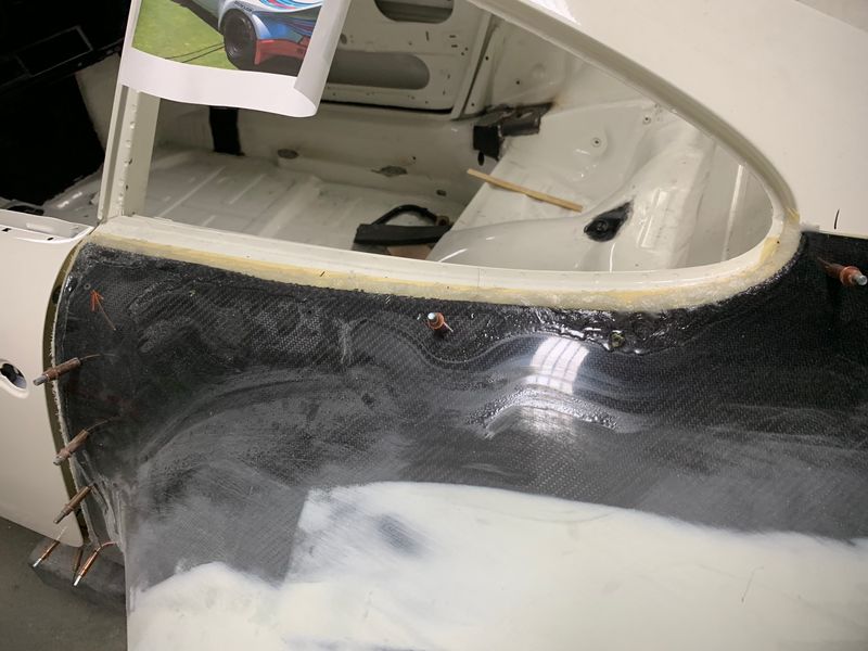

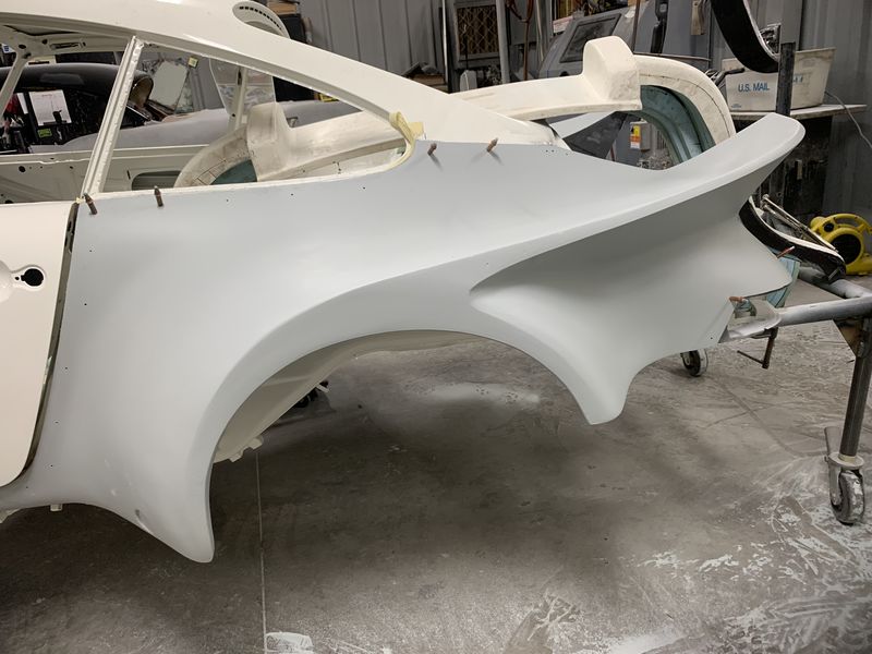

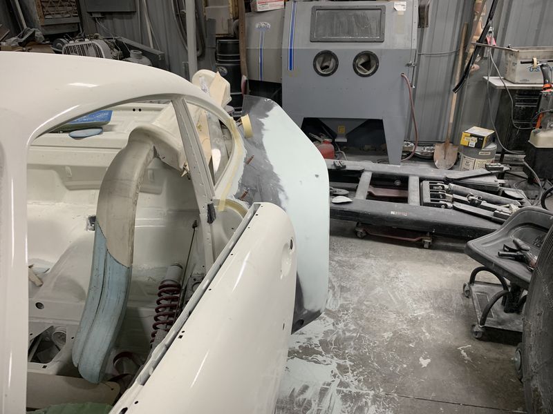

ktr6 09-21-2019 06:46 AM
Once the carbon work was done it was back to the body shop to fine tune the shape and get the fenders bonded to the body:

Markus33 09-23-2019 10:44 AM
No wonder the Mary Stuart Collar is a mod not often seen. Amazing work.

ktr6 09-24-2019 04:58 PM
More Rear Fenders
Big moment for the build, fenders being bonded to the car:
