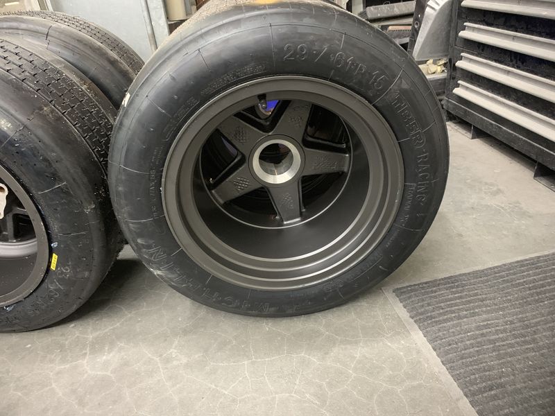

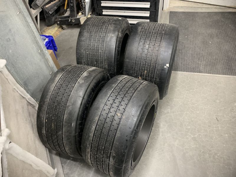

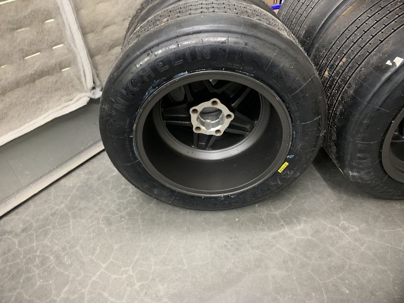

ktr6 09-08-2019 01:03 PM
Wheels back from being machined to proper offsets as they were a little wider that what was needed to fit in the fenders. They are also painted and had a very good trial fit.

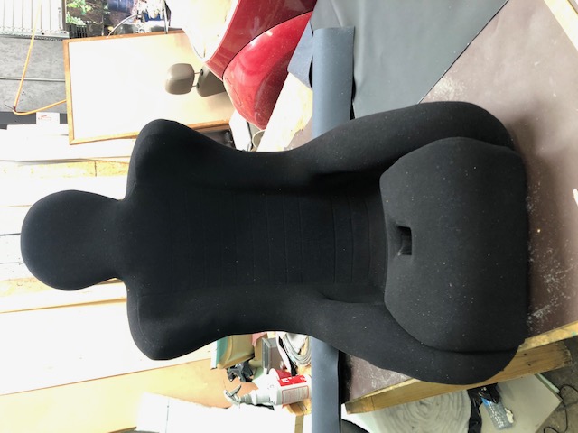

ktr6 09-08-2019 04:11 PM
Seats
Next we needed to figure out seats, the original MS has an RSR passenger seat and a Lollipop driver seat. As I looked around I found Ward at Vintage Seats located in Cumming, GA. He said he could make an RSR seat as supplied no problem and had it ready in short order. It has the proper gel coat back and uses Recaro material.

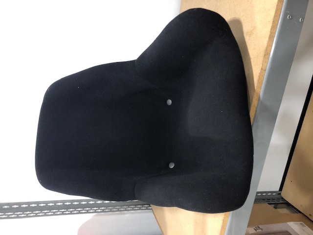

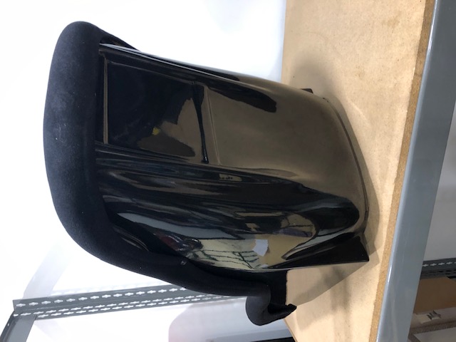

ktr6 09-08-2019 04:41 PM
Lollipop Seat
While I was talking with Ward about the project he mentioned he had an original Lollipop seat in storage and was considering making a proper lollipop replica at some point down the road. After studying it and giving it some thought it seemed like the right time to make it happen. Work began and within roughly 90 days he delivered a great seat as promised. The new seat has pleated recaro material on the front with a carpet back.
I have to take a moment to compliment Ward and his work. His customer service is phenomenal, always available and delivers his product on time and as promised.
