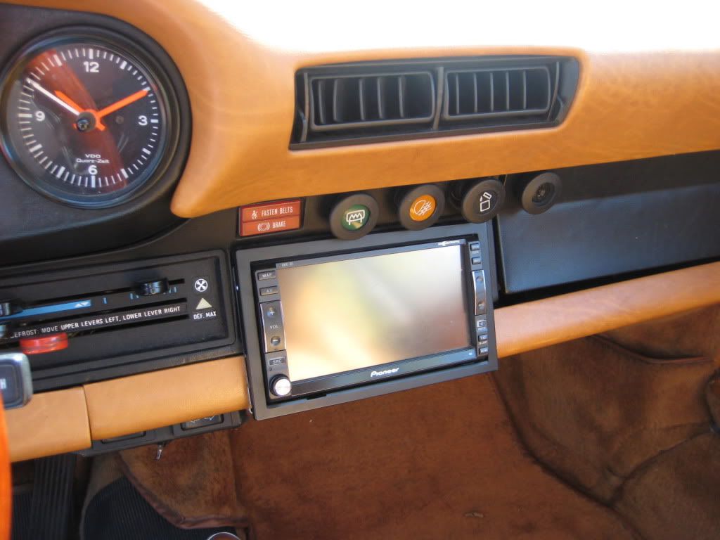

I remember there used to be an Alpine or Eclipse unit that stowed the screen in the head unit itself and deployed it (out and up) as needed. Is that still an option these days?

I am wondering if anyone has tried something like this http://www.alpine-usa.com/US-en/products/product.php?model=IVA-D106

I think the problem with unit like this is that the screen will: (1) hit the dash in our cars and be angled downwards and (2) block the center A/C vents

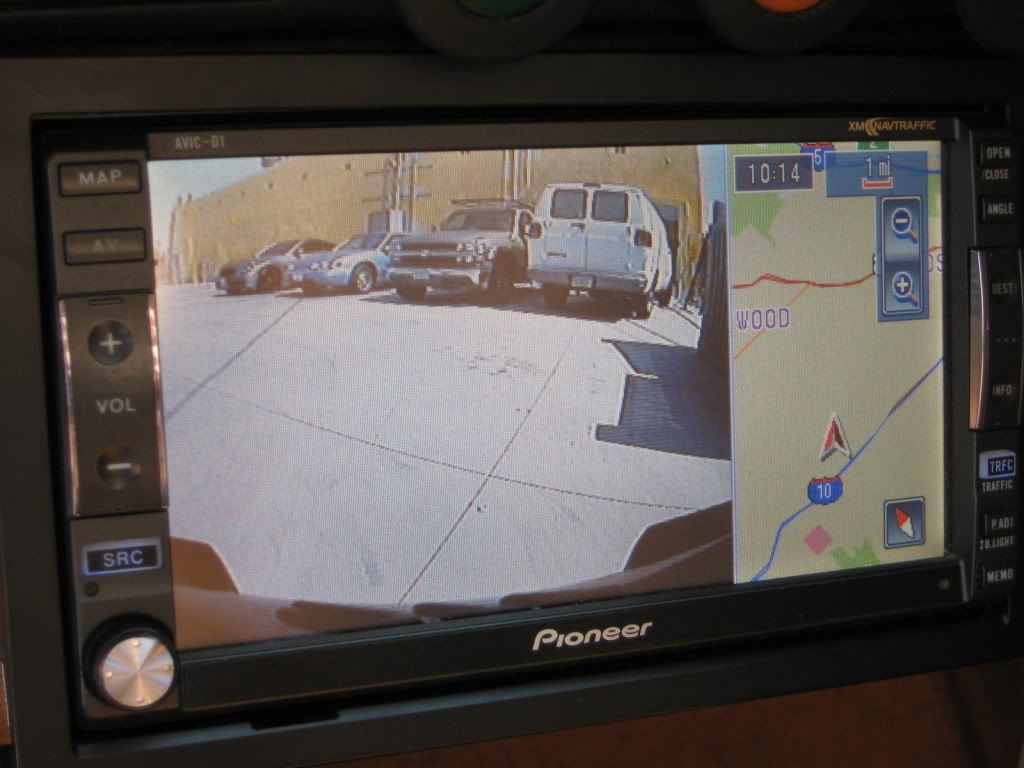

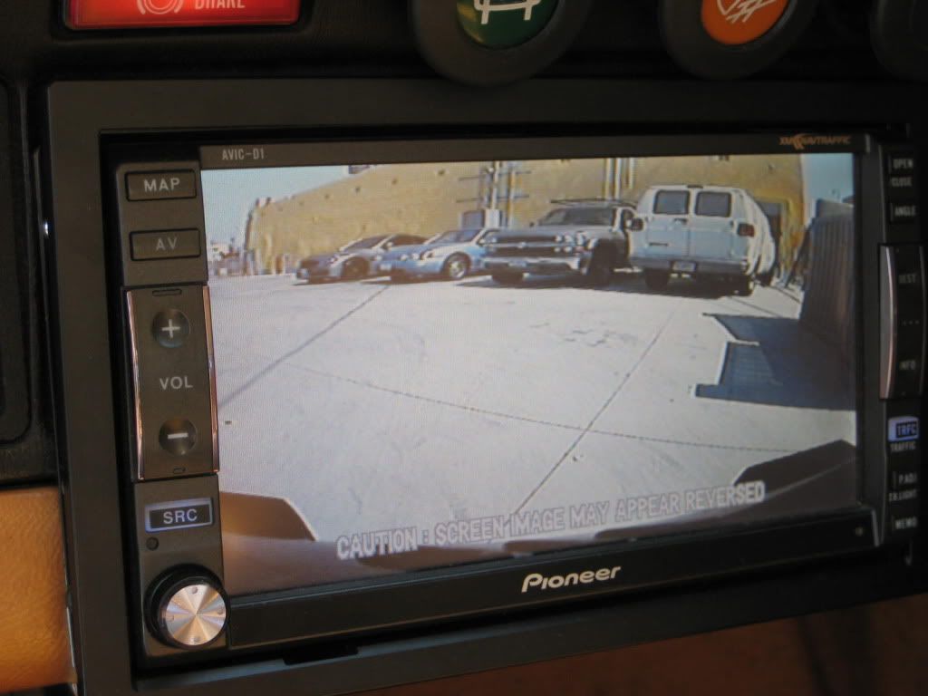

Couple of night vision shots:
First same view as this AM in the driveway:
Parked in the garage looking back into back of neighbor's garage:

does that cam require a wired connection for the video?
or it wireless?
or it wireless?

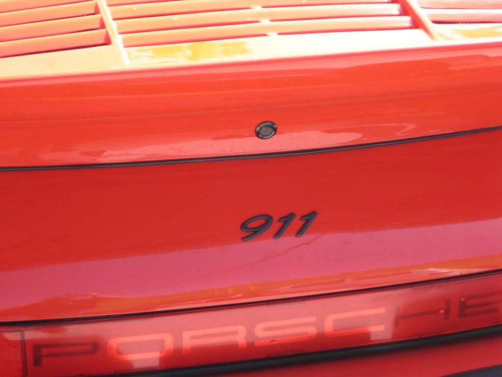

It is a "wired" connection camera. Wire runs from the camera, tapped reverse trigger wire into reverse light in right tail light then encased in 1/4" split loom wire protector and zip tied to oil lines running up to front fender then inside trunk through one of the existing rubber grommets near headlight and plugged into LCD screen's wire harness (RCA video input connector).

Hey Mark,
You inspired me, I just purchased and installed the JVC NX-5000 NAVI/DVD Player w Bluetooth. Screen is small but adequate.
Question, from the Camera, where did you run the wires into the engine bay's right side to tap the reverese light switch wire?
Also have you considered running the wires thru the tunnel, Defrost wire access or even the left side where the cluster of wires go to the DME?

Jim, I considered several different routes but felt at the time that route I chose was the easiest. Here is pic of the camera wire running under the bumperette along the underside of the bumper and through the gap at the valance. The reverse trigger wire runs back to the tail light and taps into the reverse lead.
