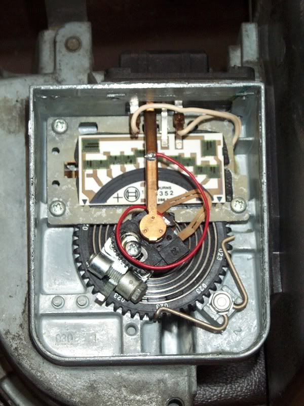

I've done much work on these AFMs and I know that your AFM signal voltage should be about 1.0 to 1.3volt at idle. Now if your idle is way down in the 600RPM that voltage would be lower if lean and much higher if rich. I suggest a quick poke at the voltage line on the AFM just to see what you have. If you really are rich the voltage would be higher than 1.0 volt. Testing the voltage value from the AFM while at idle will give you a general idea of what the AFM is signaling, above 1v is richer below is leaner, should at least give us some more clues and it's a simple test. I know you said you don't run an O2 sensor but can you stick one in? do you have a spot for one? If so put in a simple narrow band O2 and measure the voltage on it's signal line, if it above .7v your rich if it's way down below .4v your lean, another cheap trick to find lean or rich indication.
Here is a picture to help, the signal line is the green/red stripe:
I also have a detailed AFM doc I started sometime ago that may be worth taking a look at, you can open the AFM but I DO not recommend changing any of the adjustments, not yet anyway. You need to look everything else over first. Here is the doc:
http://members.cox.net/widebody/ then find the link at the bottom, it's a WORD doc.

You mentioned that at idle your AFM is 5% opened, this indicates LARGE air leak somewhere after the AFM. You then said that if you open it to 20% by hand the idle comes up, the 20% open door is correct for idle. See below.
At Idle your AFM should be about 20% opened, see this picture, it should be at pos #2 (more or less):
The 20% open door is not a guess on my part, I actually looked at my properly running car with the cover removed from the AFM. The voltage was about 1.0v at idle in my car.

Sal - fab info on the inner workings of the afm, I've downloaded your word doc and have also taken a reading from my afm at idle, its hovering between 1.36 - 1.37v which is a bit higher than your findings of 1v. Makes me think either I was wrong and my vane is opening a lot more than 5% or that my afm is way out of calibration.
At what RPM are you seeing 1.37V? My numbers are what I see in my car, but if your RPMs are low as you say and you are seeing 1.37V signal from the AFM my bet is it's running rich. But, please don't guess here. Get that O2 installed and see if it reads above .7v that will tell you for sure.
If you are at 1.37V or so then that AFM is about 30% opened.
Next, You can open the AFM just to have a look but DO NOT touch any adjustment! If you muck with it you'll find it very hard to get it back to original settings. Look closely at the AFM to see if it has ever been opened by PO. If you think it has it's a red flag! Many folks go into these AFMs and losen the spring thinking somehow it will help performance, it won't! The only way to tune these cars is with a Wide-Band O2 monitor and the services of someone like Steve Wong to burn you a new chip.
Sometime ago I tried to get folks to measure the AFM voltage at idle on well running 3.2L Carrera to get a baseline from several cars. I had no luck, folks just did not respond. I think this is very easy non invasive test that would really help others. If you wish to measure the voltage please send me the reading to sal.carceller@cox.net I'd love to have more numbers.
I'm suspecting you are rich at idle based on that AFM signal.
Please send the RPM value that went with the 1.37V signal.

Sal - In answer to your question, yes my afm has been opened before (by me a year or so back when moving the fingers onto fresh track and also adding the extra wire that was present in the later year afms) but scouts honour I didn't fiddle with any of the adjustments! I've just cracked her open again and baselined my voltage using the guide in your word doc. Here are my results compared to yours:
I couldn't comment on the tension of the spring as I've never changed it, but my adjustment "A" looks in quite a similar position to the photo of yours in your word doc:
So since my results are so similar to yours i'd say my afm is working properly, but since I'm getting around 1.37v with a low idle my guess is either I need to adjust my idle mixture to allow a bit more air to bypass the vane, or my spring tension is too weak. Will know more once I get an 02 sensor installed and can start taking some readings.
