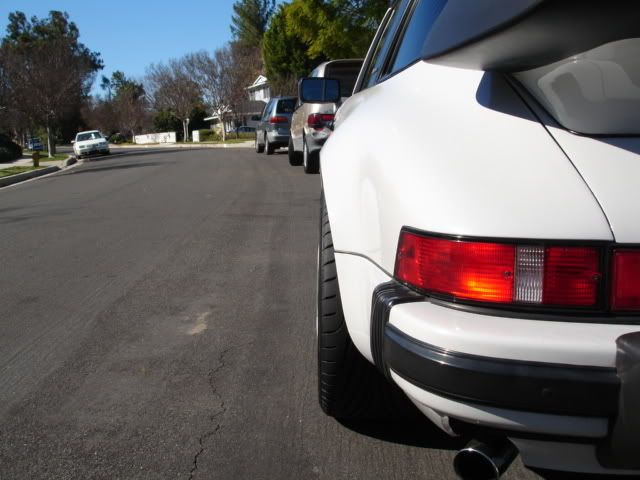

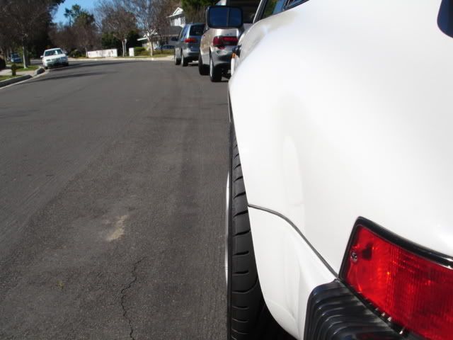

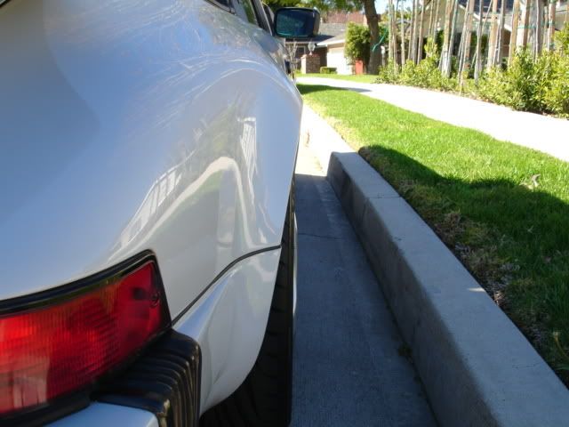

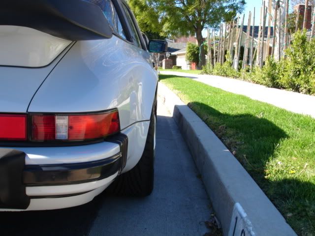

Rudy at AXIOM in INGLEWOOD, CA took some valuable time out of his very busy schedule to help a fellow Peilcan. He properly checked the measurements on both rear fenders from the bottom of the rear window down the center of the center cap.
Result: Only a bit over 1/8" inch difference, shorter on the driver side.
Very Glad that is was not what I thought when I measured from the inside of the fenders ( the wrong way ).
We both noticed that driver side appears to be perpendicular to the road where as the passenger side is "cambered inward at top about a 1/4" of an inch under the fender. (Rudy, I verified on a level surface at the gas station)
20 feet away:
Driver Side:
Passenger Side:
Rudy even gave me a 1/4" spacer to try but I trully believe now that I need to have both the passenger side camber adjusted and realign the whole car.
Am I to assume that change in the passenger side rear camber will require and new alignment as per Bentley?
Now should I Camber in the top portion of the Driver Rear Wheel and Camber out the top portion of the Passenger Rear Wheel?
