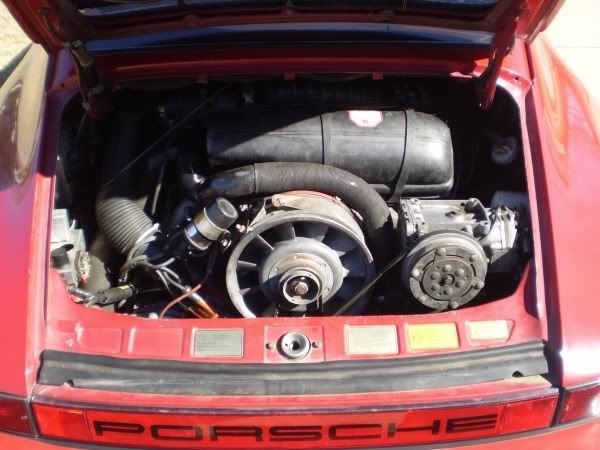

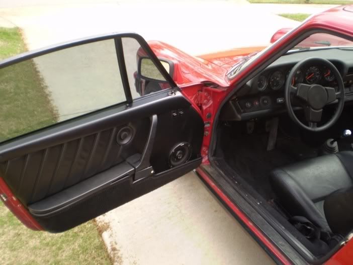

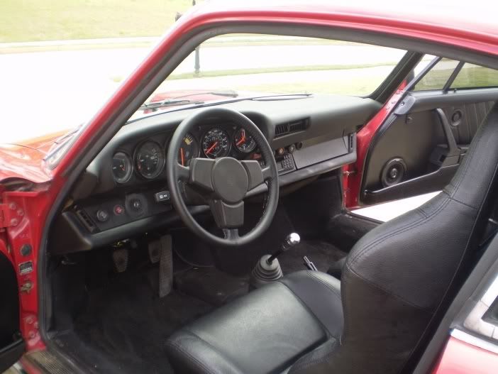

Finally an update with some pictures.
I had to replace the windsheild after the debacle on trying to switch trim on both of my cars. I must have been extremely lucky (hard to imagine with how things have went with this car) as the windsheild install was a breeze, did it by myself in about 20 minutes. While the glass was out I painted the lip that the windsheild mounts in so it is good to go for a while.

I also decided to dye the interior to black from cork since I recovered the dash.
http://img.photobucket.com/albums/v2...4/int911dr.jpg
http://img.photobucket.com/albums/v2.../int911ins.jpg
http://img.photobucket.com/albums/v2...4/intrear1.jpg
here is how the engine looked before and now (still some work needed here)
http://img.photobucket.com/albums/v2...j4/engine1.jpg
http://img.photobucket.com/albums/v2...j4/engine3.jpg
And to finish last week, I installed a new muffler I got from V8 Ranch from the board here.
More to come. The fender hunt has just stalled and it will probably look like this most of the summer.
Thanks for all the feedback and help so far.
Phil
Elombard 04-08-2008 12:43 PM
wow the dye job looks awesome? Does it look that good in person? Did you do a write up on the process?

w21055 04-08-2008 02:49 PM
Erik,
Just let me know. What year is it? Could not keep you away for long!
Thanks for the compliments, the interior looks pretty good IMO I was suprised. The doors look great, the rear panels do have a couple of "dry" looking spots that I have no idea what made them do that, but for now it works for me. I did not document the color change as I had seen several posts here and followed their advice.
On the windsheild I found on here that it was easier to go around the gasket with the rope two times and that made it easy to do because it really did not want to lay all the way down the first time around.
John-1977911s 04-08-2008 03:00 PM
It looks as though the steering wheel wrap has changed as well? It's beautiful now.
Did you do that and was it one of the kits?
Thanks.
John
w21055 04-08-2008 04:17 PM
I recovered the wheel with one of the kits from our host. ALGA or Allan Gunn was the name of it i think.

Doug&Julie 04-21-2008 02:30 PM
Originally Posted by w21055 (Post 3874688)
I'll pose this to the group as a question as I don't want to alarm you, but...does anybody think this is not a safe seat-belt situation?
w21055 04-21-2008 02:33 PM
I will reply to it Doug. In that pic the bottom of it is not bolted down, so there is no resistance at all. Is that what you are pointing out?
I was rushing for the photo op.
Thanks
Phil

Doug&Julie 04-22-2008 04:16 AM
Thanks
Phil
Ah, yes...ok, thanks. Carry on! :)
