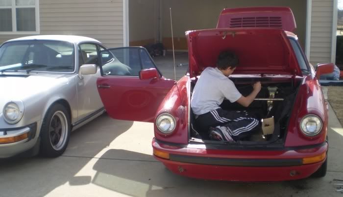

A shot of my helper during the AC removal
Been pretty fun so far. It only took 3 tries to get the rear height where I wanted it.
