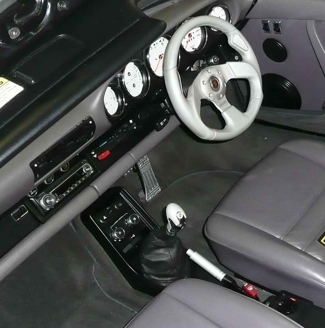

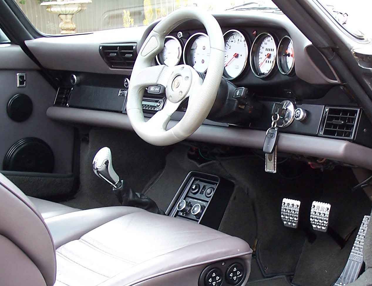

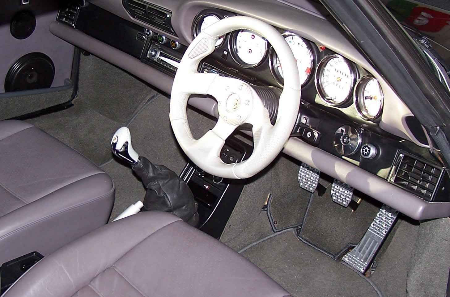

Best ones I have
As I am not home at present. Don't know if they are any help.

Dave,
Measuring the shift lever pivot point is more accurate, but did you miss this part?
How to Identify Factory vs Factory Short Shift
Quick Method:
With a factory short shifter (FSS), the distance from the center of the shift knob to the lower edge of the ash tray is approximately 4 1/4" in first gear and 9 1/2" in second gear.

The adjustable set screw in the shifter base started appearing in '77. Prior to that (74-76), there were two split tension pins that provided the pivots for the shift lever fork.
Tom,
The collar at the top end of the shift lever is an indication of a factory short shifter. However, not sure if that collar also appeared in '85-'86. These are called the factory semi-short shifter (FSemiSS), that provided a shift reduction of around 10%.
From dimensions on the web page (http://www.seinesystems.com/ShiftLever.htm) are my measurements from the samples I had on hand. Here are 3 shift levers for comparison. From the top:
a. Standard factory lever (X = 43mm)
b. Factory short shifter (the collar at knob end has been removed), 55mm
c. Weltmeister lever, 59mm
In a factory semi SS lever, dimension X is around 46mm.
The definitive indicator is the shape of the shift lever fork (the rectangular-shaped box that contains the lever. Here's the standard shift box. It's a two-piece construction on pre-77 shift housings and one piece construction on '77-on shift housings. The pivot pin hole (L-R) is in the exact center of the fork:
On a FSS kit, notice the fork has a curved section that contains the relocated pivot hole (higher up). The Factory semi SS fork looks like the above photo, but with the pivot pin hole between the standard and the FSS fork locations.
Looks like you have a factory short shifter in your photos.
Whew. Hope this helps,
Sherwood
