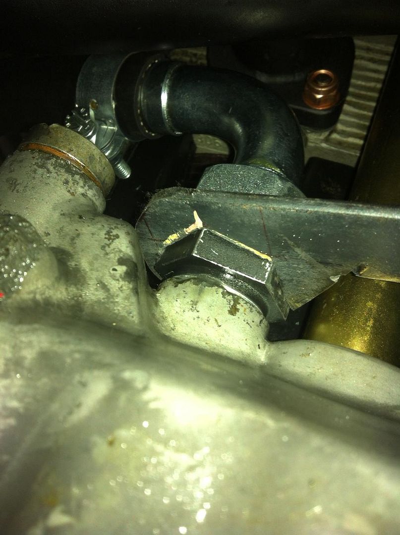

32mm 'Thin' shaped spanner made at lunchtime...Used to nip up the Oil return reducing adaptor, and then hold in place whilst the 90degree Hose fitting is tightened...

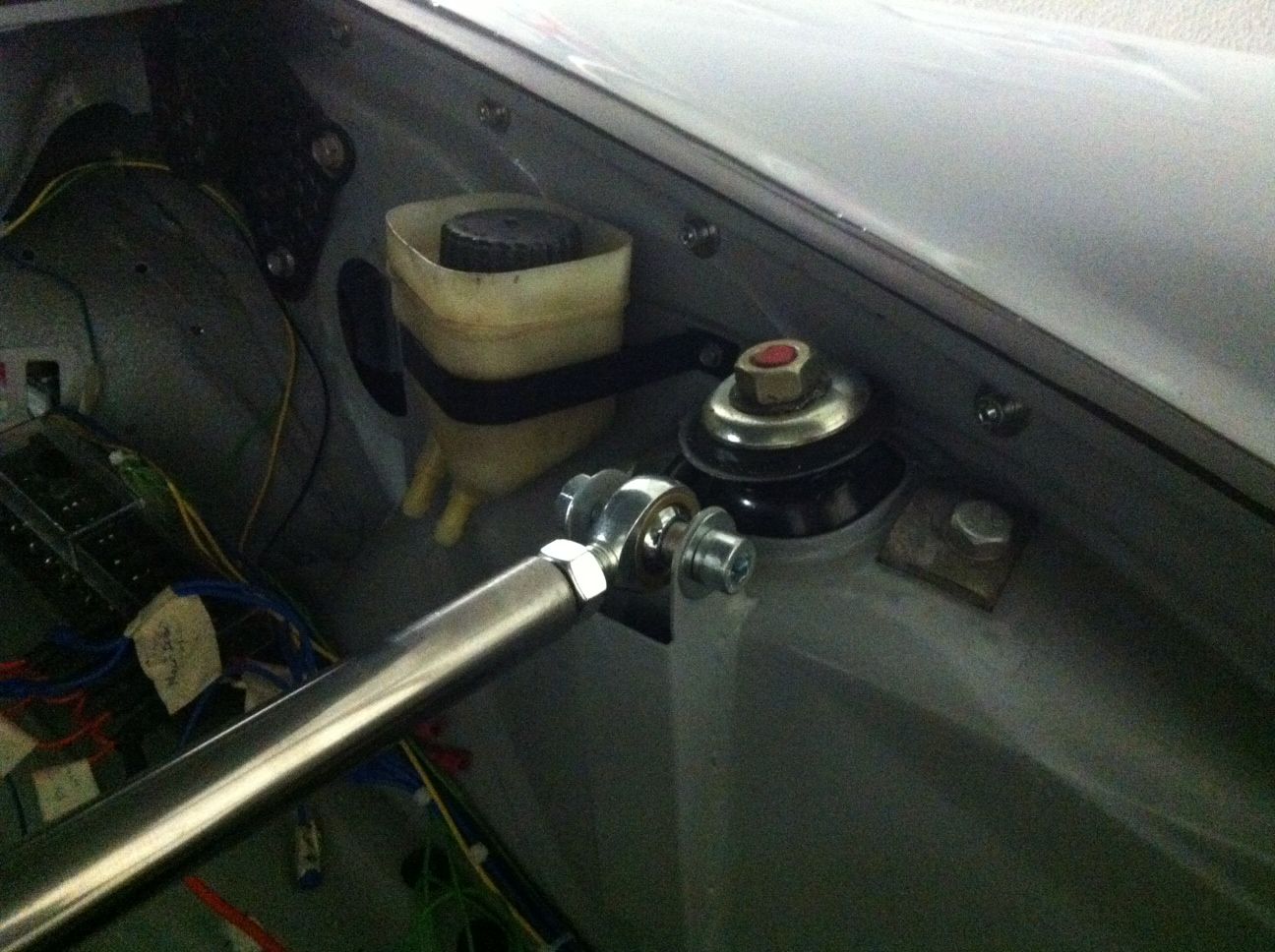

But I am happy with my custom Strut bar, I do like those Rose joints...
Cheers
Chris

They are Heim joints if you are in Germany, Rose joints if in the UK.

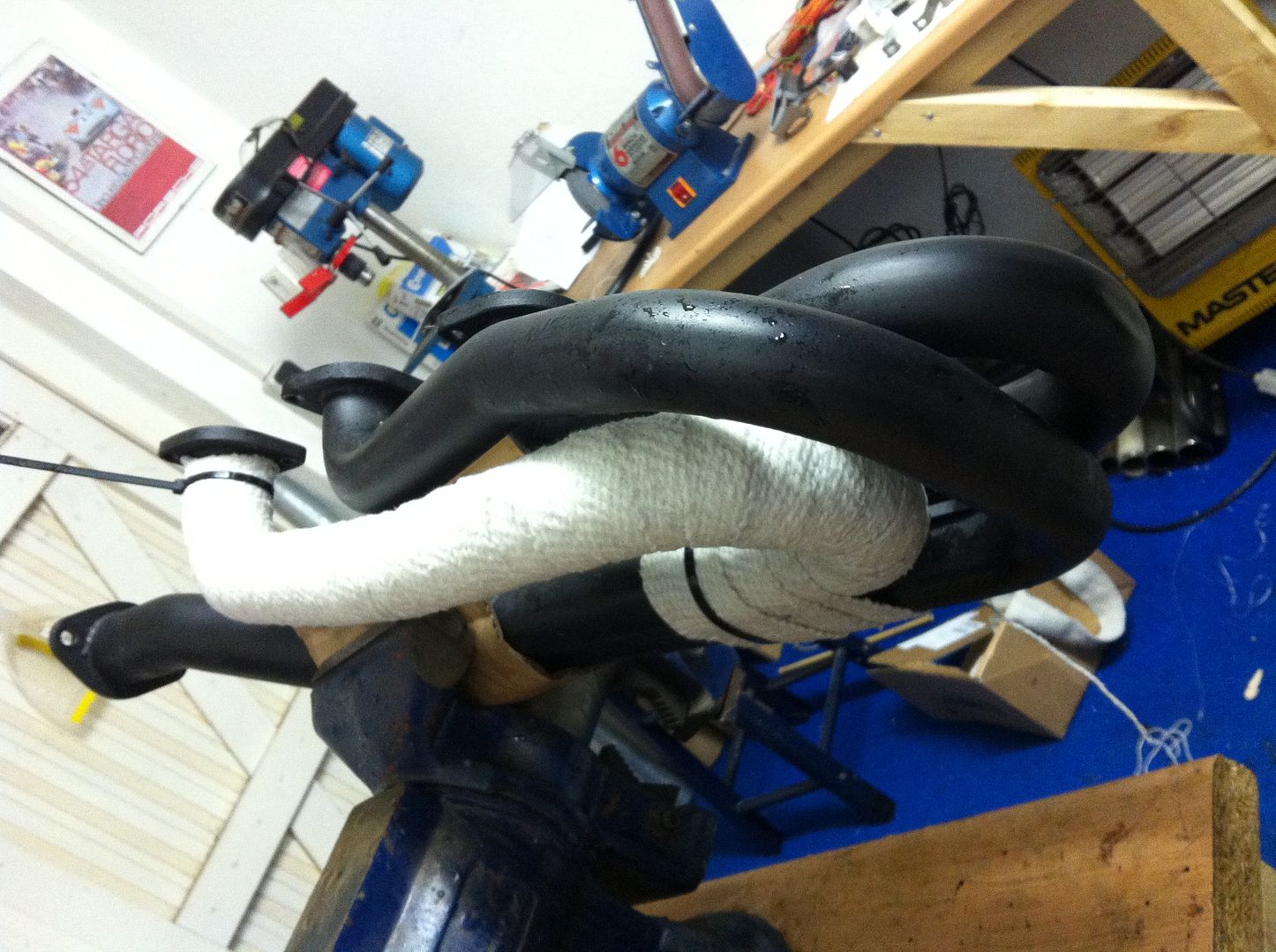

Heat wrapping Exhaust Headers, not something I want to repeat soon...
Happy with the result though...

Was it hard keeping the heat wrap pulled tight as you got to the joining of the pipes? Were you constantly wrapping and unwrapping and then rewrapping to keep the tape tight?

The wrap is not that difficult to put on, it is just abit annoying. Basically you will need twice as much as you think, and it will take twice as long.
Before starting it is worth PLANNING your route and direction of travel. Start at the engine flange, you will then find that you will need to switch from wrapping a single pipe and then start wrapping 2 pipes. Hold it in place with a temporary zip tie, and then start the next pipe. You will then overlap the area you have just done, remove the zip tie and then continue, when you have finally finished use metal exhaust ties ( I hope that makes sense )
It is recommended that you wet the wrap first which helps mold and shape it, I soaked the roll in warm water for 20mins before starting. Basically you cannot put it on tight enough, and yes you will find that you constantly need to wrap and un-wrap abit to get it tight, especially when you go around the bends....I managed to twist the wrap whilst it was on the pipe, abit like giving someone a 'Chinese burn' which tightened it up
I used 50MM wrap, 25mm is available which would go around the bends abit better but you will need a lot more.
As with all things, patience is key
