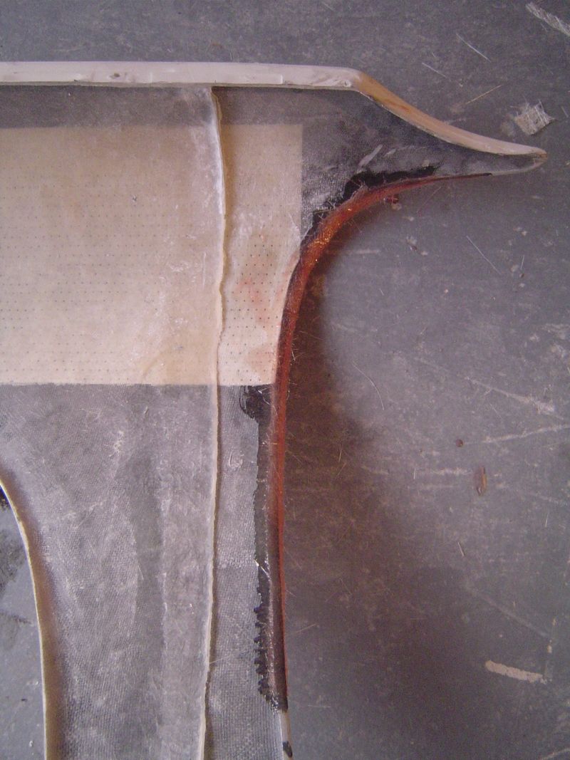

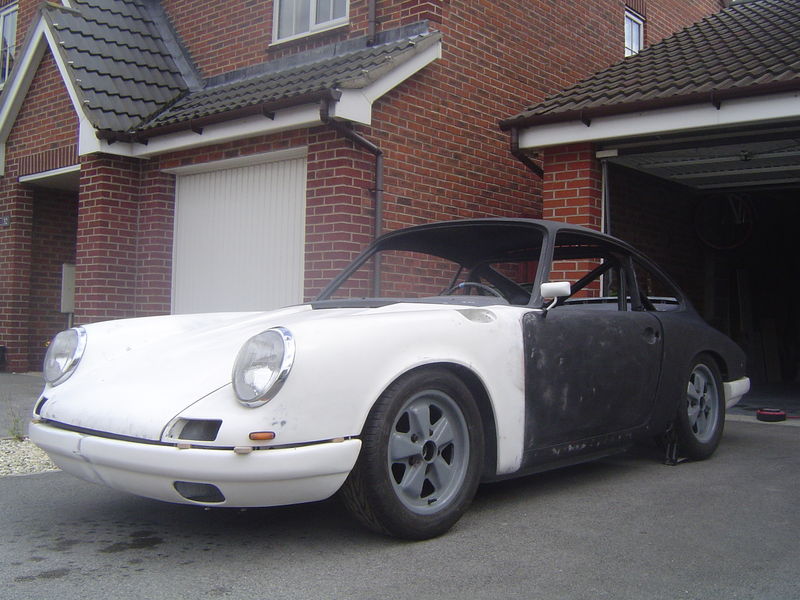

For some reason the front bumper sat about 3 inches too wide on each side, so after alot of head scatching the only option was a cut and shut job! I cut a section out of the middle, braced and then fibreglassed over the backside of the join...

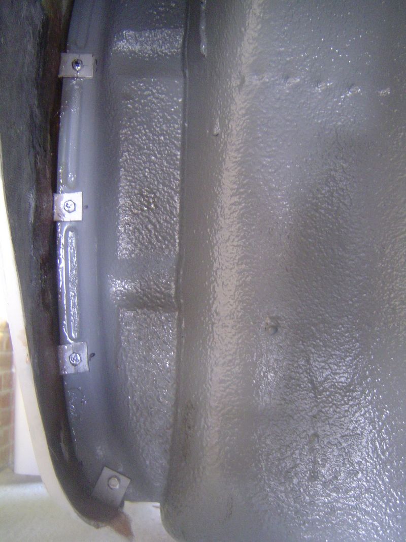

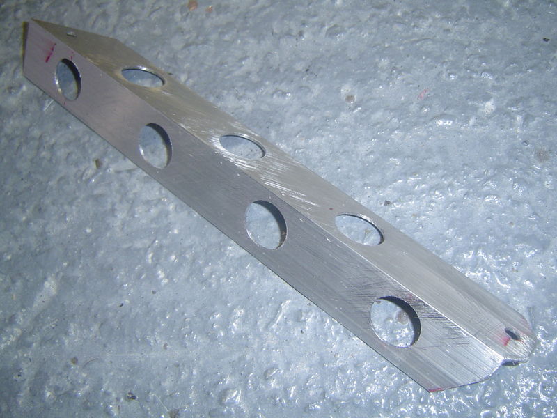

The panel gaps are all over the place, especially where front wing meets door. Alot of this project has been trial and error, and sorting this area is no exception. I built up with fibreglass on the topside and marked the gap then built up on the backside. the brace bar on the back was way off so I decided to cut it off and then fabricate some brackets to attach onto the chassis, its solid and kinda looks lightweight!

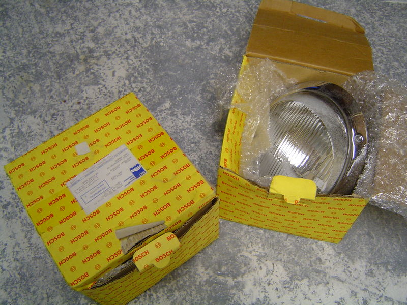

Got some nice H4's sent from a friend in the states, and they fit surprisingly well. Made up some small brackets which are pinned in place and will be glassed over later. Picked up some small indicators which are smaller than the 'R' units but I am happy with the look, its starting to get a face

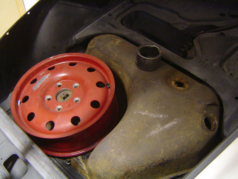

Next big job is to sort out the petrol tank and the idea is to have a centre fill cap. I have an early tank, but the later style fits ok and has the larger/flatter top surface which will be better to but the larger centre pipe in. Need to do some measuring and re-measuring and measuring again...Next step is to plug the welder in, I had to leave my trusty Lincoln behind in the US and haven't fired up the new one yet. Had some electrical problems with the house but maybe this weekend I'll give it a go....

Fibreglass fitting finished just need to fill afew holes...looking good in the daylight but probably need to adjust the ride height alittle
Bracing bars to support the wings are maybe abit over worked but look kinda trick...
Any thoughts on the mirror? I like the idea, and it will be body coloured but maybe its abit too "Fast and furious"
Decklid 'grill' mocked up, plan is to do this in clear acrylic...

I'm just a bit stonished that you had to cut off a part of the spoiler to be able to install it correctly.
But the issue has been solved as i can see , what a job !!!!

1. Make it a flat six. you already have a sweet 4banger in the driveway. I'm sure you'll have more fun in the true 906/911R spirit.
2. Lose the mirror. just my opinion. the car is so well put together and VERY tasteful, I think you should top it off with all the right (period) details. Talbot or a proper durant.
3. color is going to be a whole other debate, but IMO it should definately 100% be non-metallic. Slate grey would be my choice.
4. You're amazing keep up that stunning work!

1. I hear ya. Still thinking about engine specs, the only thing hold me back from a screaming flat 6 is the $
2. Yeah gone off the idea, Durant is ordered on on its way.
3. The colour is going to be non-metalic, afew shades lighter than slate grey, have a look at the fuchs'. Wheels and body are going to be the same colour.
4 Thanks

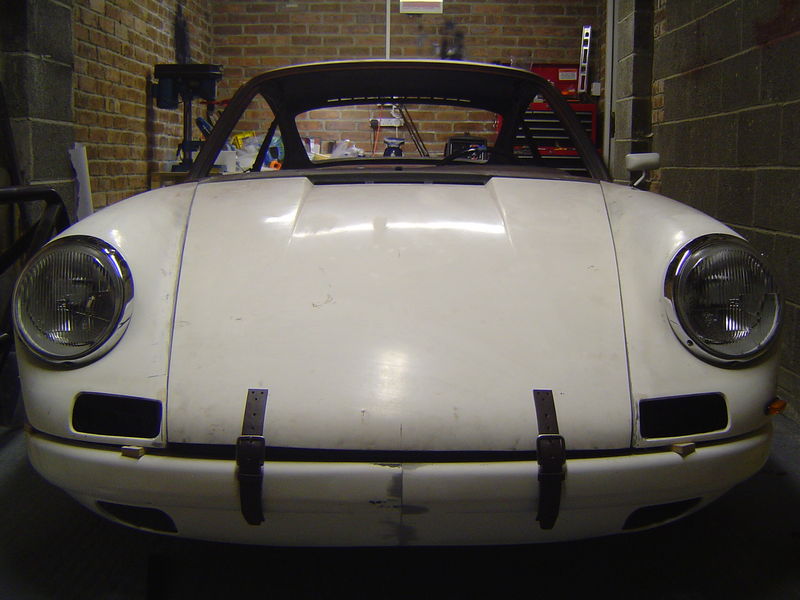

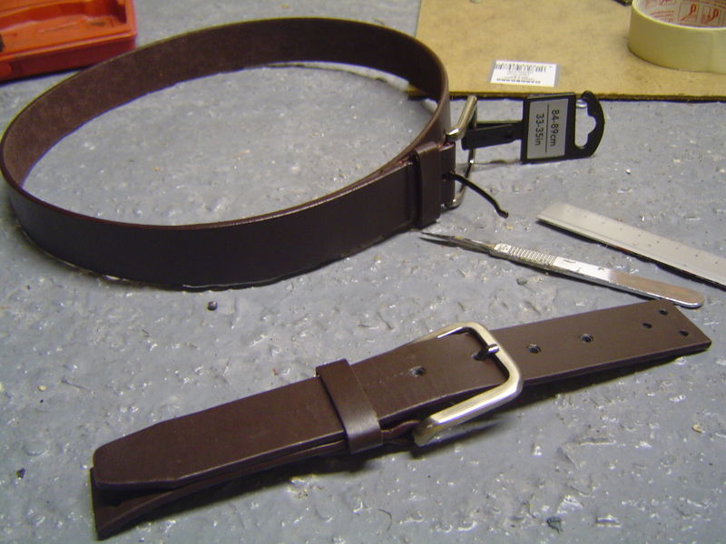

Made up some bonnet tie downs. I had got some rubber 'RS' style hooks but can't get the mounting plate to fit correctly. So went down to the local "everything under one roof shop" and picked up some leather gents belts and made up some leather strap tie downs. Think it gives a nice alternative look, normally seen on 356 outlaws...
I know that one of the 911r prototypes had leather straps between bonnet and wings. I thought of trying this but on my car the combination of fibreglass hood, wings and drilled out hinges has resulted in a slight twisting of the bonnet. So I have fitted the straps over the bumper, this will straighten the bonnet out once properly attached (only double sided tape at the moment), and in my humble opinion looks better balanced...
Rear strap needs some tweaking but should be sorted with the use of a luggage strap hook to guide the strap...just a shame that the license plate gets in the way
