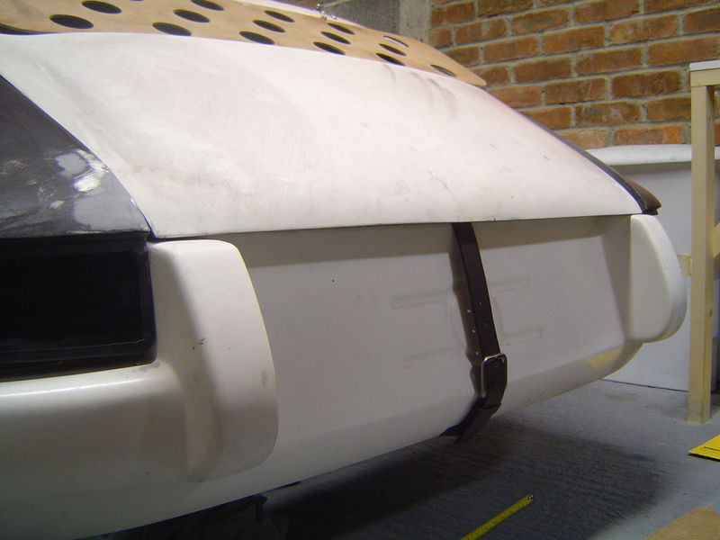

Originally Posted by jury View Post
Rear strap needs some tweaking but should be sorted with the use of a luggage strap hook to guide the strap...just a shame that the license plate gets in the way
Thanks
Chris
Chris, your car is really taking shape. Going to be a killer. I wasn't sure at first about the leather straps, but think it is going to be killer in the end. One suggestion if you have not already thought of it: fab up a mount for your rear plate that moves it off the body a half inch or so, that way the strap can just slide under it.

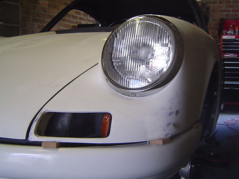

how about moving the turn signal lights, from their side location, to inboard the air vent? The original "R" turn signal light location looks so tacked on. Combining the two together would be a subtle difference and might make the nose/light design look a little smoother?
Regardless, amazing work!

Originally Posted by 911jettat View Post
Since incredible skills are on display here...
I think the reason they are positioned where they are is that is that the signal lights have to be visible from the side of the car as well as the front.
Yep, I positioned the indicator lights in the vent holes at an earlier stage, and it does look cleaner (also thought of using 356 lights and using the running light as the indicator). However the legalities mean they should stay where they currently are, and I don't mind them there ...
On it
I have some nylon spacers that will offset the plate about 12mm...

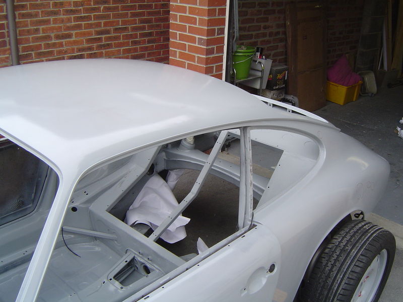

Procrastination over...let the painting process begin.....
I came across this painting method in the U.S and have seen it first hand. The results are amazing all things considered and there are a number of reasons for doing it. The method involves, amongst other things, a high density foam roller, a tin of 'Rustoleum' paint and thinners and some patience, basically I am painting the car with a roller (but I have cheated and used some rattle cans also). The main reason for doing this honestly comes down to cost, so far it comes to about $50, I like the idea of investing the money saved into the suspension (which is already all poly bronze) and Engine etc. The colour palette is abit limited but the RAL 7001 available is perfect for me (the wheels have been powder coated to match). In hindsight the car will probably never really be "completed", so I am willing to give this a try. I'd hate to spend thousands on a paint job only to re-weld or re-modify something further down the line. As long as the paint is solid I am fine, and first impressions look great...
First coat coat went on last night, I wanted to get 2 solid coats on as a good base to sand back. I left it over night and this morning wheeled it out to see the results.....so far so good...
The basic tools...
Some nice reflections and highlights already...
2 coats down, roughly another 8 (and abit of sanding) to go.....
