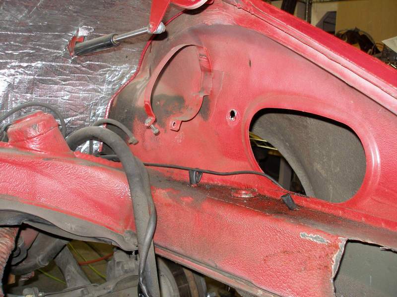

I'm in the process of cleaning up my engine and compartment while the engine is out. The carbon canister is just flopping around in the compartment with no mount, and it looks like crap. Is this thing necessary? What is the danger of not putting it back in?

it's hooked up to gas tank vent.
other lines tucked up under front left fender.
Summit + others has gas tank vent check valve units that shuts off gas flow in case of a roll over.
many pelicanheads have done this mod and posted pics and info somewhere in "search".
if you find the threads post them

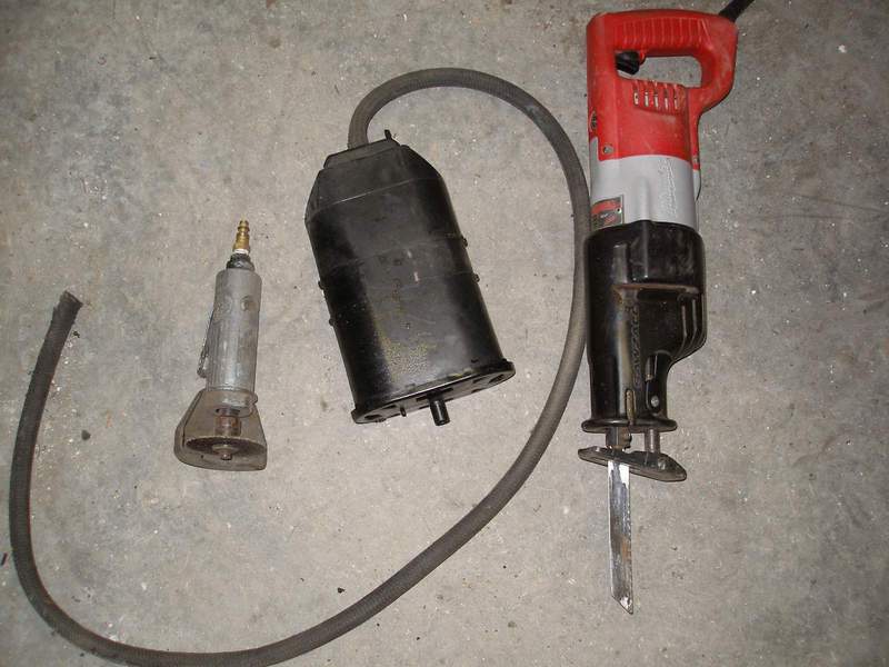

I've got a Engine Compartment canister from my '82 SC parts car I'll sell you cheap, I think you had inquired about other parts from me too once upon a time.......PM sent to you.

Ok...im a little confused as to what cannister we are talking about keeping. I know there is some cannister in the front left fender that is connected to the gas tank.
There is another cannister in the engine bay that is mounted on the right side wall, just above, and to the front of the oil tank filler neck. This cannister basically filters the crank case vent. There is a hose that comes from the crank case, just to the left of the airbox, and goes to this cannister. After going thru the cannister, the return line goes to the airbox just above the originating crank case vent opening.
I too have wondered if I could just run a hose from the crank case vent to the airbox. this would greatly clean up about 6 or 7 feet of hose.
any thoughts on this cannister as opposed to the one that handles venting of the gas tank?

engine bay item = carbon canister; found in F trunk on LH side in early cars; moved to rear by at least '75
small squarish empty tank below cowl behind tach
and
empty tank in fender
are both also needed for fuel overflow and vapor control

I've got both front and rear for sale cheap if anyone is interested PM me. I take paypal........
Lots of other parts from my 1982SC getting parted out for sale too, just ask.....

Hello Rusty Heap,
I am interested in the carbon canister you show next to the sawzall..... Do you still have this part?
