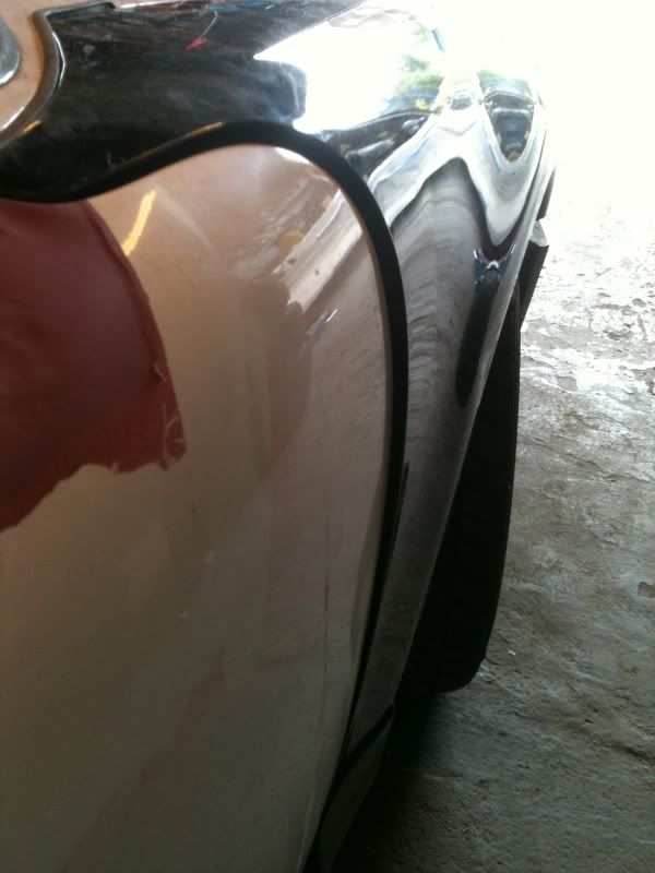

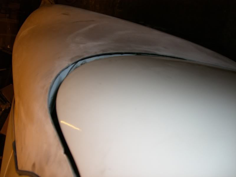

Can anyone tell me whats up with my fender to door fitment? :confused: I started out with fiber glass 993 conversion fenders that should bolt on to 911 body. I thought the fitment was bad so I bought a set of used OEM 993 turbo fenders so I would have a perfect fit. Only need to raise the body to fit the mounting holes. Turned out they was just the same as the FG fenders. I can't think of any way to adjust doors since they fit on top and bottom, but the fenders has a bigger curve than the doors....
same both sides. the body was a original carrera with oem parts and perfect fit everywhere.

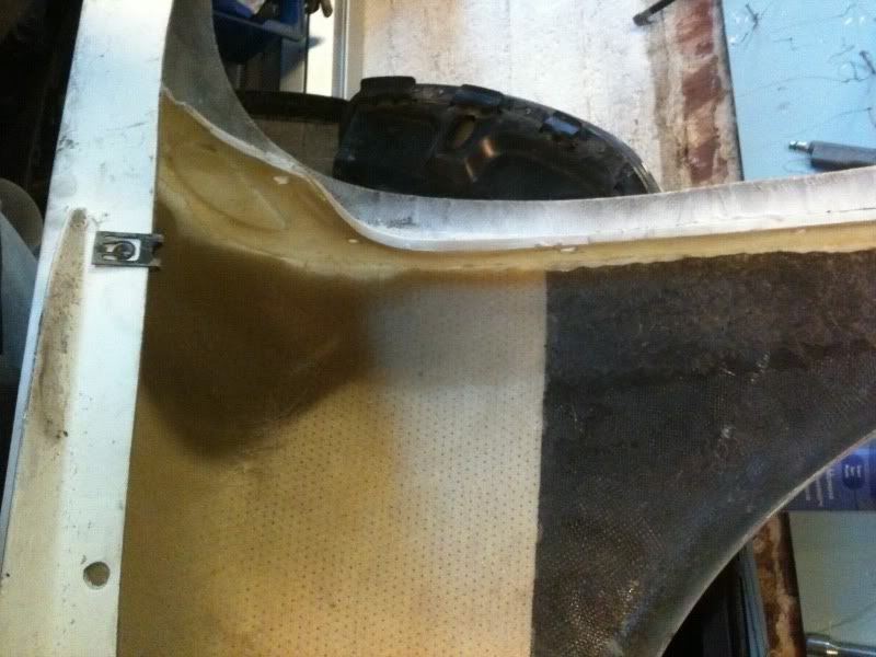

swoodard23 06-03-2011 06:38 PM
I shimmed my fenders to fit the contour of my door and then fiberglassed a flange to the stock fender mounting surface. It made the fender more rigid, improves the mounting, and holds the shape correctly. I do not understand why these fenders do not come with the flange already installed or maybe my kit was incomplete. I bought it used.

My fenders have flange and should bolt on. They do bolt on but not with a good fit......
http://i32.photobucket.com/albums/d5...2/IMG_0451.jpg
I was thinking I could cut of the flange and make a new curve that follows the door, but when the OEM fender is the same I wounder if there is something wrong....?
Please let me know if anyone have had similar issues or if it was a clean fit.
