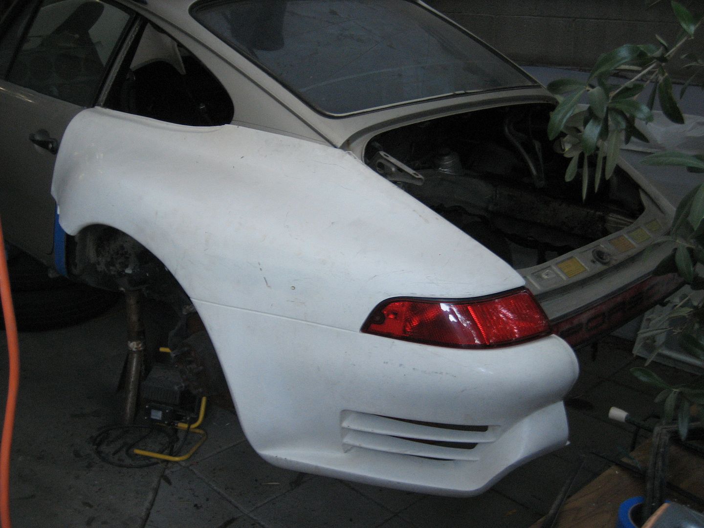

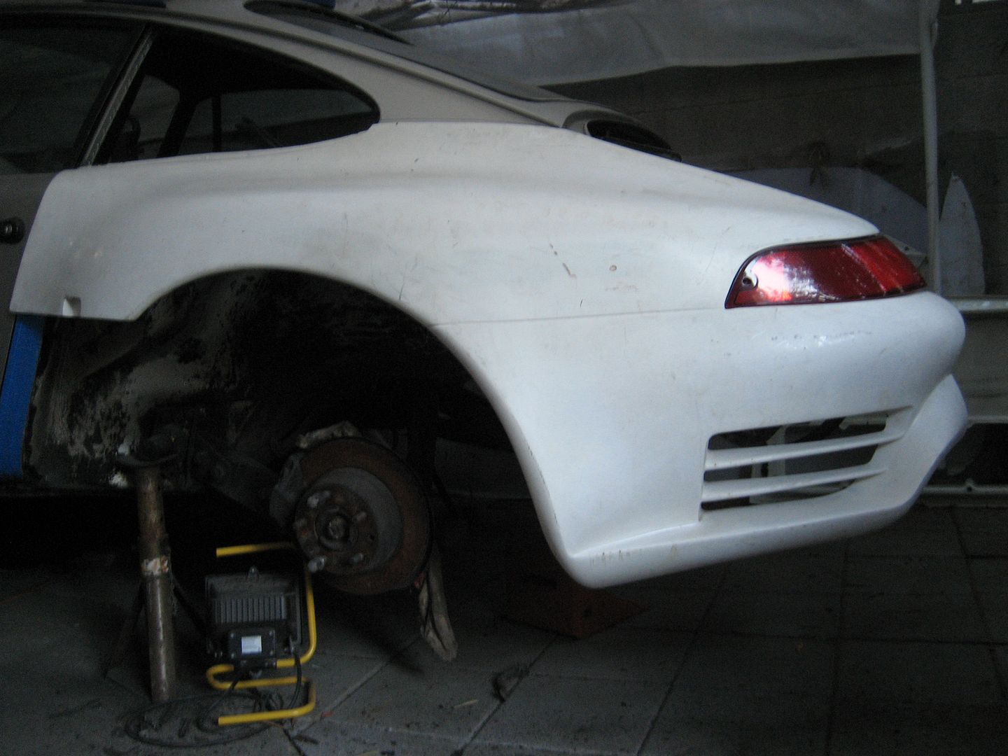

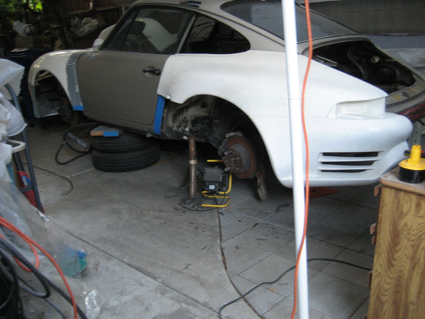

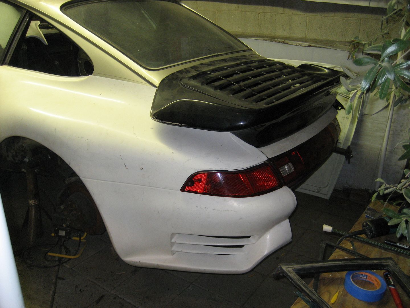

cudabnu 03-27-2009 10:16 AM
Got my Getty Design GT2 rear decklid in, decided to cry once after buying a bolt on wing from PP and it came in damaged, PP said they were discontinued and they didn't have another to replace it with, so I bit the bullet and got the built in decklid one from Niel at Getty. So if anyone wants to buy a GT2 bolt on for a 993 that need work I'm open to offers! Black one is Getty.

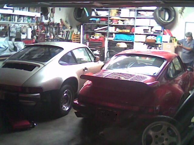

axvel 10-18-2009 11:22 PM
The start... Bringing the 82Sc on the left home....
http://i133.photobucket.com/albums/q...11/garage2.jpg
The fitting of panels, just to check the gaps

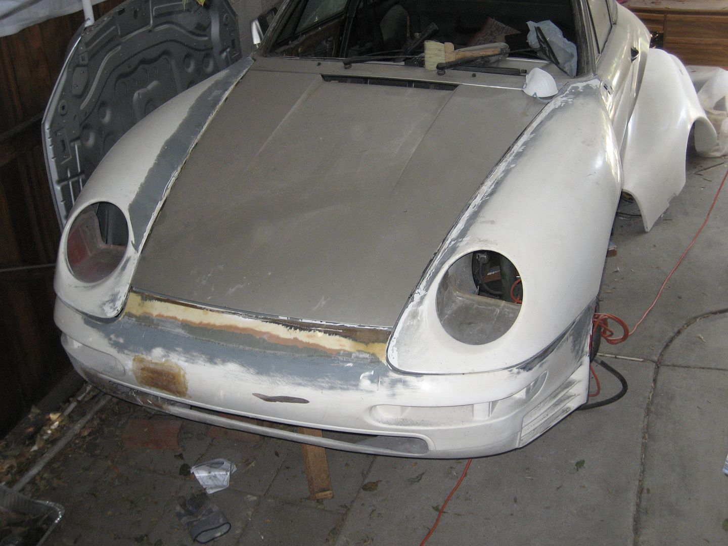

Originally Posted by Soukus (Post 4561720)
My carbon foot print just got a lot bigger :D
Got the body panels in last week and finally unpacked everything over the weekend.
http://forums.pelicanparts.com/uploa...1237811562.jpg
http://forums.pelicanparts.com/uploa...1237811573.jpg
http://forums.pelicanparts.com/uploa...1237811582.jpg
Now the fun can start...beginning with the front bumper. Did you guys trim the flange that covers the latch panel? Mine are about 1/2 inch wider on each side. I wonder if it was meant to be trimmed to fit in between the tub flanges or if it was meant to sit on top of the flange where the fenders bolt (since the hood and fender line is higher than stock).
http://forums.pelicanparts.com/uploa...1237811686.jpg
