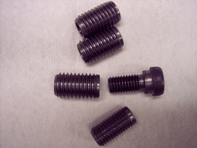

Case saver and stud question
I did use the search function, but didn't find what I was looking for. I have enjoyed this forum for about a year, and even though I don't contribute as much as I would like, I read and read and read. My 76 911s had low compression when I got the car, and had the psst psst sound when you first started it. My assumption was that the case had pulled studs, and without investigating further, I dropped the engine, and took it all apart last week.
As it turns out, I did a leak down test just before unbolting the heads, because I couldn't find any pulled studs, and cylinder number 5 just needed to be torqued down a bit, and all was sealed. So now I'm stumped.
I bought the car from the second owner. He didn't have any service records, but for the price, I didn't care. I drove the car all summer, and I am looking forward to my next warm summer cruise as soon as engine is back together. So here is my problem. The case was replaced at some time, as it has no serial number on it. It does not have the case savers in the case, and I think it would be wise to installl them. I'm in the Norther NJ area, and the machine shop that I was referred to by Pcar people I know wants 35 dollars for each one. Thats 24 head studs, plus the one through case bolt at 35 each. Thats about 900 each. Has anyone done his themselves with a drill press. This isn't rocket science, and 900 dollars is crazy in my opinion. Also I would like to know if I can reuse my head studs, or if I should replace.
Just to give everyone some background on myself, I am very handy, have great common sense, and I am an auto tech by trade. I am sure I can drill these out and install the case savers, but it's definitely nice to put the liability on someone else. Thanks all

German Precision on the west coast charges $285 to timesert the head studs. You will need new studs, not metal, either 993 DILAVAR or Race Wear. If you try to use a drill press the drill needs to be able to operate at a very slow speed to thread for the serts. Best off having this done by someone that has experience with Porsche mag. cases.

There used to be a jig you could use to drill the case for the case savers but I haven't seen it advertised for a while.

Yes it is costly to replace all the threads. However, I think the stock studs are OK. I had all my threads replaced, and I bought ARP studs, but I didn't have to. Getting it done right is not always the cheapest way. Besides, if you mess this up, you are pulling the motor again, and the block may be junk. Pay once for good service and be done with it.

So I have yes for using old studs, and yes for replacing. I am trying to do this right the first time, but I'm not the type of person who says while I was in there". I am doing thisrebuild on th cheap. No new bearings, just a reseal and inserts. If you secure the case halves on the drill press platform, and center it perfect, then drilling them myself should be easy. I realize the risks, but the machine shop take the same risks as well. Has anyone done there own inserts?

We do a lot of 2.7 cases on our mill, you can use a good sturdy drill press. Its not just drilling the hole out but its making sure the tap is perfectly square or your studs are going to have the porcupine look. Make an install tool too: You also might want to use an 8x1.25 insert at the layshaft stud too, those often pull too:
That is exactly my intention. I figured that if i clamped down the case and inserted a drill bit that is exactly the same size as the original hole, that it would center it perfectly, then take the correct drill bit, and enlarge. Whats your take on the original studs

I think you can reuse the old studs, the original steel studs did not have a tendency to break only to pull the threads out. You will be solving that issue with the case savers. Since you are doing this on the cheap as you say, I don't think the studs breaking will be any more of a risk than the other items you will be skipping. Make sure the studs are the original steel type though and not dilavar, those did have a tendency to break. I believe you can use a magnet to check, dilavar studs won't attract it (search on this, I'm not 100% sure). As far as drilling your own case savers, I think its too risky. You really can't afford to make a mistake. You can probably find a VW machine shop that will be less expensive.

Using steel studs in a 2.7 magneseum case is asking for trouble. The old dilavar studs do break, the 993's are much better, if you don't trust those then go with Racewear.

Reading back in this thread, you don't mention having any machine work done on the case anywhere. Once the two case halves are separated, they twist like a pretzel. You have to have some machining done to the case.
I have been paying very close attention to the history of studs on Pelican. Most have agreed that the steel studs are fine. In the 3.0 motors, they recommend replacing just the dilivar studs with steel, and leaving the original steel studs alone. In the 2.7, once the block is strengthened, the steel studs are good to go. It's only the older dilivar studs that are a problem.

you won't be able to thread the drilled holes with the drill press. too fast. you need a jig or a mill. try it by hand and you will get them porcupined. the cylinder bases will be worn. they need to be trued on a mill or the cylinders won't sit on the same plane. there are 8mm studs around the intermediate shaft that need to be inserted also, especially that long one. the mainline bore in the case will be warped. it may mic out ok when you measure the individual bores, but they are not in line with each other. it needs to be align bored. if you try to use new bearings without an align bore, the crank will bind. if you really want a nice job, all these things would be done after the case mating surfaces are milled flat and the case align bored at both the crank line and the intermediate line. steel studs are generally fine, even used ones, but consider this.., mag cases are soft. that's why the studs pull. personally, i think that 24 new dilivars is the better choice with a 2.7 case, as they are designed to expand close to the expansion rate of mag/aluminum and would be easier on the case than steel. just my opinion. the heads will need a flycut and if you reuse the cylinders, they need to be trued at the head contact surface. the idea is to have all the components parallel to the crank centerline.

Studs
Just based on my opinion but I've gone with .
Remove all studs
Identify as steel ( magnet check)
Aqua blast each to spotless
Electromagnetic crack detection NDT
Thread profile inspection
Stud visual inspection for corrosion pitting.
Powder coat exposed diameter
Mill Tap and fit timeserts to all vulnerable threads in case (Bridgeport universal mill)
This all on a euro 75 S with Mag cases ( not an engine that ever had thermal reactors)
For the record none of the studs showed any sign of stress or corrosion beyond acceptable levels. The facilities I used for the NDT and visual are the metalurgical labs for very signifcant engineering installations.
BUT not everyone has access to such facilities and without the confidence such process can give frankly I would have bought new 993 studs.

epoxy painting used dilivars is not a good idea. you can bead blast them clean so they look like new, but they can still have rust penetration at the area that lines up with the head to cylinder joint and where they are exposed at the bottom of the cylinder. this rust penetration can be seen if you scrutinize the broken ends of a dilivar stud. so toss them and buy new.

I just purchased a drill press, and will be changing the pulleys to slow the speed down. Drilling in mag should be quite easy (the material, not the task itself)
