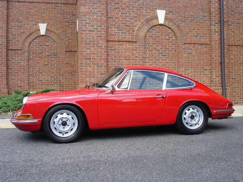

That is going to be a super cool 68 when finished...!!!
Wow, can't wait to see this car done considering all the work you are putting in to it. Nice to see this one being saved and improved upon! Here is my contribution to ideas. This is my 68 912 that I am having a blast driving. Had the 15 x 6 Fuchs on it at Road Atlanta but have always had a soft spot for the steelies on these cars. With a slight nudge from some friends (namely Farrell, but Jerry and Tom too) I returned back to its roots and removed the Fuchs and bolted back on the steelies. Back to the basics as they say and in this case, imo less is more. Hope you continue to post progress as I am enjoying the transformation. All the best, Craig
