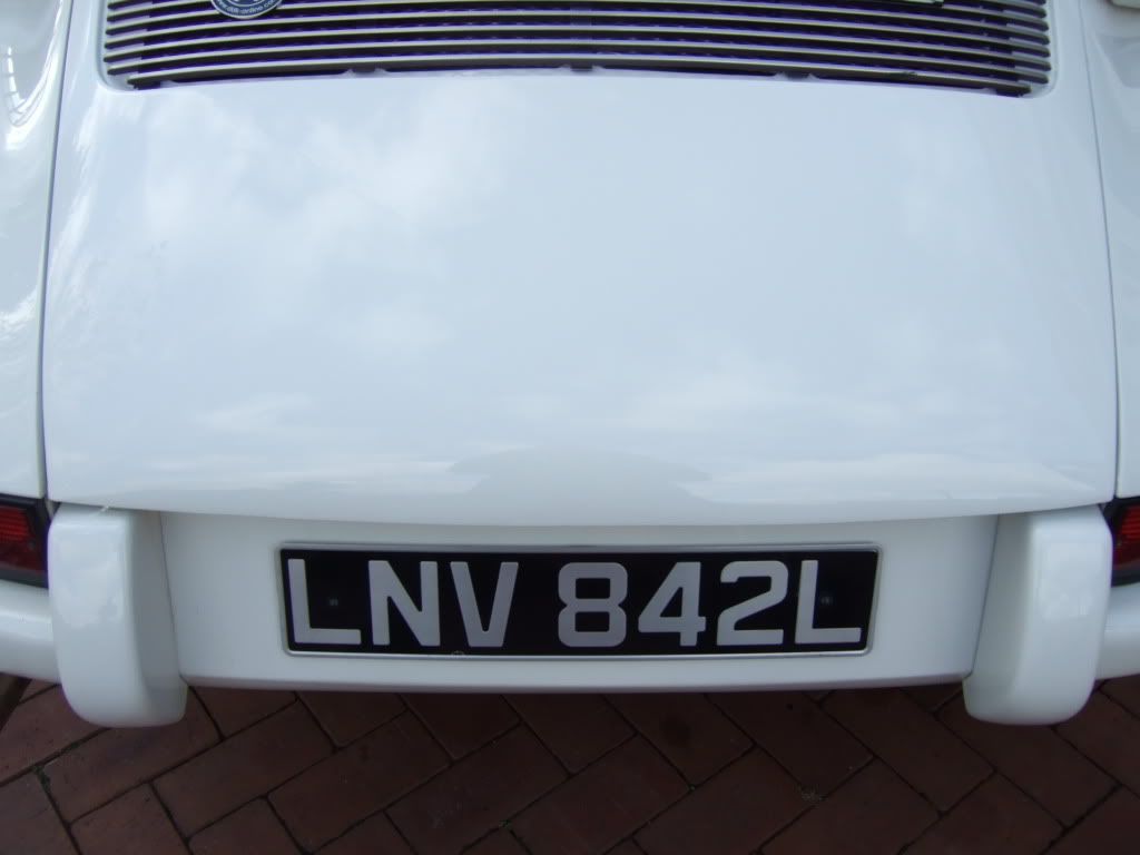

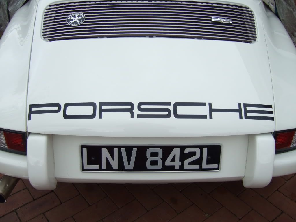

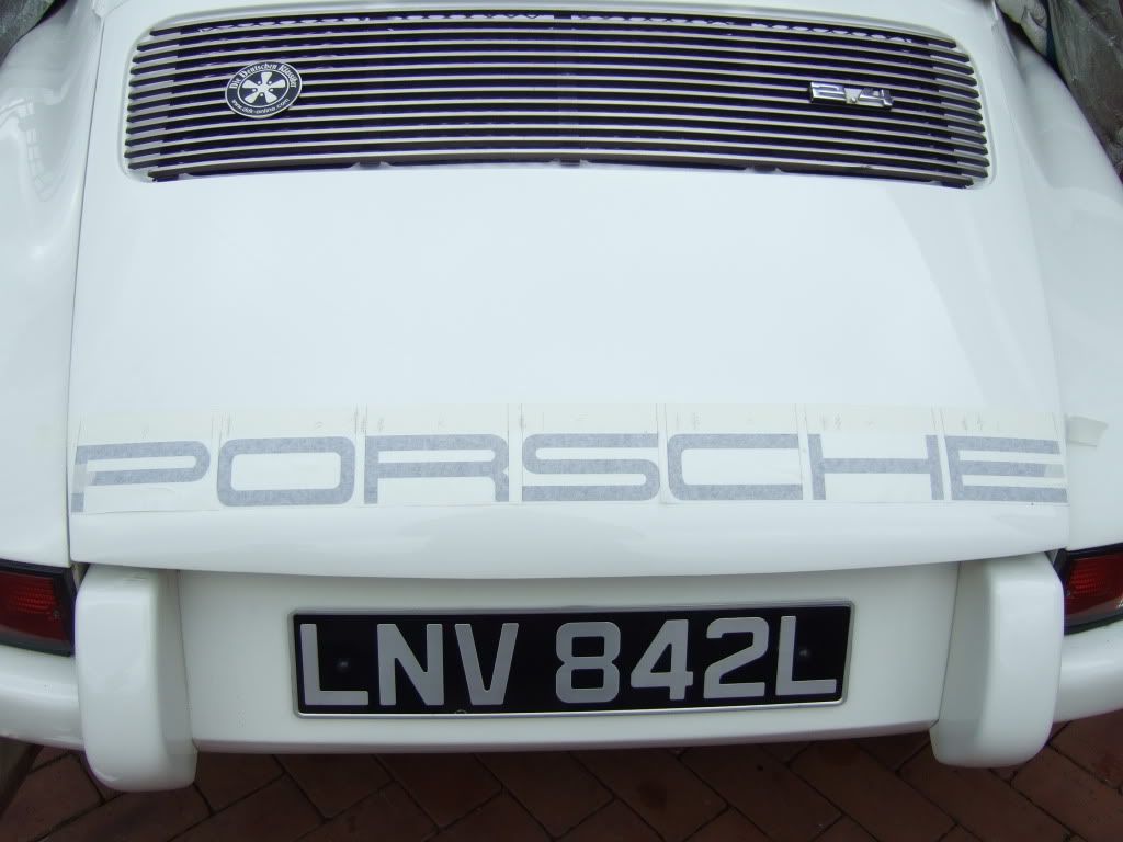

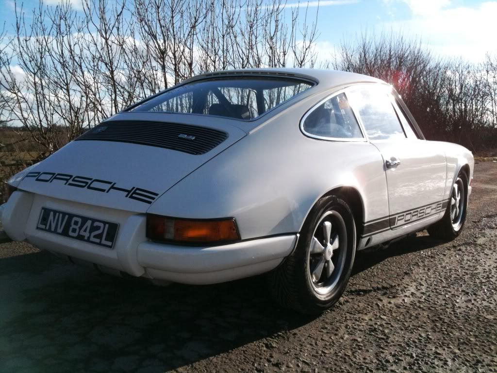

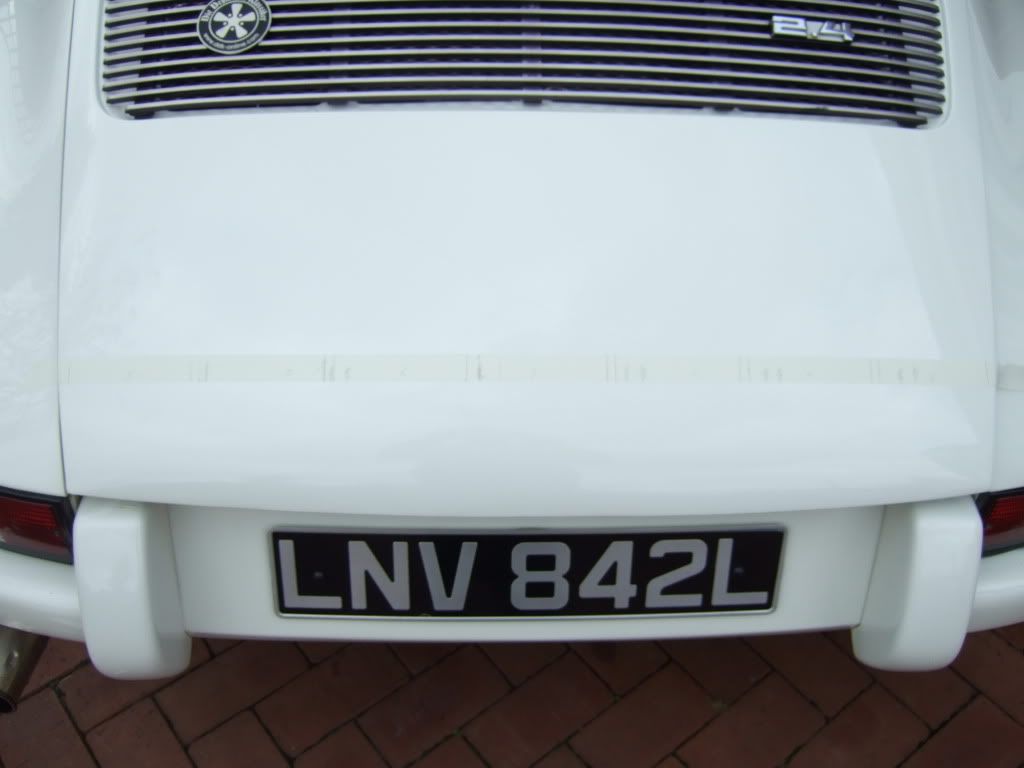

Following the post by MikeB over on DDK, I decided to get out there today and do the engine lid PORSCHE script.
However, upon opening the script, I found it to be 36mm too wide !
So I used Mike's method of marking the letters on a piece of tape, but then moved each letter 6mm to the left, thus taking out 6X6mm = 36mm.
As you can see, it was a case of measure twice and fix once, but well pleased with the result.
Here are the individual letters cut and re-applied in their new position before peeling the backing from each and sticking down.
Next it is the side script.
Ian

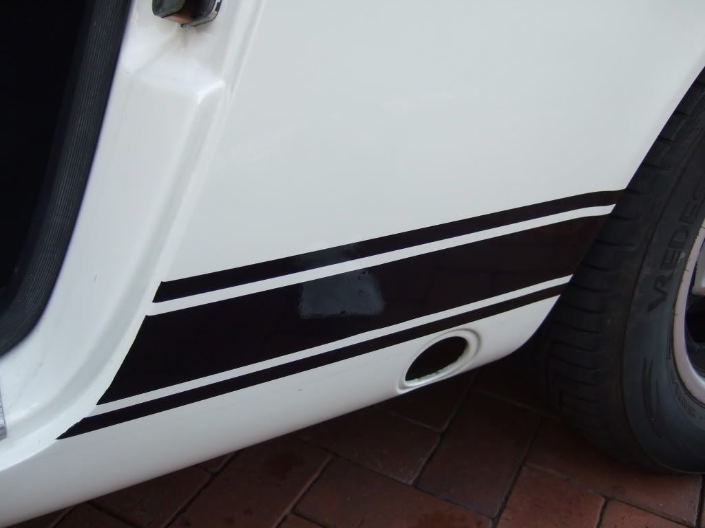

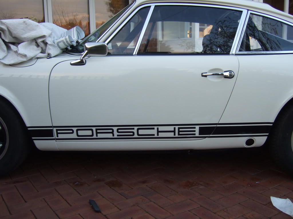

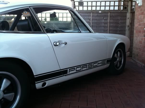

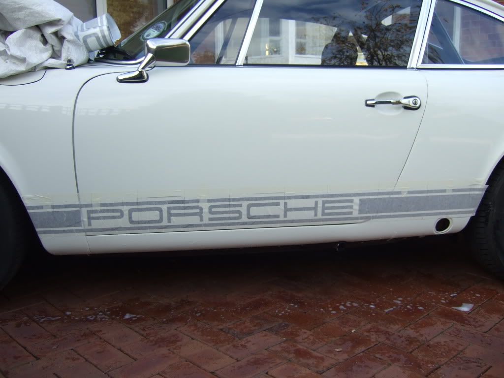

The side script was applied to a wet door panel, as there was no way I was going to do it direct.
Getting the measurement and position took ages, but eventually I applied wet and then pressed on and use da hair dryer to thoroughly dry before removing the top covering.
This was a pretty tough job, and there are a couple of small air bubbles but it is OK as it stands.
I still have the RH one to do, and the bumper stripes (but I will sleep on that decision).
I just hope they stay stuck down !
Ian

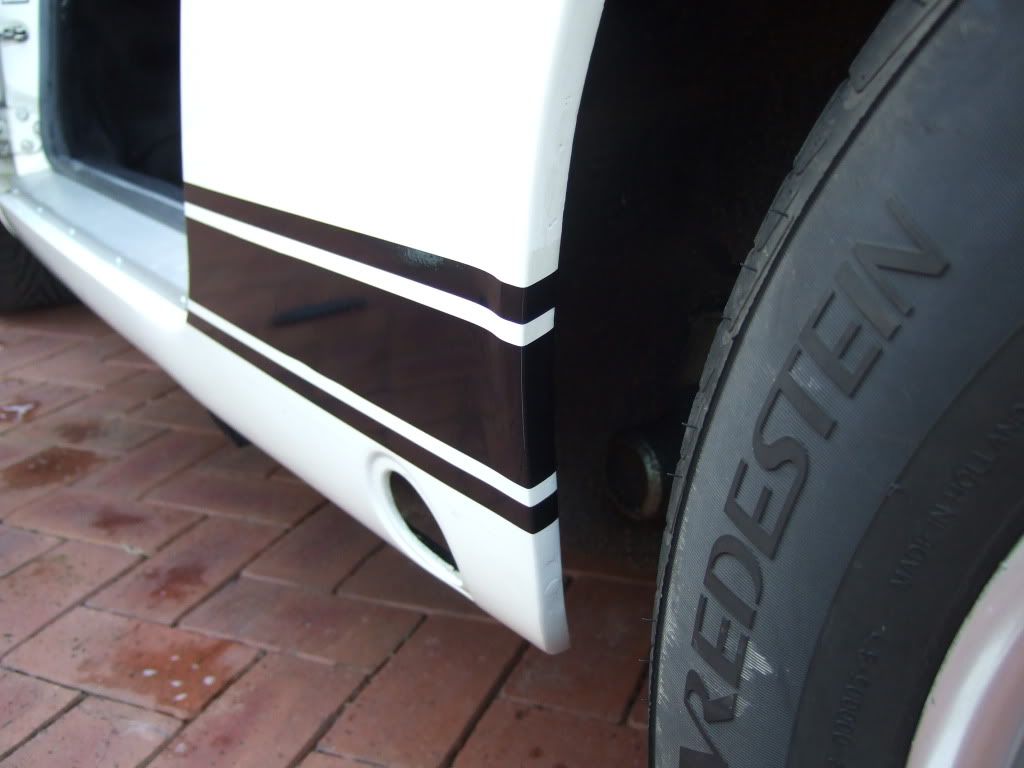

Posts: 28
side scripts

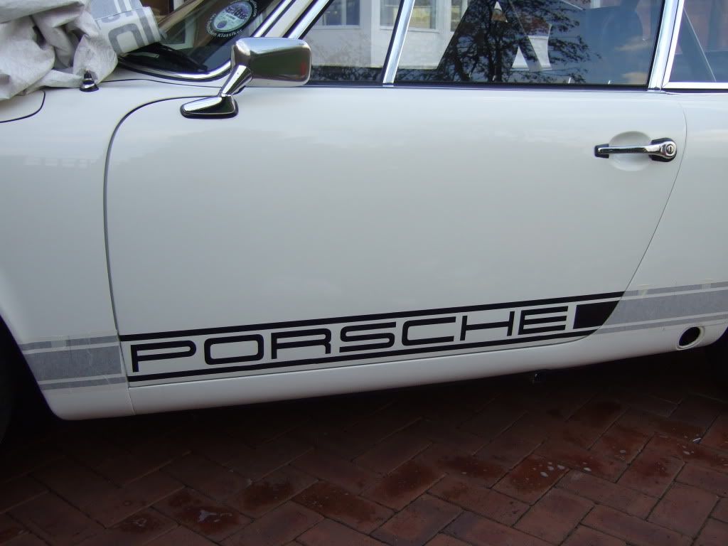

Ian, Nice job all around. That looks great. Here is a look at my '73 T with the bumper stripes also applied. I had to go with red to match the interior. Cheers. Mike.

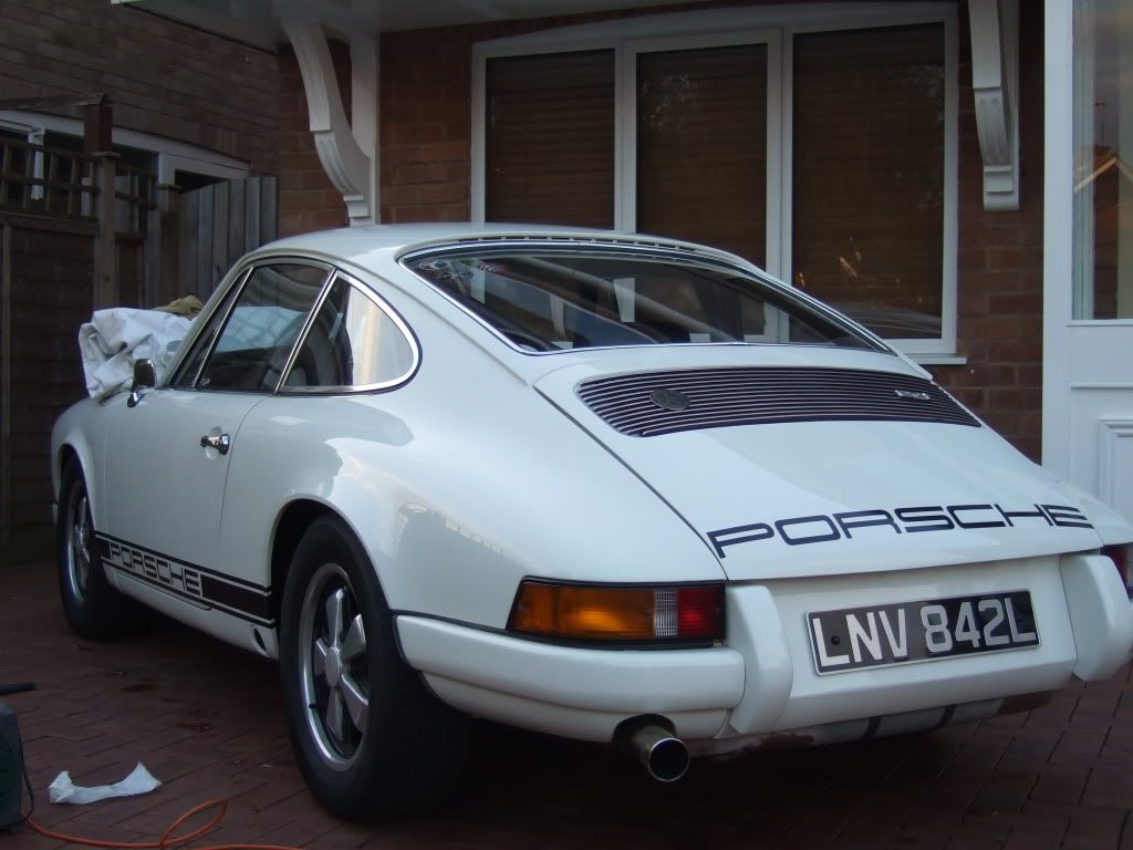

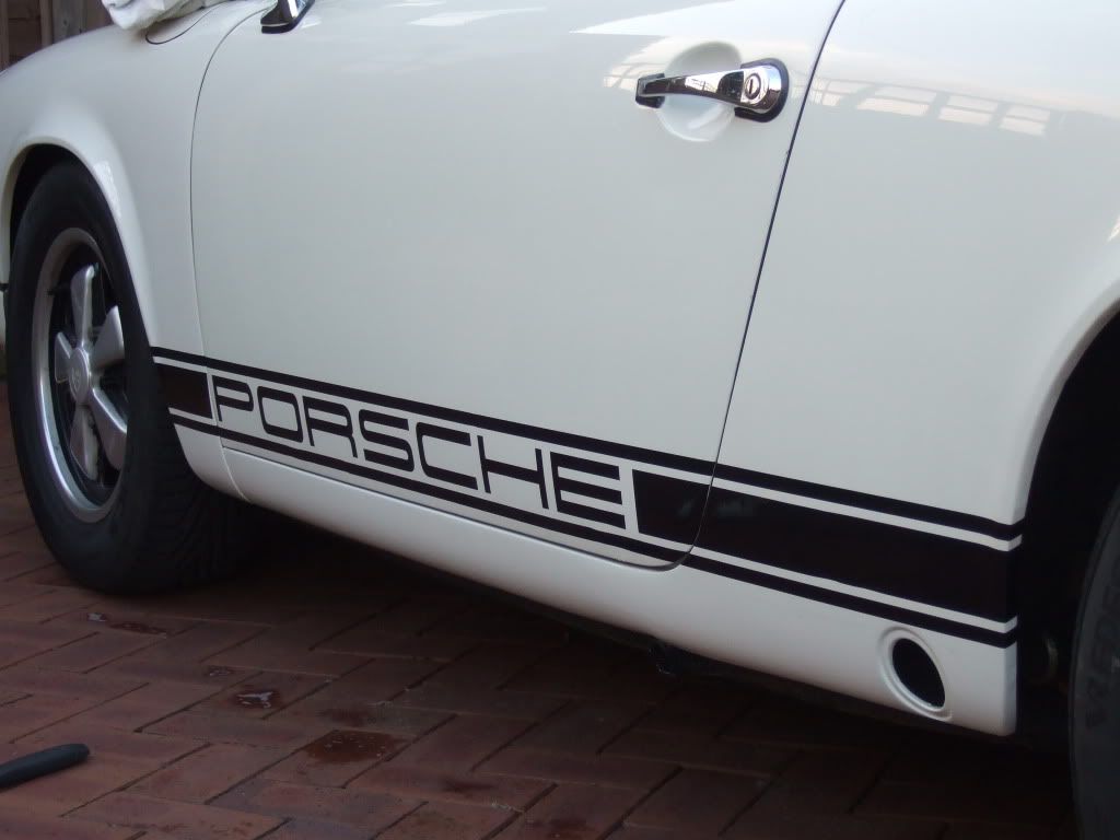

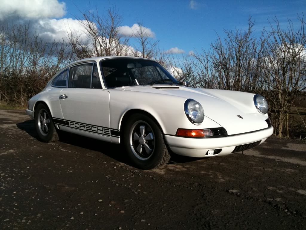

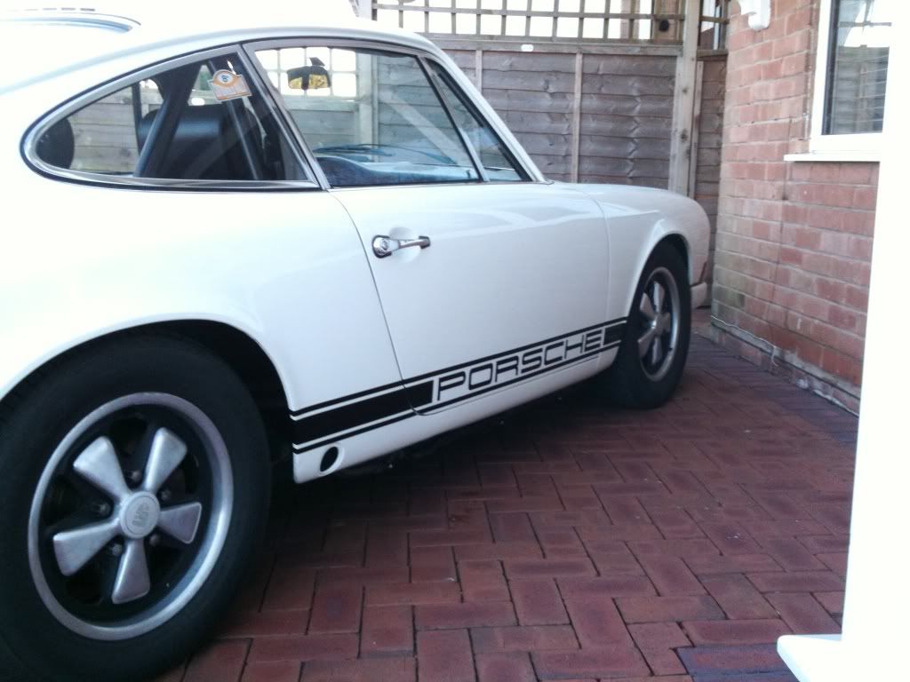

Finished off the right hand side today and then went for a run out in the Cotswolds.
Stopped at doing the bumper stripes as I want to see how I feel about it in time.
Ian
