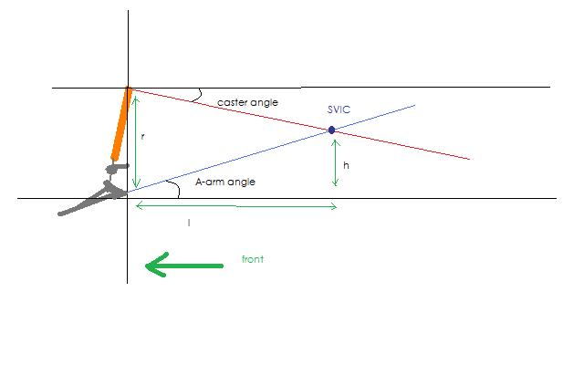

Hi, There has been a thread going about anti-dive suspension dynamics over in the Turbo forum but I think it would be interesting to see if anyone here can make some measurements or calculations regarding the amount of anti-dive effect felt when switching from a 911 to a 930 front suspension. Is it significant enough for a "good" driver to notice? Will it help handling all that much or just change its style?

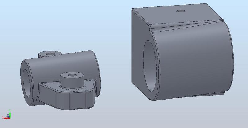

Would there be any interest in making some custom A-arm bearings that provide anti-dive geometry? They would be Teflon-lined steel sleeves and Aluminum mounting blocks. No rubber, no lubrication. The idea would be as a bolt-on for a 911 crossmember to give anti-dive similiar to, maybe more than the 930.
If there were enough interest, there is a small chance I could get some made. Do not hold me to any deadlines, though.

#32
r = vertical distance between torsion bar center and top strut mount
h = SVIC height
ℓ = r ÷ (tangent Θcaster + tangent Θarm)
h = r - ℓ × tangent Θcaster
h = r – ((r ×tangent Θcaster) ÷ (tangent Θcaster + tangent Θarm))
Fanti-dive = Fbraking × (h + ½d) ÷ ℓ
d = tire rolling diameter

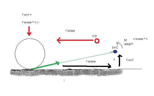

#33
Red is the inertial reaction forces and the green is the actual force from the wheel, divided into the separate components in black.
At the instant of brake application, the spring force is zero since the displacment is zero (we are talking dynamics here, not steady-state).
The Fanti-dive is the instantaneous front load transfer (added to static front weight).
Steady state load transfer (once the springs are fully deflected and the pitch has stablized) is (W/g)×H/L where H is center of gravity height, L is length from tire contact patch to the center of gravity, W is weight and, g is gravity= 32.2 ft/s^2 for pounds.
vertical Fspring = ky = ((W/g) × H ÷ L) - (Fbraking × (h + ½d) ÷ ℓ)
Spring deflection = y = b × sine(Θ)
b is the length of from the torsion bar to ball joint
Θ is the angle of the A-arm viewed from the front.
vertical Ftorsion = (k × Θ) ÷ (b × cosine(Θ))
(k × Θ) ÷ (b × cosine(Θ)) = ((W/g) × H ÷ L) - (Fbraking × (h + ½d) ÷ ℓ)
solve for Θ to find vertical suspension deflection y using y = b × sine(Θ)
Add the spring deflection to the tire deflection to get the full pitch angle. This is assuming a race car with a rigid chassis and monoball bearings with negligable compliance.
The anti-dive force is reacted through the tire "spring" because it is a part of the SVSA. The anti-pitch reaction will therefore be delayed by the amount of time it takes to squish the tires, at which point the main springs will come into action to stop the roll.
#37
I made a clarification to the above post regarding spring deflection.
Both the anti-dive force and the braking force are transmitted through the SVSA, which includes the tire "spring". The tire will be deformed by these horizontal and vertical forces in a somewhat elastic/linear way assuming no sliding. Therefore, the braking force is delayed by the F=k1x; x = ∫ax dt lag time. The anti-dive is linked to braking force so once the anti-dive starts, there will be further vertical deformation of the tire to generate the vertical component. Fanti-dive = (k1∫ax dt) × ((h + ½d) ÷ ℓ) so vertical deformation y = (k1 × (h + ½d))/(k2 × ℓ) × ∫ax dt
Since the acceleration is not consant, one uses integrals. Since the tires are very hard to quantify, being a "black art" of mysterious non-linearity, the k1 and k2 spring rates in the horizontal and vertical directions. are not known, nor are they likely the same.
Anyway, that math right there is just to show that anti-dive and the anti-pitch reactions will be affected by tire pressures and stuff like that.
