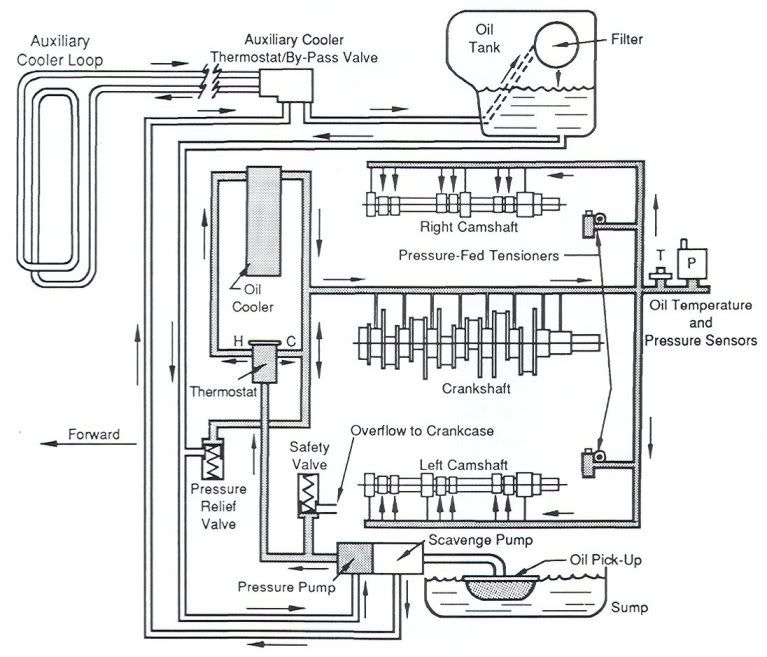

Hi there everybody!
Been a while since my last post here now.
This time i have a question about the external oil thermostat.
It seems like my thermostat does not open. I have cold pipes going to the front oil cooler, and really warm pipes on the "inside". (Pipes going to oil tank and engine pipe.) The temperature reading on the instument in the front of the car goes to about almost "10 o'clock". Also, I have replaced the temperature sender, because I suspected that first. So I know I have the right reading. The thermostat used to open at below "9 o'clock".
Look to this drawing for reference:
The thing is:
I have already opened the thermostat. (which is only two years old)
I checked for sliding resistance for the piston. The piston fell out when i tipped the housing over, so I guess that's fine.
When I tested the actuator inside the slider piston, by putting teh piston in boiling water, the actuator came out when the water was barely boiling. But, when I took it out of the boiling water, and pushed on the actuator with my finger, (wearing gloves), it felt quite easy to push in again. At the time, I just thought "It probably gets cold really fast, making it retract again".
So I assembled everything, and went for a test ride. The dial in the dash was at almost "ten o'clock" after ten minutes of driving. And the pipes going to the front oil cooler was still cold. In other words: No change to what I have seen before I checked the thermostat.
Any Ideas guys?
Is the actuator really supposed to be easy to push in after it has opened?
How likely is a faulty bi-metal actuator after only two years?

Nothing bimetalic about the thermostat. It works on wax!
That tiny piece which looks like a nail (round flat head, small shaft under it) is forced out of the wax filled capsule as the wax expands with heat. It seems impossible that wax pushing on such a small diameter rod would generate the needed force, but it does.
I have tested several of these units, some of which worked, and some of which did not. Those which did not didn't budge when tossed into boiling water. But I don't recall whether I tried to push the plunger piece back in, and if so, how hard it was to push.
I have been fortunate in having oil temperature gauges which have temperature markings on them, so I don't know just what 9 and 10 o'clock represent in degrees F or C (but lots of other 911 owners do know these things). The thermostat should open at about 90 degrees C or 180-190 degrees F. So first thing I'd want to do would be to assign temperatures to these gauge readings, lest it isn't as hot as you think and that's why the thermostat isn't opening.
But if the 10 o'clock angle puts the needle up in the upper red zone, I guess it is hot.
The next thing to consider is the condition of the piping and front cooler. If it is blocked (or a line squashed flat), not much hot oil will circulate.
I would agree that a new thermostat (or its innards) should work well for more than two years.

Thanks for the input. Amazing that wax is used for this...
I guess I'll need to measure the oil temp exactly, but in my mind I'm pretty sure it's way hotter than normal.
I am talking about the external thermostat. It should open when oil going through it gets over 83 Celsius.

Failure mode, for both the thermostat in the engine, and the external one, is closed. Which means oil doesn't go to the cooler - either of them, depending on which thermostat.
The operating part - the capsule which encloses the wax - is the same for each one. However, the external thermostat also has a pressure relief valve included in it. The large round "nut" is for the thermostat part, the smaller one for the pressure relief.
In addition, at least as to the external thermostat, it is designed to allow cold oil to pass up to the front of the car, and back. I think it does this by being basically open in each direction: to the cooler, and also back to the oil tank. When the oil is cool, it will preferentially flow back to the tank, as the line resistance is much lower in that direction. Because it is a lot shorter.
That way, when the thermostat closes off the more direct path back to the tank, the pressure doesn't go way up trying to push sludgy cold oil all the way through the long lines to the front, through a cooler, and all the way back.
I think the same thing happens with the thermostat on the engine which directs oil through the engine mounted cooler or not. Though I am not entirely sure of this.
So, no - removing the thermostat internals means as little cooling as possible, I think.

Without the regulator the oil will not go to the front cooler.
There really are only 3 failure modes for the external oil cooler.
1 - the cooler / lines are plugged up
2 - the pressure relief piston is stuck open for some reason
3 - the regulator is not functioning
250 degF oil ought to make water sizzle when it hits the lines, BTW ...

You have to test the auxiliary thermostat (assembled) in boiling water. Your above test did not show if the slide valve actually opened or not. With the spring acting on the valve, the auxiliary thermostat only come into play when the oil temperature gets to around 180°F plus. Some reference manual says 186°F.
This is how the auxiliary thermostat operates:
1). Warm engine oil is delivered to the auxiliary thermostat. It does two things. Oil under pressure goes to the tank and to the cooler. Since the auxiliary thermostat does not into play until 180°F, warm oil is continually circulated back to the oil tank.
2). The line to the cooler from the thermostat is permanently OPEN (fixed). The oil fills the line to the cooler, the cooler is filled, and the return line from the cooler is also filled. And the oil (under 180°F) stops here. The return line still closed at this point. All the oil is continously circulated back to the tank.
3). Once the warm/hot oil reaches the operating temperature, the slide valve comes into action. As the opening to the oil tank closes, the return line from the cooler also opens. The cross-sectional area of the opening and closing remains the same or constant to prevent pressure build-up.
4).Valve opening examples:
From engine to oil tank: 90%-------75%-------50%-------60%............
From cooler to oil tank: 10%-------25%-------50%-------40%............
At any given temperature, the total cross-sectional areas or valve opening is maintained the same by designed.
5). Lastly, there is no 'wax' like device anywhere in a 911 auxiliary thermostat as previously mentioned. Photo of a dismantled auxiliary thermostat shown below. The temperature (thermostat) valve on the left side and the pressure relief valve on the right of the thermostat body.
6). The pressure relief valve works like most common pressure valve using a spring loaded valve to release excess pressure build up.

When you replaced the sender, did you use the one to match your gauge? (not the engine)
You could try placing the sender in boiling water to see if it is accurate.
Yes and no.
You do NOT want the valve to fail open and allow cold thick oil to go to the oil coolers when the engine is first started or until it warms up.
I work with airplanes and its not unusual to have the same sort of valve on old piston airplanes fail and when the engine speed is increased it blows the oil coolers almost everytime.
The valve keeps the oil in the "engine side" of the system until it warms up, then the valve opens up to let the thinner, warmer oil into the "cooler side" of the system. This protects in several ways.
