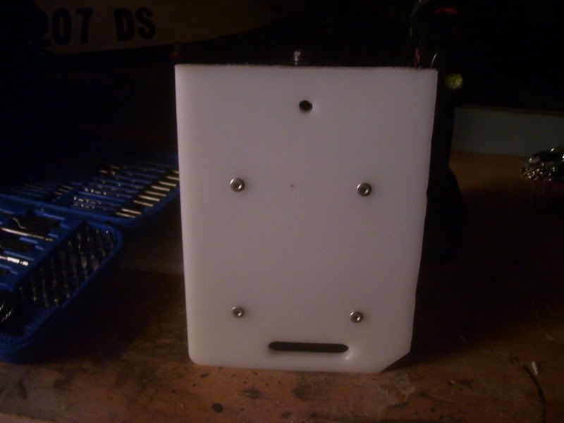

another battery install thread
like most, when i got my 911 is had an older lead acid battery that had not been connected to a vent tube. luckily the battery tray was still solid so i just did some cleaning with baking soda and water then sponged it down and dried with my air compressor. i picked up a new kinetik hc800 agm battery (750cca), a box, a cutting board and some hardware and went to town.
old battery next to the new one. i am not exactly sure how much weight was saved but the new battery weighs just under 25lbs and looks to be less than half the size of the old one.

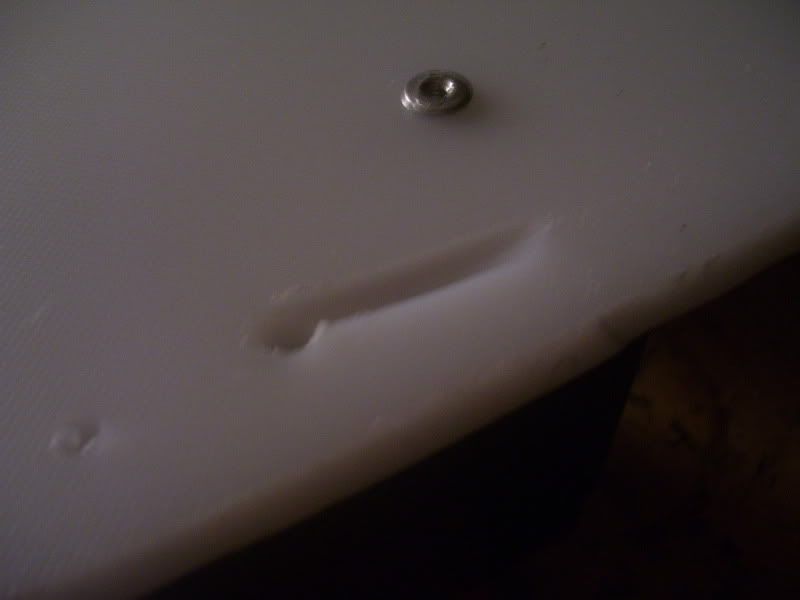

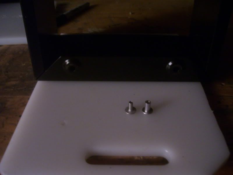

here are the nuts i used to hold the battery box to the cutting board. not sure of the technical name but it's the same stuff we use to mount the plastic windshields on race cars.
board is cut and box is mounted.
next i drilled holes for the hold down. i used my 4" grinder to cut away a recess on the bottom for the brackets to sit into.

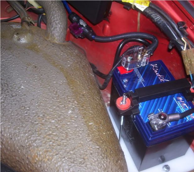

battery in box and all together
finally installed back into the car. the positive terminal i used had 2 8g set screws and a bolt on top. i snipped the ends of the 8g wires going to the battery and used the allen bolt holes. i connected the 4g line and the line for my amp to the bolt on top. snapped the plastic cover on, bolted the cutting board into the stock hole and all was right in the world.

Damn fine job, Kris!!!!
The cutting board is a cool idea.
How did you keep the "nutserts" from spinning in the holes?

Nice work. Where did you get that classy cover for the positive terminal?
thanks wayne. it was dumb luck, or maybe the slightly melted plastic around each hole from drilling, but they never moved once. i just started tightening down the screw from the top and never had a problem.
it is a battery terminal made by kinetik. there are literally hundreds of versions of terminals with almost countless combinations of set screw openings and ring terminal connections. ebay is a good place to see tha variety available, or sonic electronics. one of my favorites is made by a company called knu koncepts and uses a threaded insert to hold the wire in place. it is called the konfused terminal. they sell another style as well but i prefer the konfused due to it's range of available openings. in a situation like a 911 it would be overkill though.
https://www.knukonceptz.com/productMaster.cfm?category=Battery%20Terminals
these are the terminals i used. i got them as part of a package deal a while back in a car audio purchase i made.
Kinetik HCNBC - Battery Terminals - Sonic Electronix
i also bought "fancy" battery posts since they do not come with any when purchased new.
(12.95) KINETIK KHC-TP (KHCTP)
Power Top Post Silver Alloy Brass For Maximum Conductivity

Nice job. Looks great. Have to tell us how that battery has held up in a few years.

one year and ~3000 miles later and it still cranks up every time without a problem.
