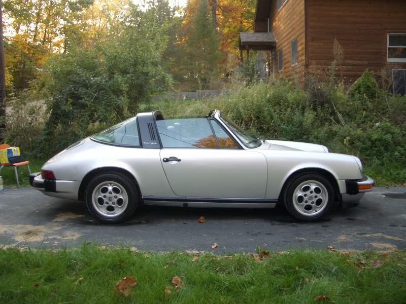

Originally Posted by DohertyCM View Post
I use the 205 50 15 for a lower stance and also the tires come in more varieties..I have the 205 60 15 on one set of rims and it provides for a taller stance...lets say a normal everyday look.
Please provide photos of both situations.
In my opinion (does not show up so much in photos) the 50 series tires look sort of like golf cart tires as they do not fill out the wheel wells. You would have to lower the car an awful lot to conceal this.
Here is mine with both.
50 series 15"
Golf-cart like.
60 series 15"
Need to roll rear fenders now because of width not height.
