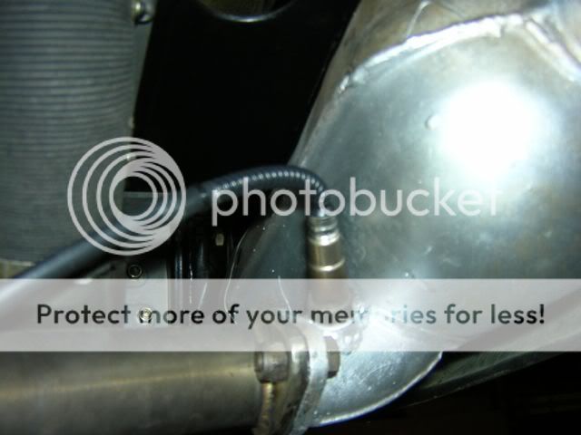

I am going to weld in a bung on the right side of the muffler, try to get 10-11 o'clock (30 degrees) angle.
It seems like the 911 mufflers channel the exhaust gas from the inlet holes, through the mid section and into the opposite side of the exhaust tip.
The only concern is routing the cable, could have been somewhat better but I am not going to weld up before I have tried a mockup.
(btw, not my pix, I just cropped and added, credit to the photographers!)

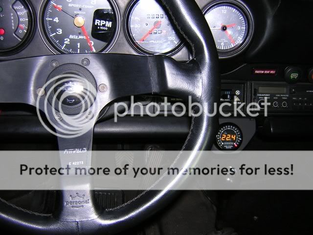

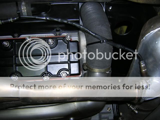

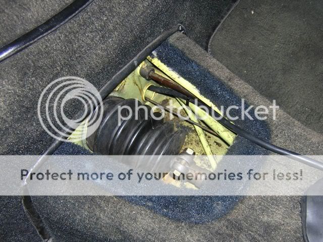

I finally got this installed.
I went with this install, the MFI does not adjust the cylinder banks individually so this was the easiest install.
Routed along the driver side, and split the throttle bellow and pulled cable through, lots of room and strapped it up and away.
Installed the gauge in a homemade bracket where the ashtray usually would sit. Both earth and 12V+ easily available. Breaking in the engine so redline 5000 rpm for another 500 miles.
Tomorrow I'll bring my MFI tools and hit the road.
