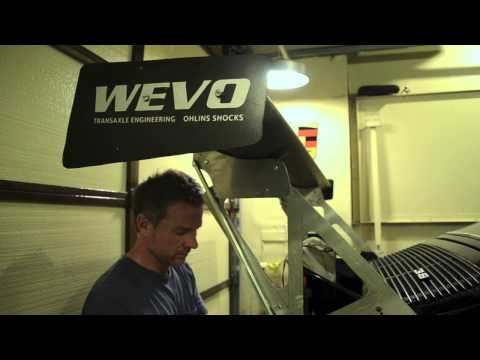

Originally Posted by Patrice911 View Post
The wing profile is from Jack Olsen Poor Man's Aero: Wingin' It
He did all the research on it, I just took the profile he came up with and it work pretty well, thanks Jack.
When I see other car with wing at the racetrack I always look at the profile and often it is kind of similar.
Well now I'm borrowing back from you, Patrice.
And reviving a very old thread.
I've started expermenting with a very simple (and pretty inexpensive) scheme to change the angle of my wing to a low drag setting on the long straights of my local track. I dug up an old sent of uprights and made a new top piece to connect to my wing. Instead of doing a single strut in the center, I'm running a carbon fiber strut up along each upright. I'm using Mazda Miata headlamp motors and it will be activated by a press-type button on the steering wheel. Either releasing the button or touching the brake will return the wing to its high-downforce position.
I'd previously tried a system that used a pedal and a cable, but it didn't work well at higher speeds. Here's this afternoon's test of the basic function. I don't have the carbon fiber or Heim end pieces yet, but I cut a couple of pieces of L stock and attached a motorcycle battery. Here's video:
(Click on the image for the video.)
