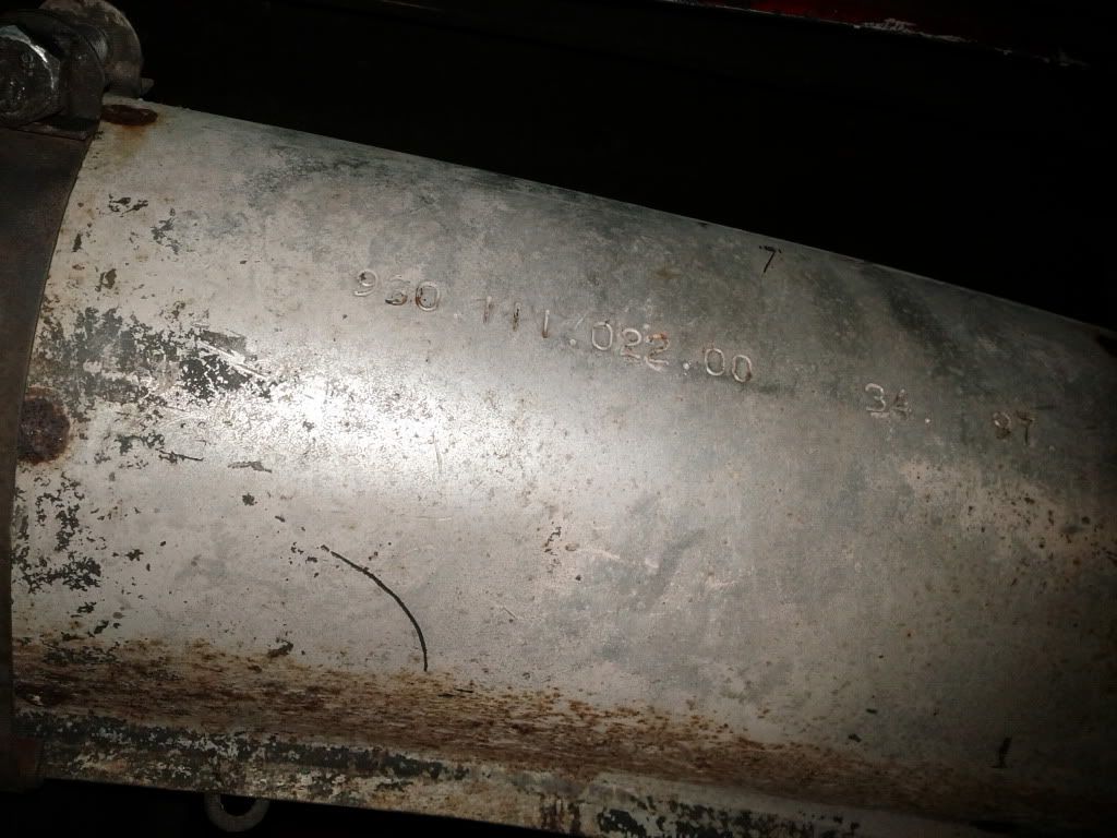

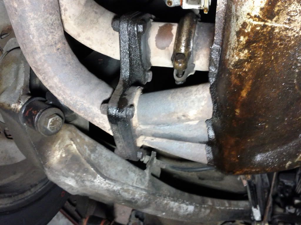

I just checked the price on the SSIs... over $1k, so no, I wouldn't want to spend that much. I've gotta be able to find some cheap pre-75 ones, right?
Btw, here's what I have right now. Is this stock for a 76?
Old 04-19-2011, 02:34 AM
Join Date: Apr 2011
Location: Seattle, WA, USA
Posts: 70
Searching by the part number on the muffler shows that it's stock for 75-76 cars.
