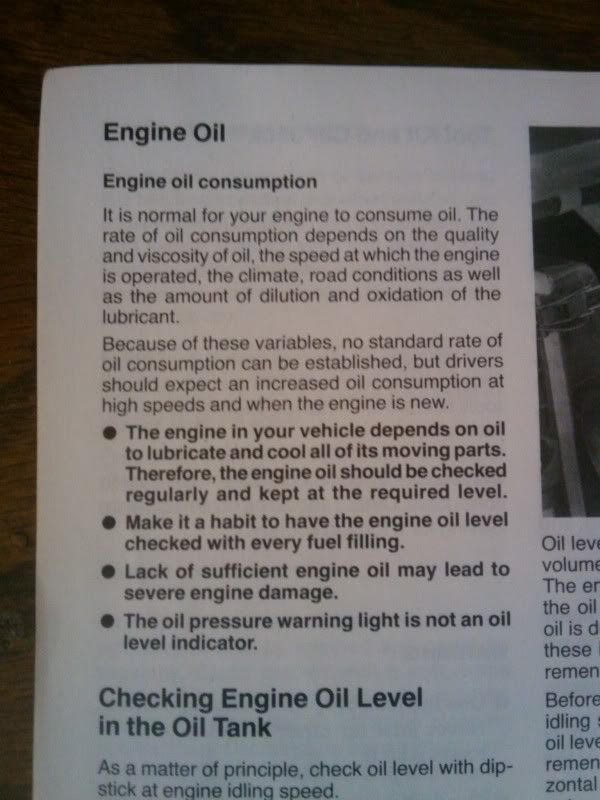

Originally Posted by craigyirush View Post
The owner's manual for my '86 Targa says 1 litre per 1,000 kilometers!
Please disregard my 1qt/1000miles, IT IS NOT IN THE PAG MANUAL or any manual for that matter. My sincere apologies, I must have read it from another Pelican. My fault for not verifying.
Here is what my 85 PAG Manual states:
So oil consumption depends on how your baby is used.
'85 Carrera Targa
PCA/POC
