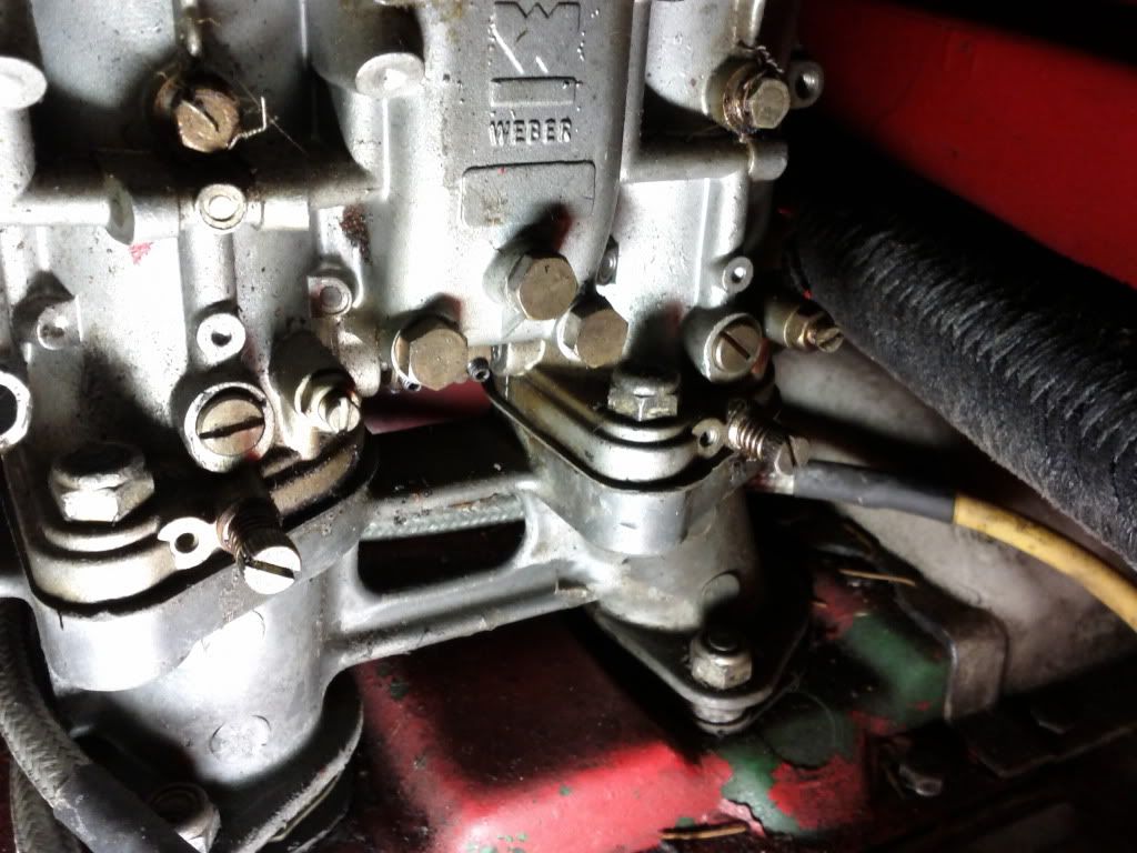

Remove the #6 sparkplug and make sure it isn’t fowled.
Replace if necessary.
Carefully inspect the plug connector for damage (crack, arcing) particularly at the sparkplug connection.
Is the sparkplug insulator very dirty?
Re-test for running on that cylinder.
Remove the idle jet holder (red arrow) and inspect for something in the jet.
Remove the jet from the holder and look through it for something.
Blow it out.
Reinstall jet and holder.
See if the engine fires on this cylinder.
If not, screw in the idle mixture screw (green arrow) until it stops counting the number of ¼ turns.
Remove the idle mixture screw.
Slightly loosen the lock-nut on the air bypass screw (violet arrow) but retain the nut position and orientation of the screwdriver slot.
Remove the air bypass screw retaining the nut in position.
Remove the idle jet holder (red arrow) again.
Use a bit of aerosol carb cleaner in each of these ports.
Not too much so it floods down in the cylinder.
Use compressed air in each of these ports.
Do NOT blow compressed air in the vent in the float bowel.
Reinstall all of the parts in the original orientation.
Try screwing the idle mixture screw all the way in and back it out slowly seeing if the cylinder starts firing.
If still not running, do a cranking compression test and cylinder leak test on all the cylinders.
It is necessary to measure all the cylinders for comparison purposes.
Save these measurements as a baseline for future trouble-shooting.

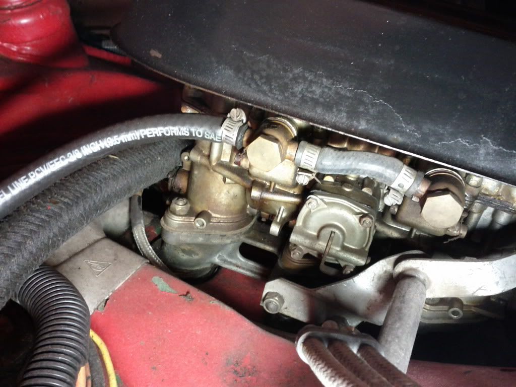

todor,
If you can’t find a fuel filter, you need to install one.
If there hasn’t been a fuel filter, the problem most likely is contamination of the carburetors with fuel system debris.
You may not have been able to clear the debris when you blew-out the jets and passages above.
Assuming you find continuity to #6 sparkplug, I would recommend cleaning the carburetors.
Our host sells a ‘kit’ of parts.
Make sure the kit has the (6) carb-base gaskets (green arrow).
You seem to have the proper phenolic insulating spacers between the intake manifolds and heads.
You need (12) new gaskets there (teal arrows).
Inspect the insulating spacers for cracks.
I see ‘NAPA’ (9.5 mm, red circle ) fuel hose needing replacement.
When you install the filter and clean the carbs, use the Factory original 7 mm hose (available from out host) and the Norma-Schellen (N-S) type hose clamps.
The N-S type clamps don’t damage the hose like the ‘screw-type’ (violet arrows).
The piece of hose between the fittings (green lines) should be straight and ‘relaxed’ (not too long or too short).
The two fittings (banjos) should be 'in-line'.
Reposition the breather hose so it doesn’t interfere with the end of the carburetor shaft (BIG red arrow)!
(The breather hose may be a bit too short, causing this.)
It is worth buying a large enough container of carb cleaner to totally immerse each carb body.
(Share with other Pelicans.)
With a good fuel filter, you should not have this issue for another decade.
When apart, you will be able to assess how much debris has come from the fuel tank.
This is a good occasion to drain and clean the fuel tank.
You have the late (CIS) fuel tank with the filter screen accessible from the bottom.
